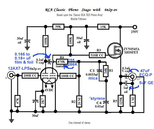

How about a hybrid? The tweaked RCA setup I'm associated with deals with the downstream drive and bass extension weaknesses of the original. Some carts. and SUTs interact adversely with the high Miller capacitance of the 12AX7/ECC83 and a different 1st gain block type is the solution to that problem.

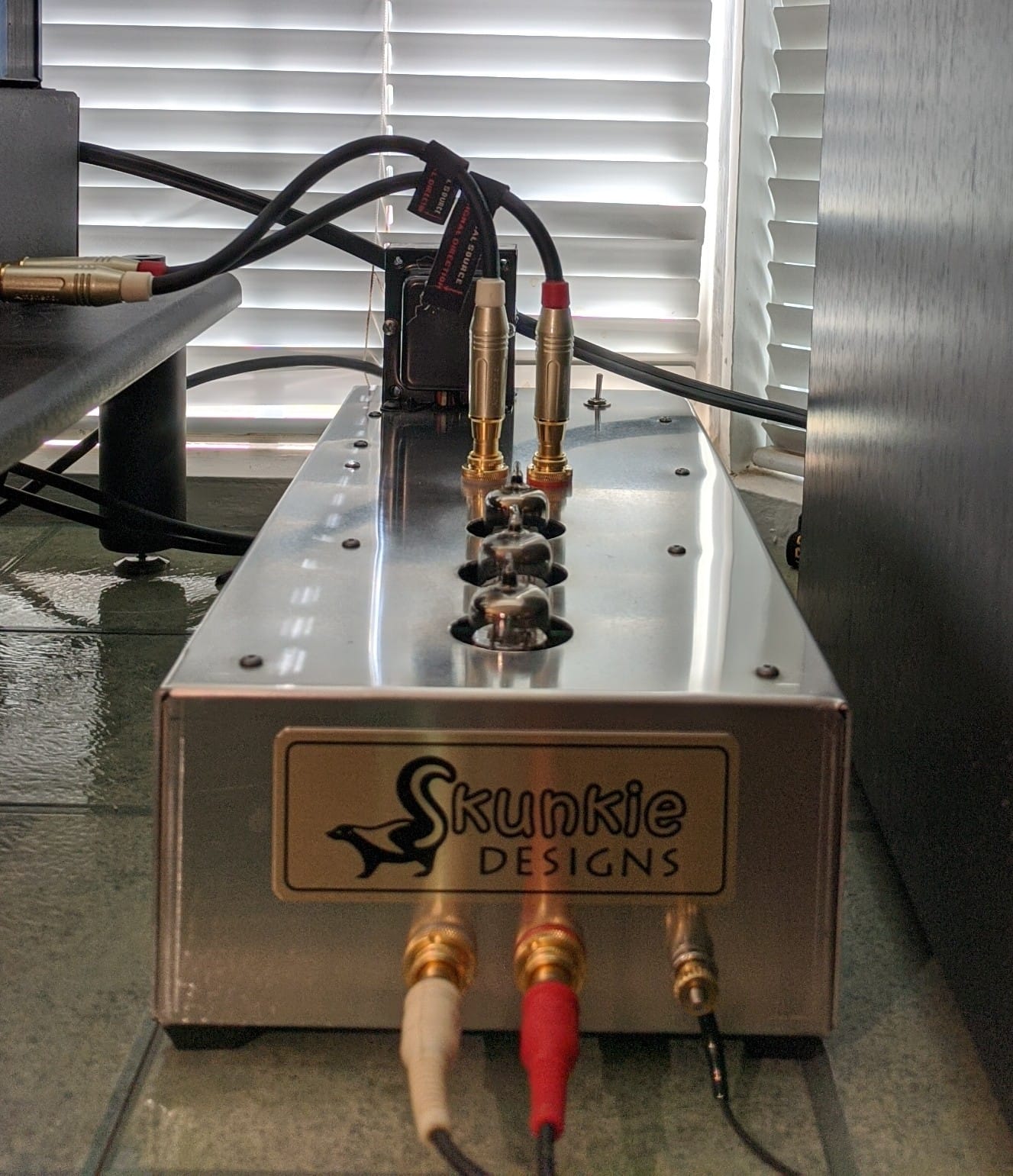

Those EAR834 clones are hard to beat. I built one from one of those $50 board kits off ebay, used a hammond PT and choke, and it sounds REALLY good. Especially the bass is so fluid. I've compared it to $700+ SS phono stages and it holds it own quite well.

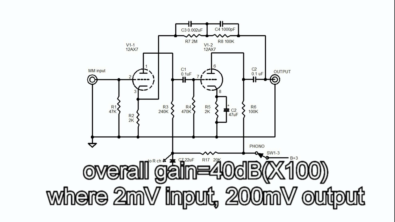

I'm starting a youtube series about building a V2, focused on using higher end passives and redoing the layout to try to get rid of a tine bit of hum it has.
All tube Phono Stage, Moving Magnet Pre-amp - YouTube
Adding a feedback or a bootstrap in the first stage helps a lot and it was the norm back in the 70's

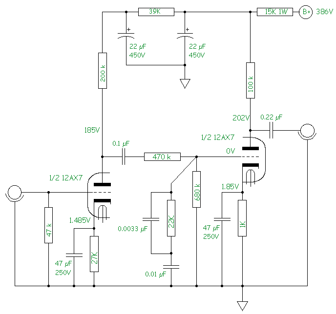

The first two are dead-loss designs, hardly ideal but certainly good enough for phono, with its inherent limitations. The third is a more classic variation on this possibly most interesting audio design issue, the 12AX7 two stage phono equalizer. The feedback network is way, way wrong for RIAA and the midband gain is 34dB instead of the stated 40dB, and there's DC on the output terminals, but.
The Holy Grail Quest that makes the 12AX7 phono equalizer forever interesting is that it's tantalizingly just out of reach. Adding a third stage, a follower at the end, resolves all problems and gives great design latitude, but that would be cheating.
My personal favorite is a first stage with battery bias, cathode to ground, and a second stage of anode follower with RIAA in the feedback.
But today, for a new design, why limit ourselves? Beautiful little Russian pentodes like the 6Zh9Pi and 6Zh11Pi are still around. Even Mullard E180F, American and Japanese 6JC6, etc. are cheap enough to sort for 1/f noise and live happily ever after.

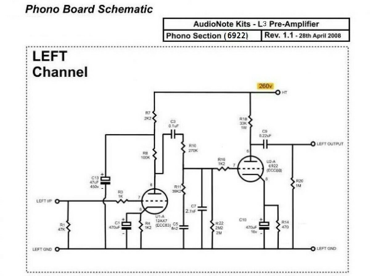

BTW, here is the schematic of the unit I build as supplied by the kit vendor. Looks like they cheated :p
Also, I ended up using 7025 tubes as regular 12AX7 tubes were too noisy in this application. The new production EH sounded good, but I ended up with a mix of NOS: 2 RCA, with a Motorola in the first position.

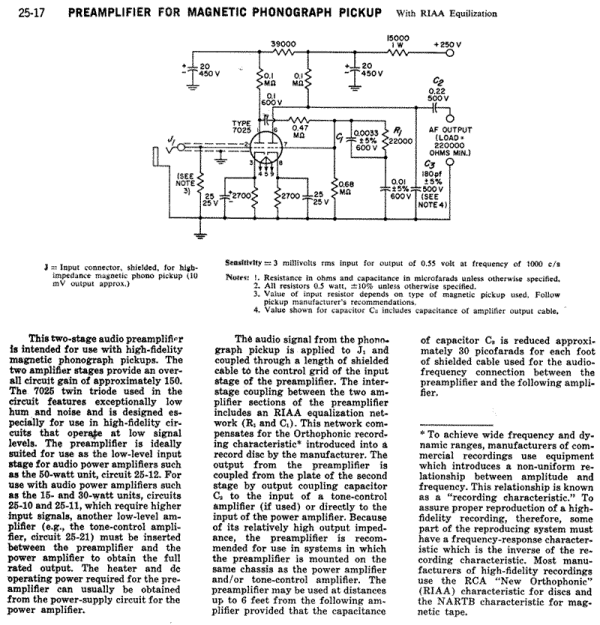

Back at the end of the 1940s, when RCA worked up the "classic" passive EQ setup, the SS stuff we take for granted that makes DC heating easy was not available. RCA called for 7025s, as the struggle with AC heating was the only practical option available.

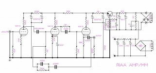

How about this design? You can find it here:
A MM PHONO vacuum tube preamplifier DIY - Davide Bucci
It is well documented and simulated.
May I ask a sincere question about that design?
Why is the plate load on ECC83 T3 (T3A and T3B) only 22k ohms? That's less than half the rp of an ECC83. What is that supposed to do?
There are things that look good in simulation but work terribly in real life, with real devices that have more complex limitations than those in the models. I fear that might be at work here. I don't see how a 12AX7/ECC83 could work well as a clean amplifying stage with a 22k ohm plate load. But hey, the author may know something I don't. Either I'll learn something or I'll have exposed a flaw in the design. So... Which is it?

I have to confess that I only had a quick look at the design and then saved the web address for a later visit.
So you may have a point here. I will take a closer look though..... :eek:
The voltage gain of that second stage is around 33 dB (I think).
