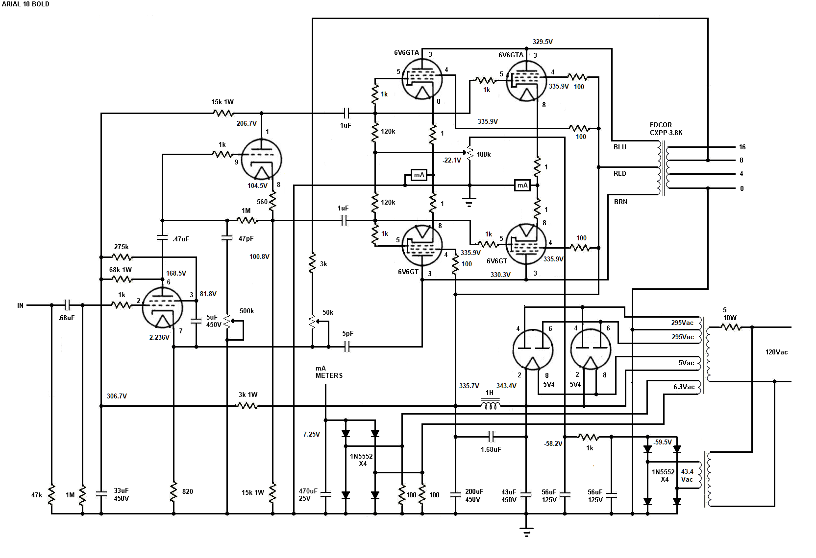

So it looks like I need a cap larger than 33uF for the driver and phase splitter stages.
20Hz signal fed to the amp at near full output 10X probe 20mV/DIV That would be just a little above 400mVPP. I'll find a 450V cap and put it in parallel with the 33uF cap.
Adding another 33uF 450V cap in parallel the signal dropped to about 300mVPP.
Now am I chasing my tail here or does the signal across the filter cap mean the output will be a little lower at 20Hz?

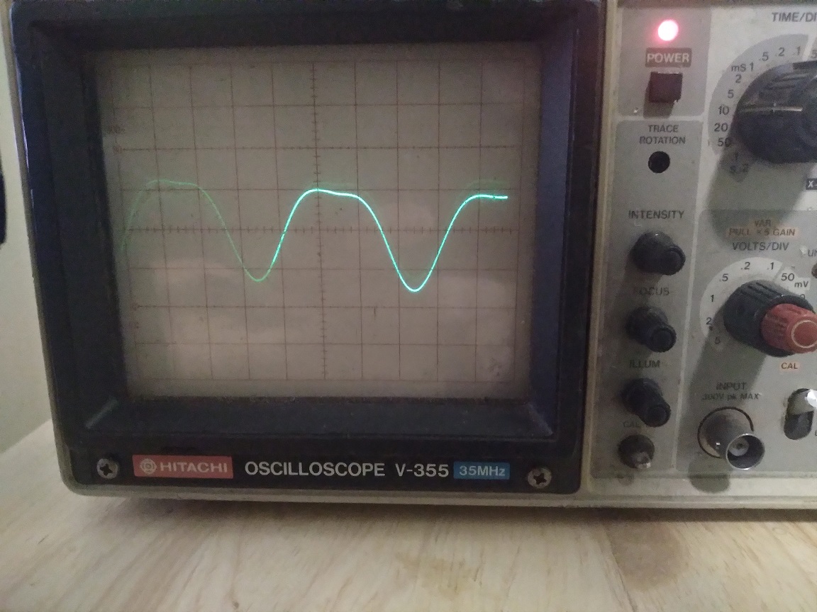

Also at full output into 4 ohms the sinewave doesn't start to show transformer saturation until I get down to 15Hz and the amp seems to be flat to 20Hz.

Here's the schematic with the voltages listed. Line voltage kept at 120Vac for all measurements.
There is no ‘signal across the filter cap’. The signal is at the plate, on the other side of the plate resistor from the filter cap, which in fact is not a filter cap but an AC ground for the plate resistor. It’s big enough already.does the signal across the filter cap mean the output will be a little lower at 20Hz?
There is a sinewave of about 200mVPP at 20Hz across the 66uF filter cap. I didn't update the value on the schematic though.
If you connect a dummy load to the speaker output, connect your oscilloscope, then short the input (to ground), do you see 120Hz hum?
If the problem you see is that a 20Hz sine wave doesn't look perfectly clean, that could very well be because of limitations of the output transformer.
Looks very clean like a regular sinewave. Doesn't start looking weird until 15Hz and that's at full undistorted amplifier output into 4 ohms. I suppose the feedback helps with that.

At 20Hz at an output of 25 watts, the sinewave is still clean.

What I was questioning is if a 200 mVpp signal across a 66uF filter cap would cause any issues.

Yes it's the spot where the 33uF cap is after the 3k resistor. I just didn't update that cap value on the schematic.
With the input shorted, if you look at the output (after the output blocking cap) of the 6U8A pentode (or the grid of the 6U8A triode), do you see any hum/ripple there?
3k ohms and 66uF should make a plenty long enough time constant.

It's impossible to tell until it does. But because there is a clear ripple on the supply cap, and that filter cap is common to both stages, it could be a source of phase shifted FB back to the VA stage. You still don't have the two stages decoupled, they are sharing a common cap, not seperated by another interstage resistor/cap pair ahead of the splitter load resistor.What I was questioning is if a 200 mVpp signal across a 66uF filter cap would cause any issues.
