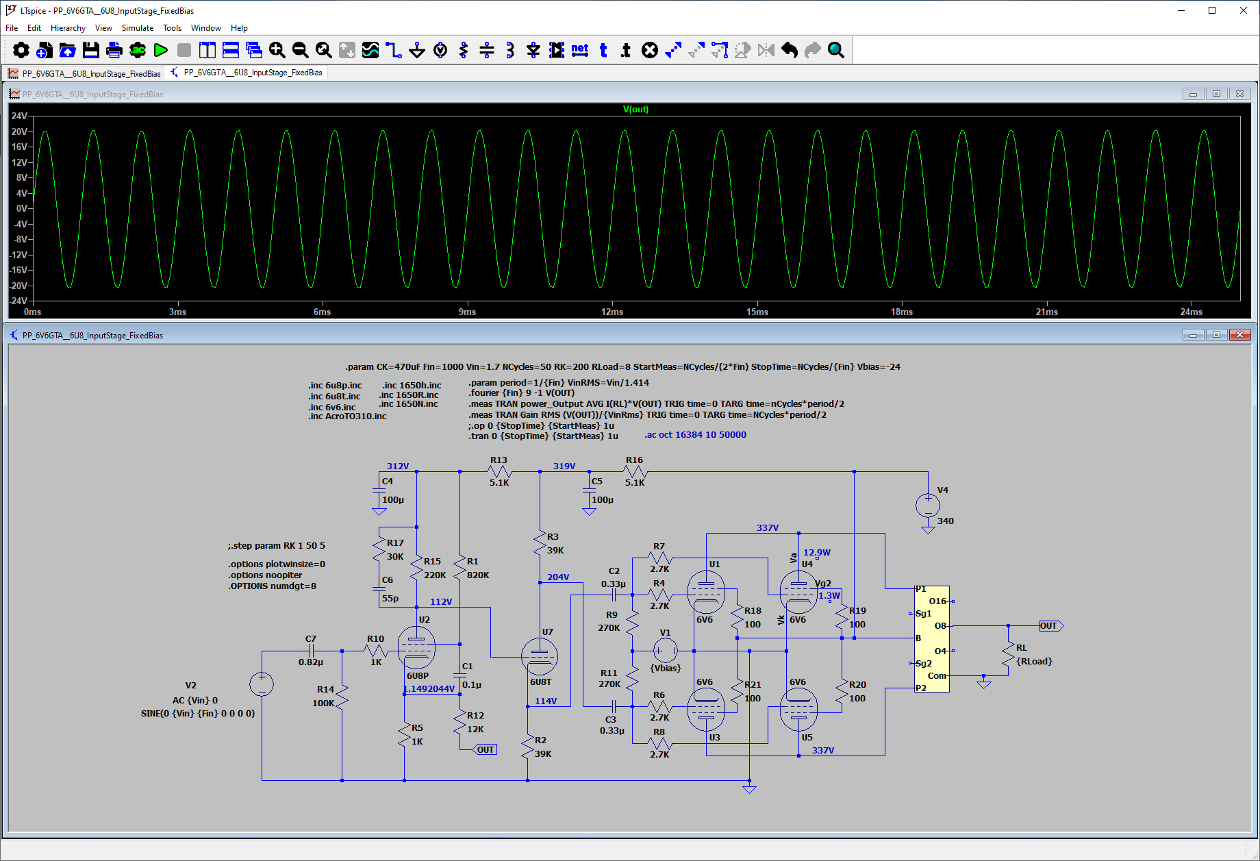

Now since I do not have a 100uF 450V cap I might try the version without the interstage coupling cap and see what I get, but I'll make it to where I can easily add the cap and resistor later.
Digging into my simulation collection I found something similar, a 6U8 driving 4 EL84s. I replaced the output tube4s with 6V6s, adjusted the bias, this is what it looks like (usual caveats about simulations):

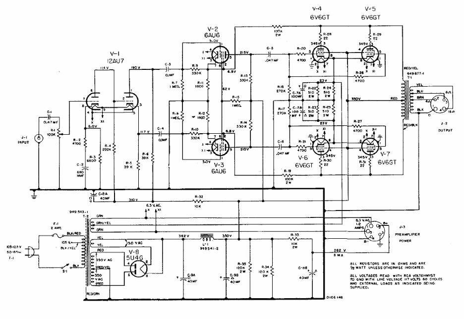

The RCA RC-20 amplifier design uses a 12AU7 cathodyne to drive a pair of 6AU6 pentodes in a differential pair driving a quad of 6V6s, with NFB taken from the plates of the 6V6s to the cathodes of the 6AU6 diff pair.
That is a more complicated amplifier than what you have. Would require two more tube sockets too.

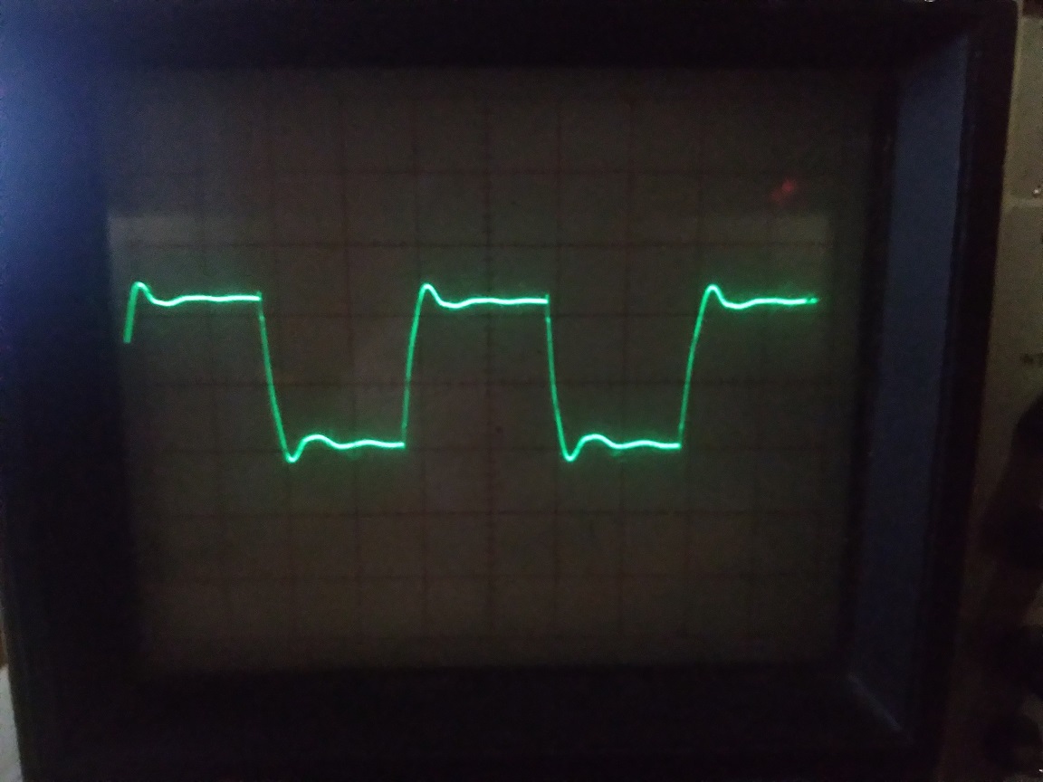

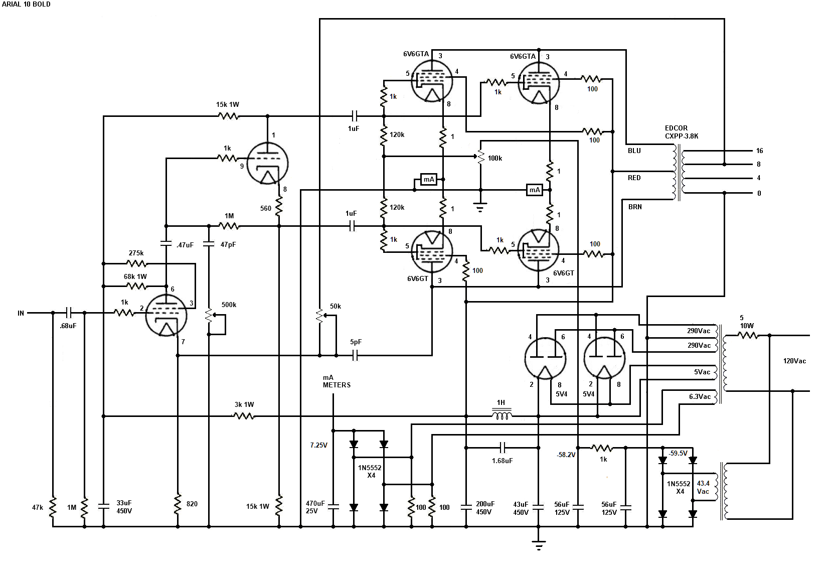

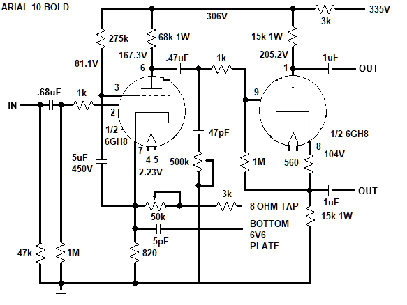

Got some very good news.

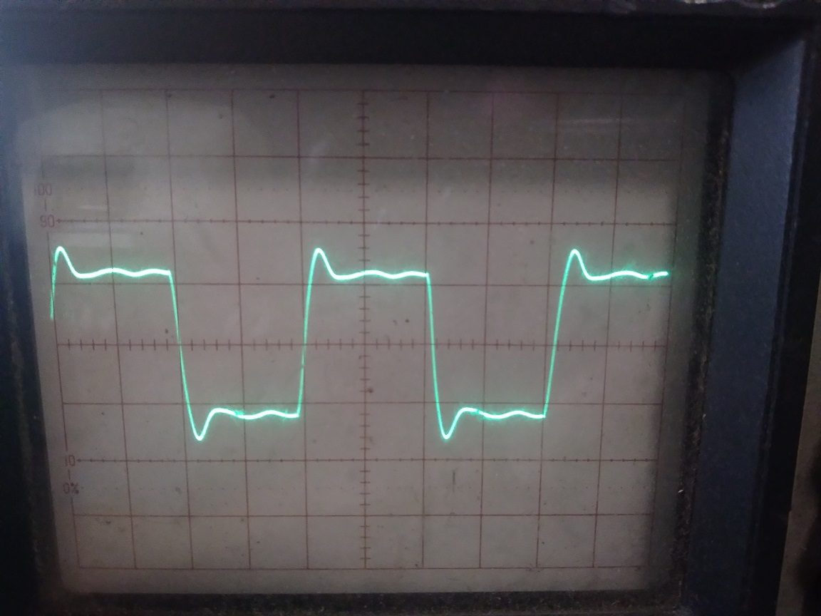

I built this circuit.
And got this very pretty 10kHz square wave.
I needed very little compensation only requiring 5pF from the lower 6V6 grid to the feedback connection and 47pF in series with a 500k pot to ground from the junction of the .47uF cap and 1K resistor.
The 500k pot was tweaked until the amp was flat to 20kHz.
I had a slightly better square wave with just the initial overshoot only, but that was without the 47pf cap and just a clip lead connected there which I knew wouldn't work unless I kept the amp on its side and never moved the lead. Perhaps I needed slightly more than 5pF of capacitance. If not for the cap being connected to a plate I'd connect a 1.5-20pF variable cap there and tweak it.
The 3k resistor in series with the 50k gain control came about as I needed to span the 2" distance between the gain control and pin 7 of the 6GH8. I found that 3k is the minimum resistance I can use and the amp stay stable on the 4 8 and 16 ohm taps. That way I cannot make the amp go unstable by adjusting the gain pot to 0 ohms.
The amp is finished for now until I can find the Acrosound transformer at which point I'll install it and re-compensate, however the squarewave looks so good that I might want to leave well enough alone and just enjoy the amp.
Also with no signal being fed to the amp it is dead quiet.
A big thanks to all who have helped with this amp. Without y'all I wouldn't have gotten it right.

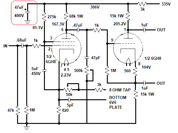

Hopefully that circuit works out to be a keeper.
Just one thing... It may have been a drawing mistake only, but you want to make sure you have a decoupling capacitor from the 3k ohm decoupling resistor to ground. It's circled in red below:
47uF would be the minimum value. 100uF would be a little better, but might not make a huge difference.
400V would be the minimum DC rating for that capacitor. 450V would be better (safer).
So far so good. Playing some jazz and the amp sounds good. I'm thinking it sounds slightly better in the upper treble as well.
The only other thing I really need to do is get a matched quad of 6V6 tubes. I'll then move one 120k grid resistor to one of the bias pots as I will no longer need one pair of 6V6 tubes at a different bias point.
That might help the amp even more.
What I might do this weekend is do a 10kHz squarewave test using 8 and 16 ohm non-inductive loads and I'll also do a test with a 20kHz sinewave to see if the amp is still flat to 20kHz.
I'd love to do a gain chart of 20-20kHz, however that would require two RMS voltmeters that are good to 20kHz which I don't have.
The way I do that is I do 20Hz to 100Hz in 10Hz steps, 200Hz to 1kHz in 200Hz steps then 2kHz to 20kHz in 2kHz steps.
I record the input voltage and output voltage at each step and then calculate the gain.

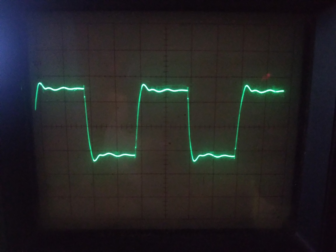

Decided to do a test with the 10kHz square wave at 4 8 and 16 ohm loads. Signal measured across the load. Here's the results.
16 ohm load.
8 ohm load.
4 ohm load.

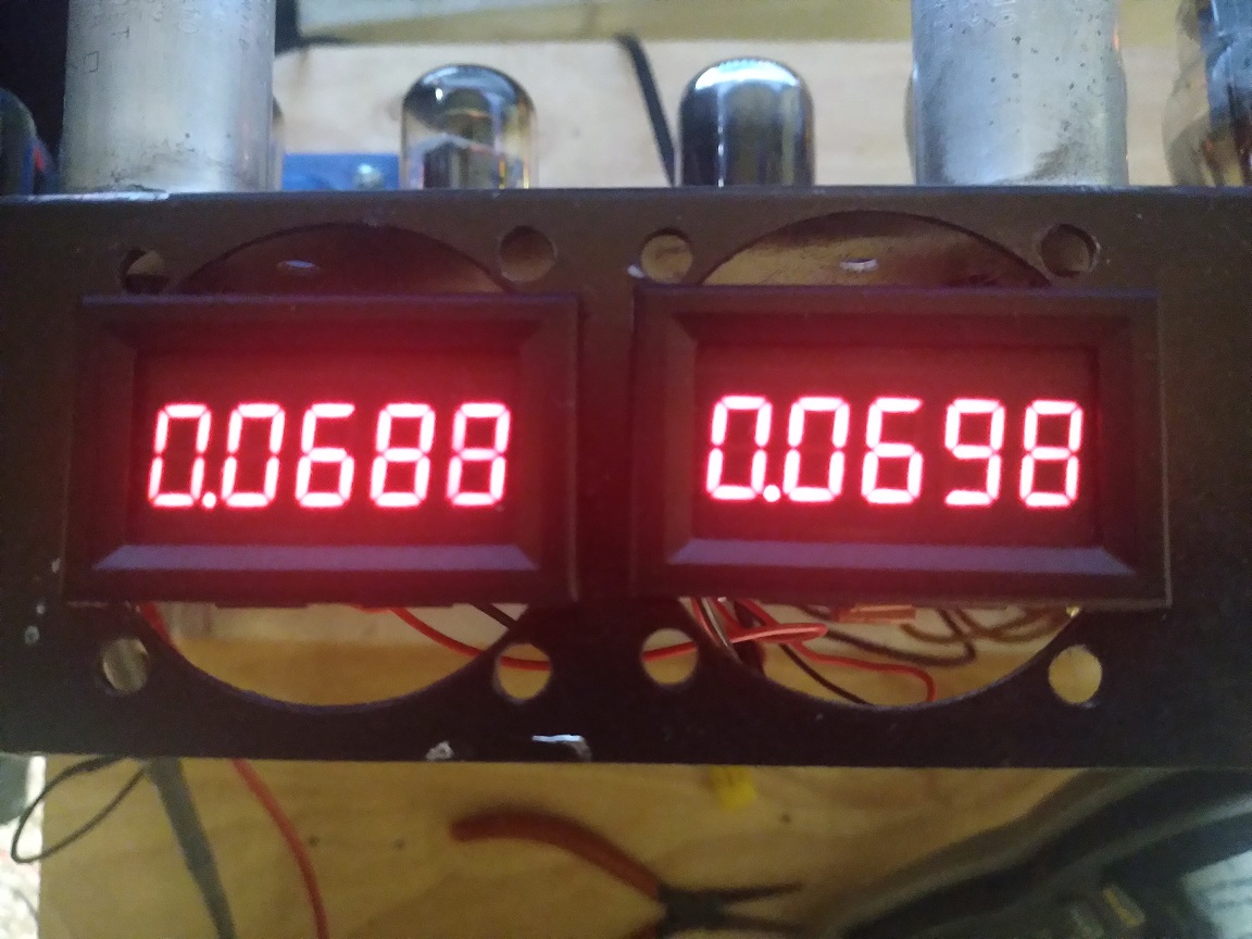

I also moved the bias connection of the other pair of 6V6 so that I now have a single bias adjust pot. That required swapping 6V6 tubes around until I got the cathode currents as equal as possible within reason.
16 ohm load.
8 ohm load.
4 ohm load.
