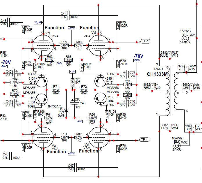

I came across an interesting implementation. The Traynor YBA-200 bass amp uses a PNP transistor that acts as a switch to vary the fixed bias voltage according to the cathode voltage. As the cathode voltage rises above ~4V, the PNP starts to turn off, dropping the fixed bias more negative.
