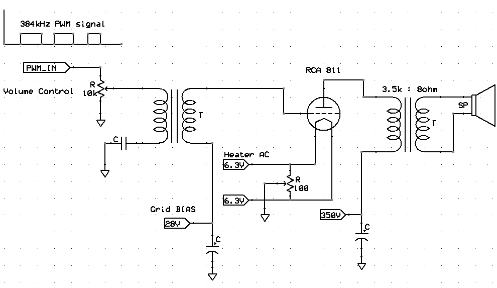

Tube Output Full digital Amplifier
I think it is possible to conbine good old Tubes and today's full digital technologies.
maybe I'm so tired with heavy working right before holiday??
(everyone says before holiday! before holiday! how about you?)
Unless you've got a tube that can switch at 600khz or more, then I don't think there's much point.

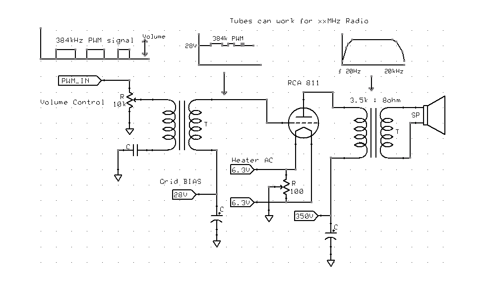

Re: Re: Tube Output Full digital Amplifier
That is easy..
Tubes are used for Transmitter for AM/FM/Ham or GHz Radars.
Don't you remember old TVs had many tubes inside?
They were working for TV frequency.
Anyway just a tired businessman's daydream😉
panomaniac said:
Ah Ha! Here it is:
Tubes in Class-D
Almost exactly a year ago. A fun idea, tho not very practical. You might want to read thru it. It's worth a try, if for nothing more than the fun factor.
Oh I did not search because I posted as reply on "Forum for issues related to the design of Class D amplifiers" then moved by moderator to new thread.
Nothing more than the fun, but maybe sound will have Tube fravor 🙂
