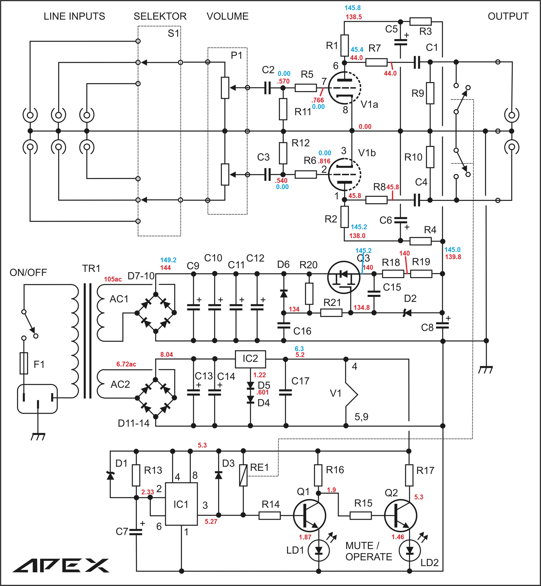

Circuit as drawn shows 9V a.c.
What is your dc voltage across C14 when supplied with 6.3V a.c. When loaded, and unloaded. Maybe will need a low drop out regulator with this a.c. voltage?
I am attaching a schematic with measured voltages. Voltages in red are with the tube installed. Voltages in blue are with it pulled.
I am using this transformer using the 100Vac secondary. It has two high voltage windings 100V and 120V. The data sheet only shows the 120V.

Let me know what you think.

With a dropout voltage of an expected ~2.5V across the regulator, it's going to droop.
With that ac supply I would try a low dropout 5V regulator, and hope for a more reasonable ~1V to 1.5V dropout loss over the series component of the regulator.
Maybe
LM2940CT-5.0
LM1084 5.0V version (I've never used this regulator)

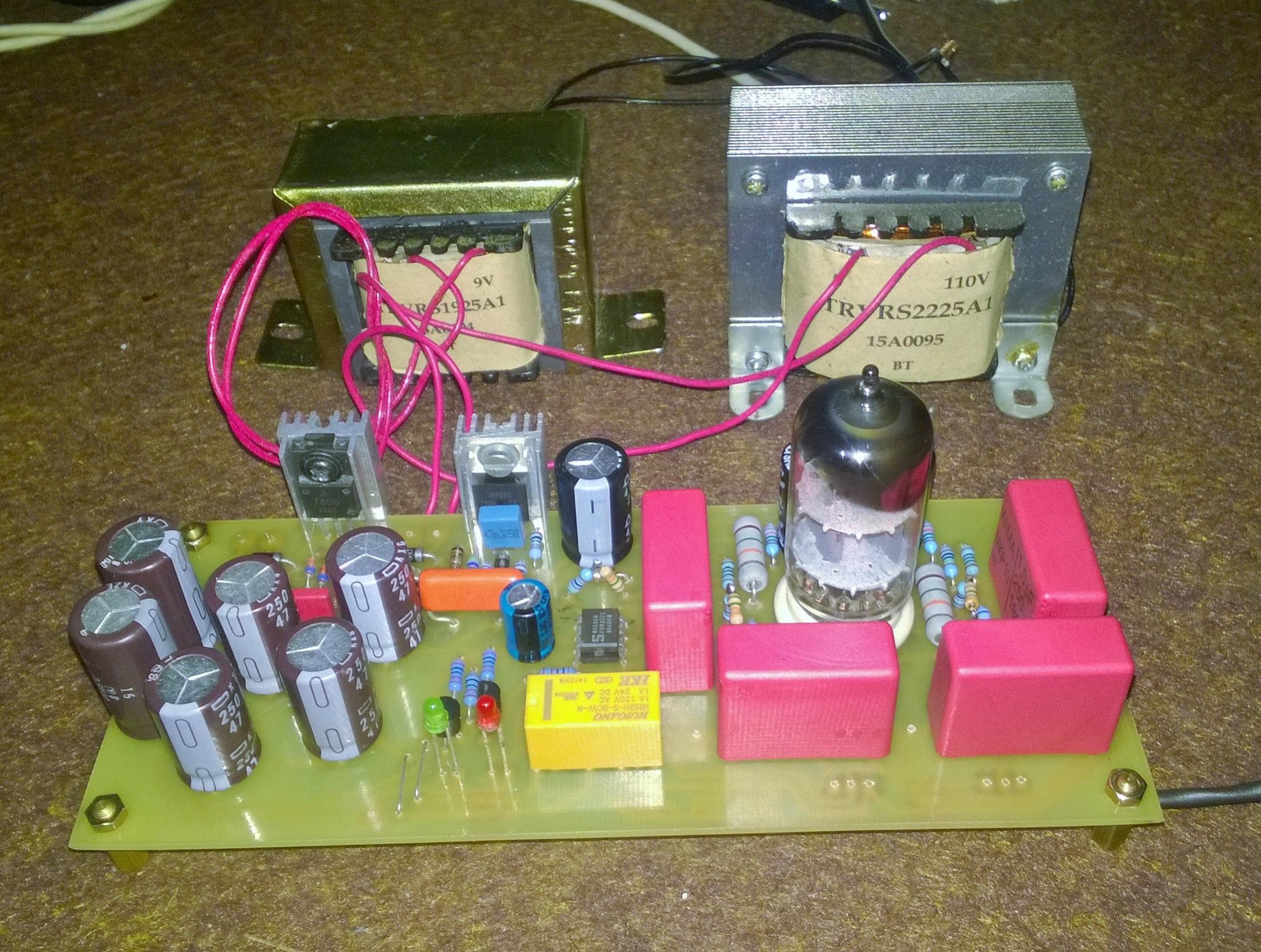

Ok, I'm getting closer. I changed the regulator to an L7806. Now I have almost 6V at the heater which seems to be enough. It is working but the mute circuit takes almost 5 minutes to switch on. I don't quite understand how that circuit works. Can one of you explain it. It seems maybe it is too sensitive or not sensitive enough.

Update;
I looked up how the NE555 works and see that the trigger works by charging up C7. I watched and C7 was charging very slowly. So I reduced C7 first to 22uF and then 10uF. With 10uF there it takes about 30 seconds for the circuit to switch on. Next I paralleled and other 3M9 resistor onto R13 and that dropped the switch on time to about 15 seconds. That is acceptable. The preamp now works well with the ECC88 tube. I wanted to try the 6N1P. The first thing I noticed is the heater voltage drops more than a 1/2v. The L7806 heatsink temp rose to 65C which is not so good. Anode voltage on the tube went from 45v on the ECC88 to 90V on the 6N1P. The sound is good with both tubes. With the 6N1P tube, it take a full minute to reach 0V offset. I'm thinking that is because the heater voltage is not high enough. I am still considering cutting the traces to the heater nodes and running that direct from the transformer 6.3v secondaries. This transformer has two 6.3v windings so I have an extra to spare. That should reduce the heat on the L7806 as well.

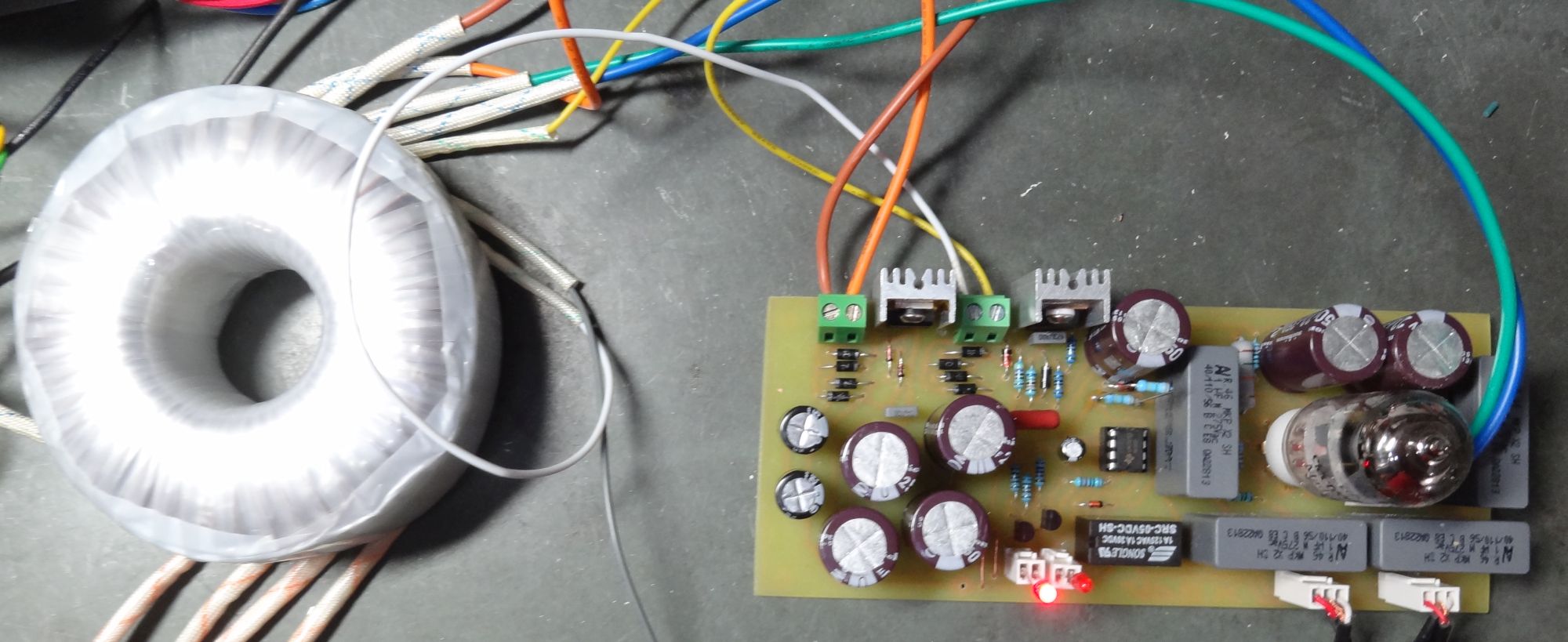

Hi Guys,
I cut the traces to the heater pins on the tube and added a jack so I could feed 6.3vac directly to the tube. Now the L7806 runs cool and the tube heats up more quickly. Further testing with the 6N1P shows that it doesn't settle to 0V offset. It stays at about 20mV. That is too much for a preamp so I can't recommend this tube. The ECC88 settles to +-1mv and stays there.

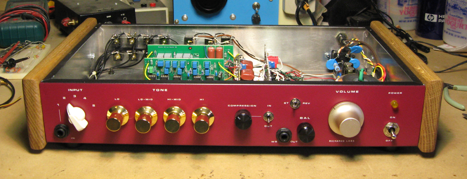

I built an all opamp preamp (OPA2134's) that I'd put up against any preamp out there. It has a four section Baxandall tone control circuit (can't recommend it enough), and optional bi-amp outputs in addition to regular wideband outputs. The 4th order Linkwitz/Riley active crossover is set for 500HZ, for a speaker system I built to go with it. It also has active EQ that pumps up the low end by about 10dB at 32HZ (fast rolloff below that), so the acoustic output of my closed box 8 inch Focal kevlar woofer is close to flat down to 30HZ. If you really know how to use opamps right, and do grounding right, and you have a good tone control circuit, only then would a preamp compete well IMO.
