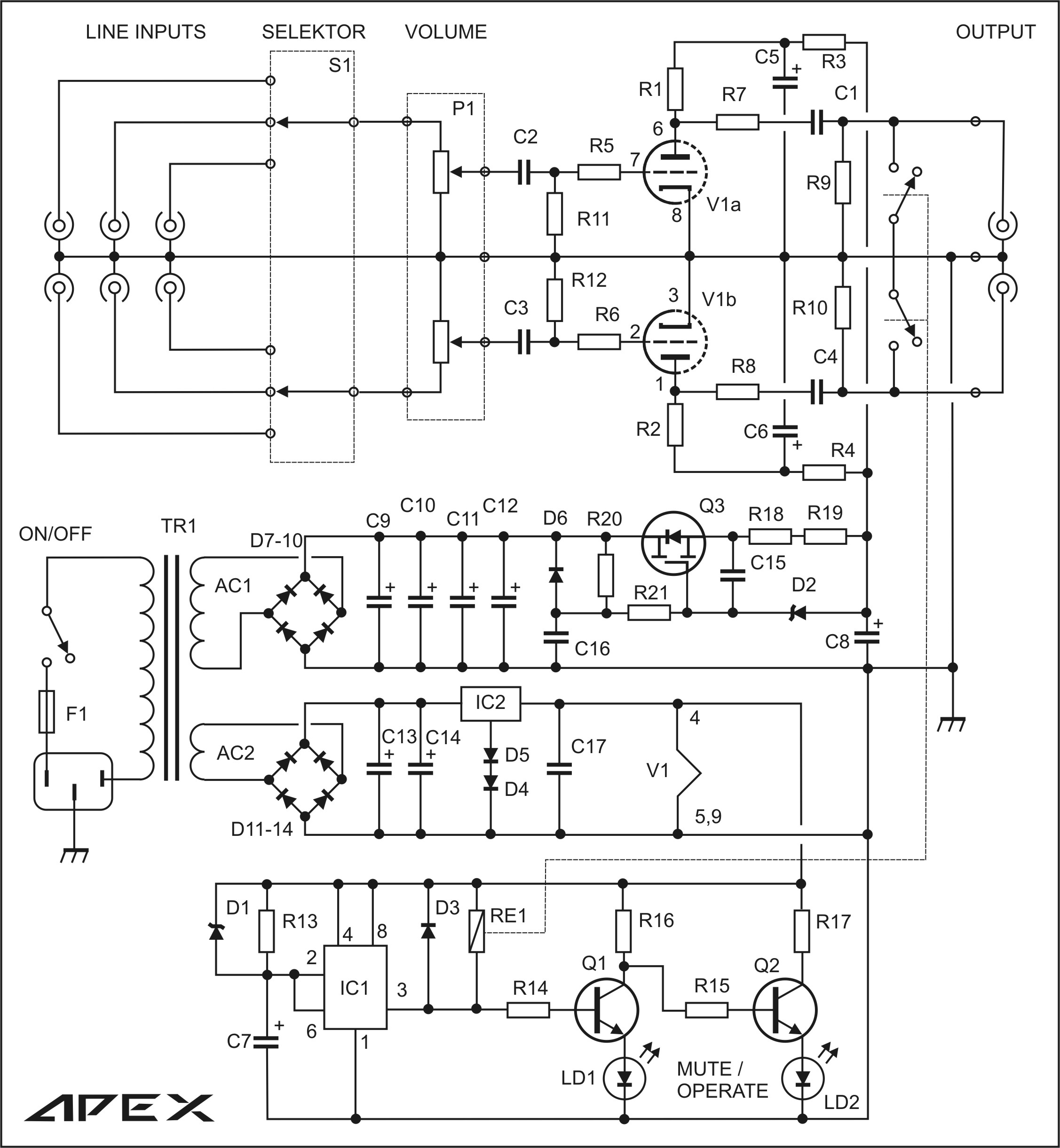

Looks interesting. Has anyone built this?
Edit; Will it work with 120V .2a/6.3V 2A? transformer?

Yes there is many builds of this preamp, sound very good.
Transformer 120V 200mA 6,3V 2A is OK for this preamp.

Hi Mile,
I'm trying to understand the PSU. Looks like the low voltage portion powers IC1 and the tube heater circuit. Doesn't the heater need to be 6.3V and the NE555 needs 12-15V? How can they both work on the same voltage?

NE555 works from 4.5V to 16V supply.
The supply circuit here seems to be about 7.2V dc if using a 6V regulator, or 6.2V dc if using a 5V regulator. (+/- 0.2V or so)
The relay also seems to be a lower voltage type, and not a 12V relay

I have it built but I don't have the NE555 yet. I tried testing the PSU part and I'm getting about 7.4V at the tube heater. It is supposed to be 6.3V. Should I use a 5V regulator?

I changed the low voltage regulator to an L7805. The voltage is now 6.2V but it over heats and shuts down. Seems like it is pulling too much current. Any suggestions?

Are you connecting to a valve heater when the 5V regulator over heats,
Is the regulator in a TO220 package, does it have a heat sink,
What is the a.c. Voltage of the secondary supply that part of the supply ?

Yes, the valve heater is connected to the low voltage circuit. The transformer has dual voltages one is 0-120vac and the other is 6.3-0-6.3vac. The regulator is an L7805. TO-220 with a heatsink attached. I tried just using 6.3vac to feed the regulator, but the heater voltage drops to 5v. Then I tried using 13vac and the L7805 overheats and shuts down. I have thought about disconnecting the heater from the regulator and feeding it directly from the 6.3vac but the circuit is supposed to work as drawn.
