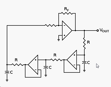

The purpose: a novel sine wave RC oscillator that uses no classical frequency selective networks. As it isn't my idea, I still can't give further details.
The project resembles this, but it is not equal to the showed below. It uses different array of passive elements. Nor it is of the Bubba topology.
Sorry, I still have no permission to give more details, because it is under development and perhaps it will be patented. It has been designed in the Campus of an University in Argentina and I am not the creator. Only a second test of the principle.

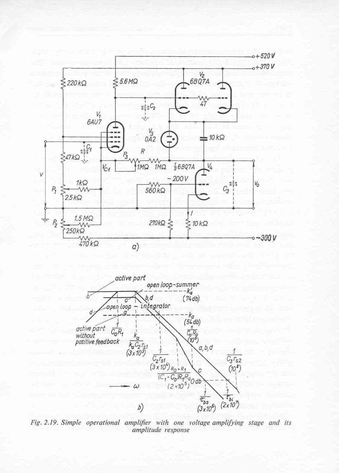

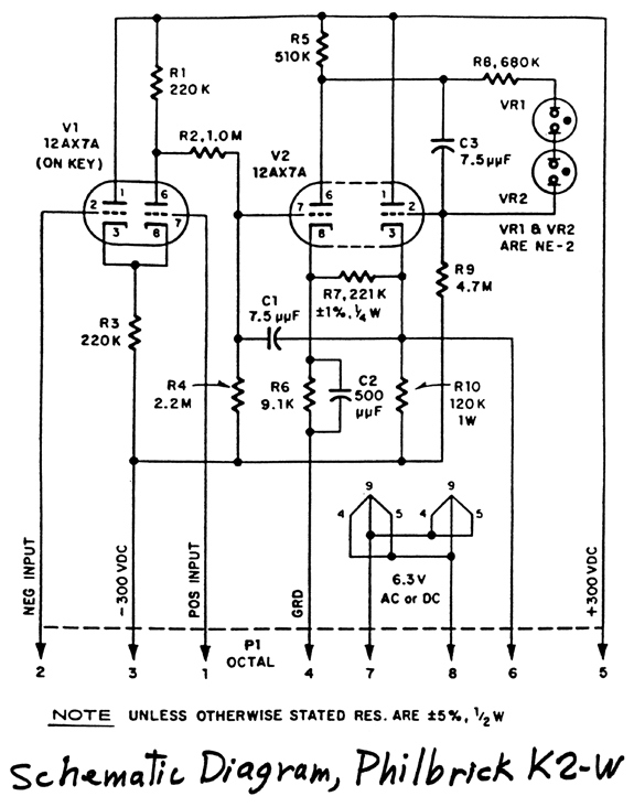

I think there is one on Nelson Pass "passdiy" site. Go to "projects" and hit "amplifiers" then on the Project categories list on the left hand side a number of articles will emerge. About a third of the way down. It is called "DIY op amps"
It is a 2 tube simple opamp. 12 AX7 I think.
Cheers
Jonathan

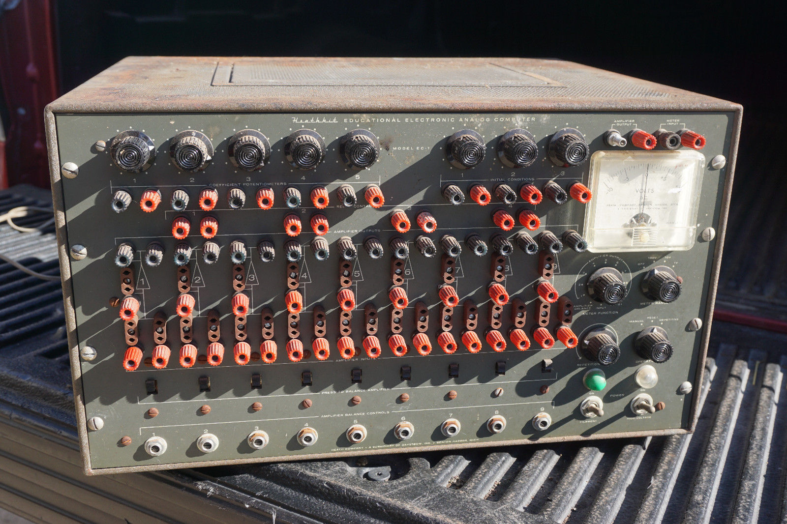

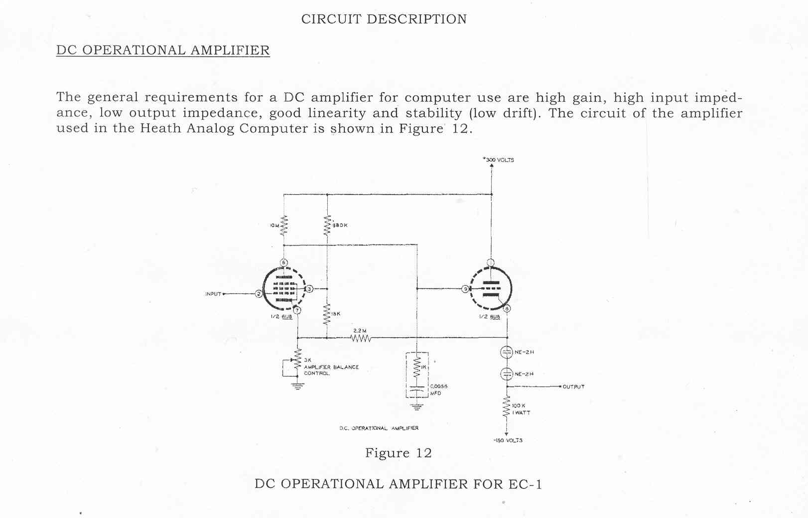

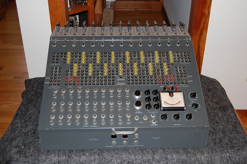

There was the Heathkit EC-1 home analog computer.

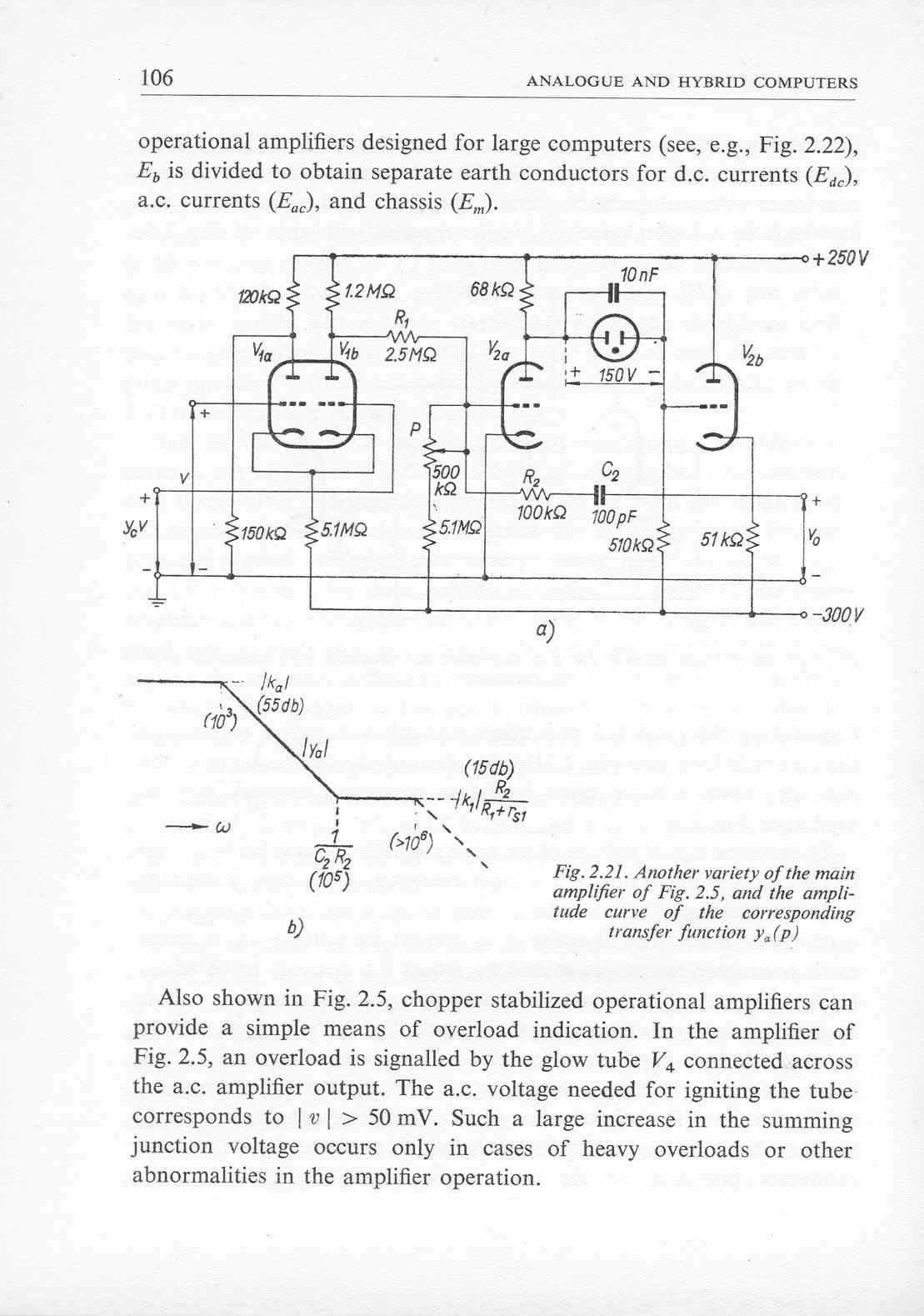

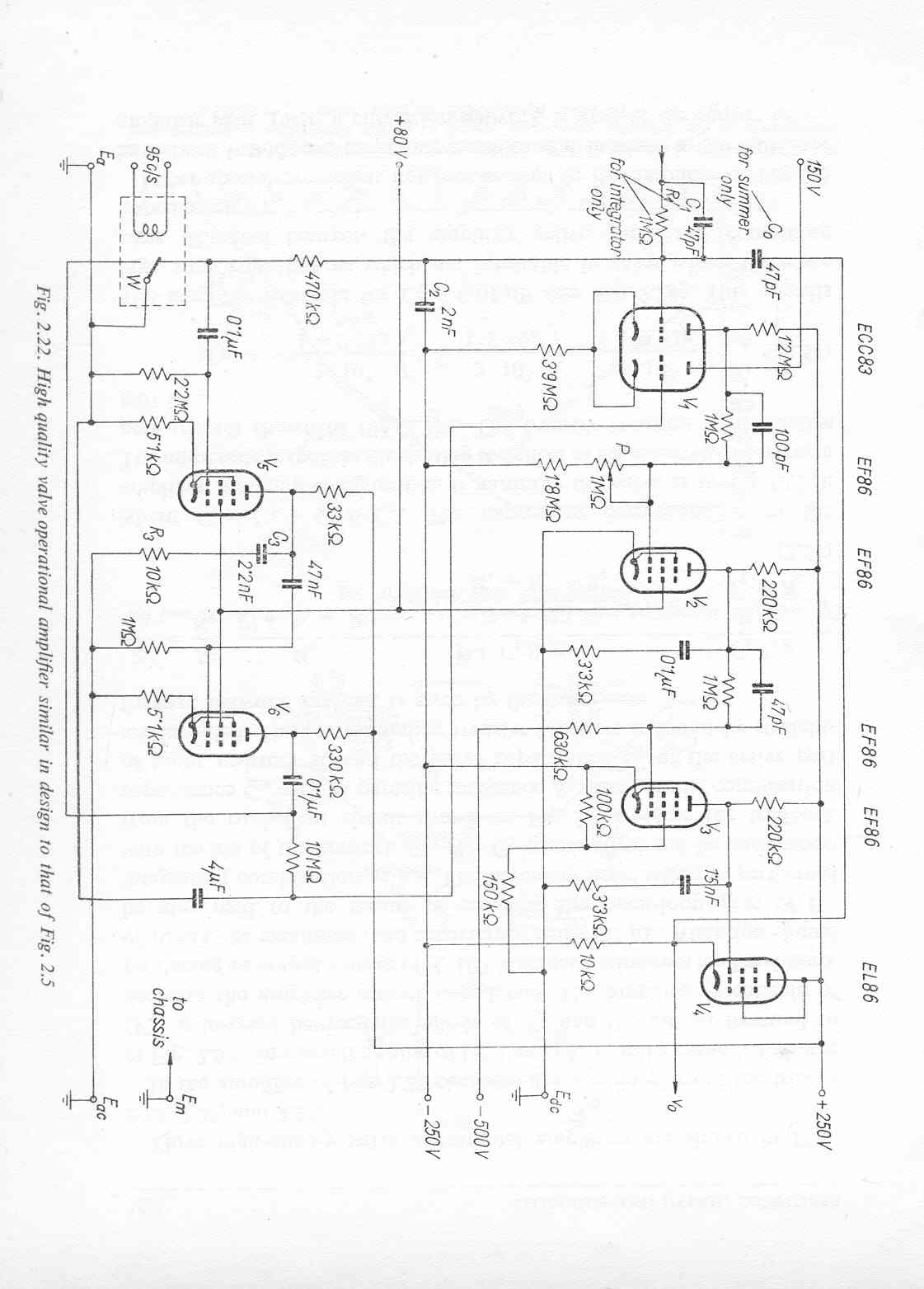

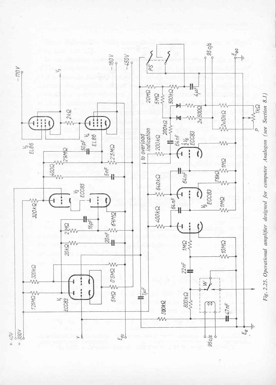

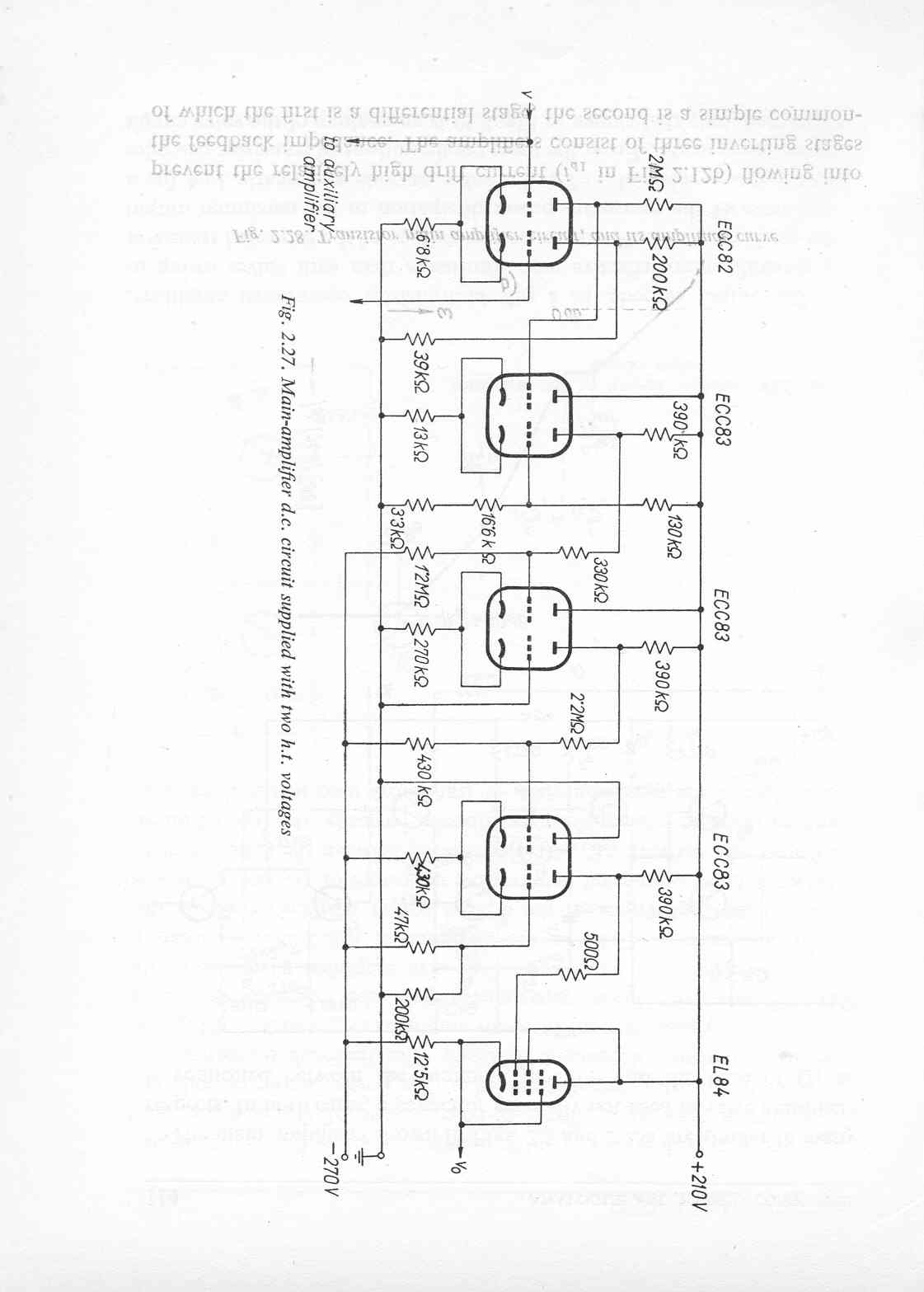

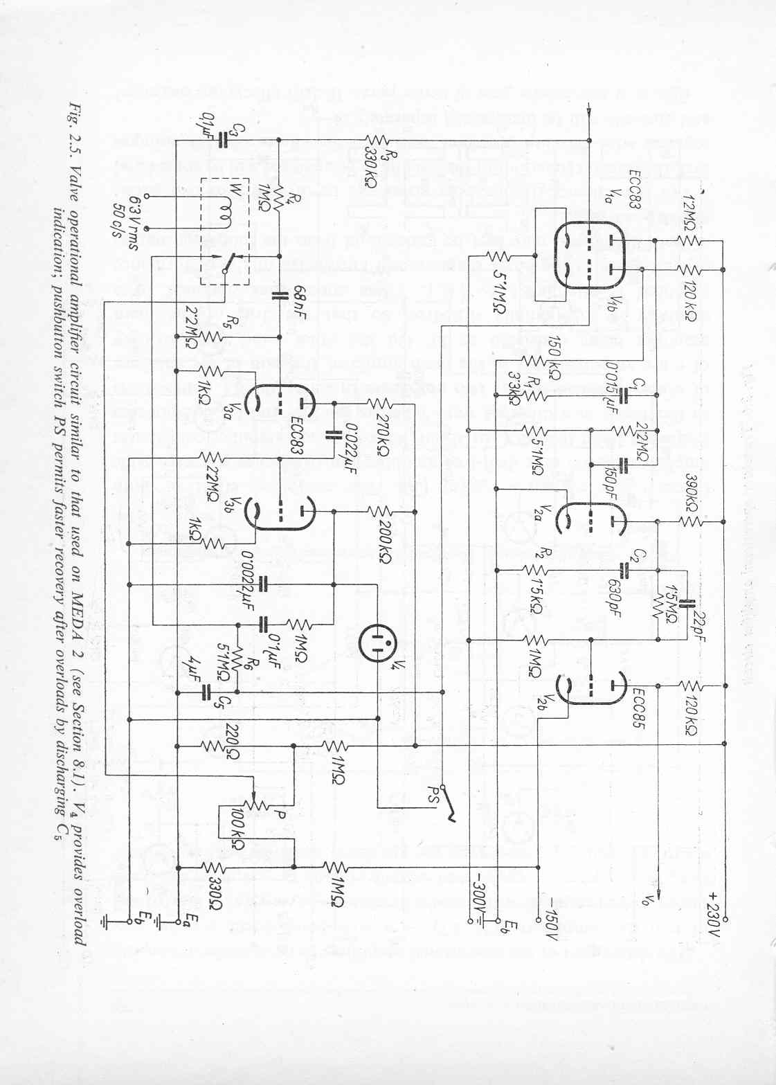

Then some VT Op Amp circuits from the book "Analogue and Hybrid Computers" by Z. Nenadal and B. Mirtes 1962
Heathkit EC-1 manual:
http://www.analogmuseum.org/library/heathkit_ec1_operation_manual.pdf

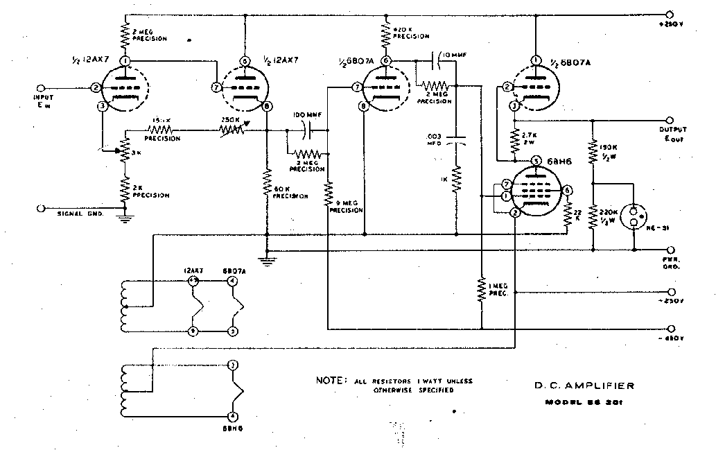

and the VT Op Amp for the H-1:
D. C. Amplifier ES-201 Misc Heathkit Brand, Heath Co.; Bento

The Heathkit ES-201 OP Amplifier schematic (for the H-1 Analog Computer):

I spent many hours on this one solving differential equations. Probably it helped me a lot later to design things with nested feedbacks. ;-)
Interesting apparatus. Call my attention the lighter, did you want to put it on fire? 🙂
Smoking amp: There was an analog computer like the one in the last pic, in the University I coursed my studies. They destroyed completely, because the chief of the cathedra didn't know what the thing was.
