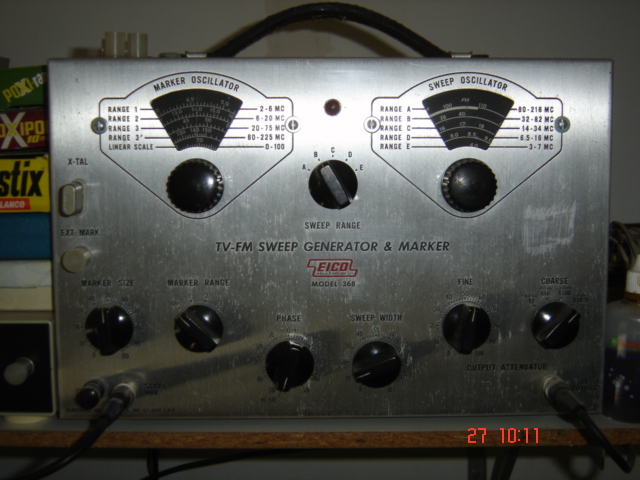

I saved an old EICO 368 minutes before it goes to trash, by the same reason.

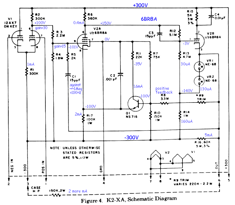

Argh! Philbrick made too darn many variations!
Just found K2-XA, which uses the neons not in the signal path but in a bootstrap for the signal path. Slightly "better" in some ways. Does steal precious output current.
http://www.tayloredge.com/museum/museum/opamp.pdf page 6
Note that despite moving to a new tube for pentode 2nd stage and adding a (gasp!) transistor, gain and bandwidth are only about double the K2-W.
Blue text my mark-up.
Recall that these opamps had a couple Volts input offset error (note V1 plates hundreds of Volts apart). They were not "DC accurate" until you nulled that. Then they might hold 8mV/day, as long as HV and 6V are tightly regulated. Can be much worse.

Transistor works as a servo, a Zobel in a nested feedback loop is there for stability on a low closed loop gain.
Edit: sorry, I was wrong. Transistor with the pentode forms kind of a a diff pair, and indeed there is a positive feedback through that transistor.

Yes, they are between plate of the amplifier and the following grid, to step down the voltages with smaller amplifying loss. But there is a better schema for doing it without loss.
