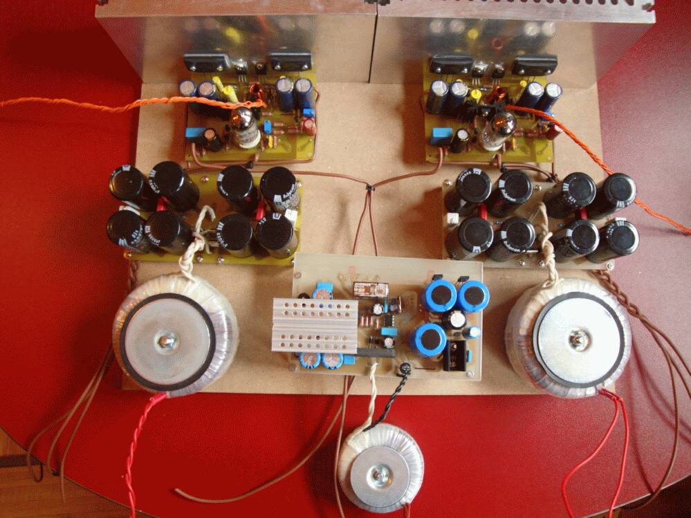

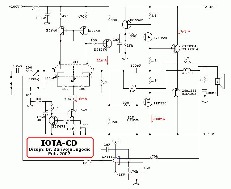

Maybe not entirely along the concept of this thread, but this is my humble contribution. Done last year by one younger member of our local forum “EnaB”. Curiosity is that I never heard this design of mine!!! I never have enough time to build and test all my designs, but thanks to a devoted small group of younger followers, new designs are prototyped from time to time.
This is different concept, I want use only tube in VAS, and only mosfet in output, without global feedback. It's OK to use dual triode in differential instead fets or bjt, but that's not kind of hybrid what I want.
Regards
Roughly DOGC based with tube input 🙂 includes Pete Walker's feedforward correction. The only thing i don't like is that the output sticks to +V rail of the output until the tube heats up, but that is easily solved (see idea with optocoupler, put the LED in the LTP tail, and transistor to provide bias for the VAS CCS.
You are right "ilimzn" (as usual! 🙂 ) but only if someone turn EVERYTHING on at the same time. I was aware of that problem from the first moment and I have sequential turn-on system already solved for IOTA's PSU unit, just not posted here yet. Idea with LED in the LTP tail is witty... very witty... nothing less was expected from you. I will try to "visualize" that in my head and maybe implement it.
