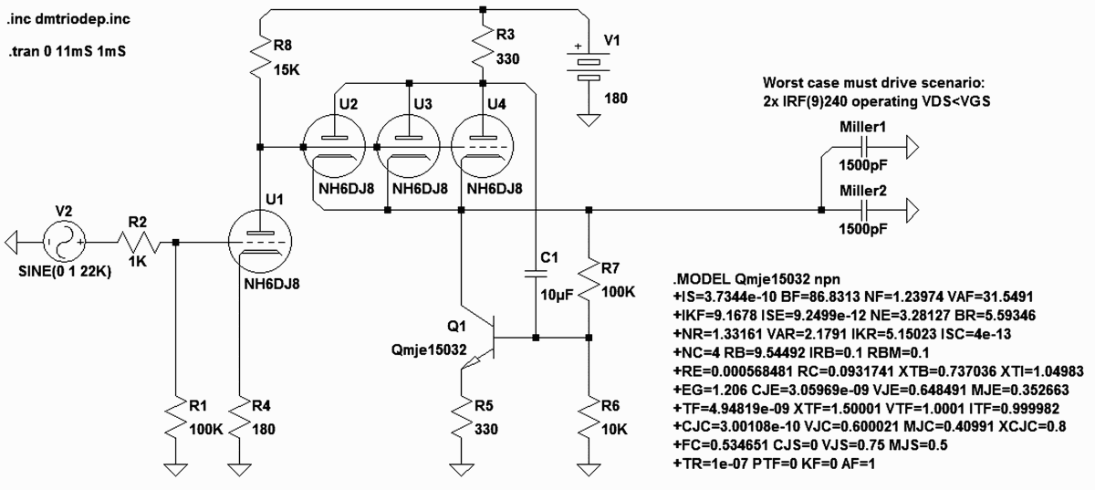

V2 appears to be a White cathode follower.
If so, the output "impedance" is quite low.
On the other hand, there is a very low limit
how much current can be pushed or pulled
by an ECC88. And it may not be enough...
Slew rate limited, is that the right term???
I figure +/- 4mA per gate at 22KHz. Bob Cordell
recently warned me that figure actually rises if
operated into VDS less than VGS. I sim this with
1500pF Miller sandbag, get +/- 10mA at 22KHz?
And this design must be driving FOUR such gates,
but only 2 into VDS<VGS Miller trouble at a time.
Suppose Apex were to parallel V1b, V2a, V2b?
and replace the current V2b location with a
transistor (and the appropriate bias resistors).
Triodlington also comes to mind...

This is any one of several ways one might do the front end to drive +/- 20mA
at 22KHz. If Cordell's extra 1500pF Miller for IRF240 when VDS<VGS is believed?
This obviously would seem way overkill if the non-linear capacitance is ignored.
I'm not at all sure that 1500pF sandbags accurately model the problem, if this
extra capacitance only appears dynamically. I'm just guessing this is how you
might assure you are covered for it?
Dmtriodep library included in the zipfile is always credit to Duncan Amps.
I have not checked to see that my copy is current against the official one.
Visit his page for the real thing. NH means "No Heater"
I probably didn't pick the optimal high voltage transistor either...
Just used one I happen to have a spice model on short notice.
I thought of it too late. R5 probably shoulda been a white LED...
