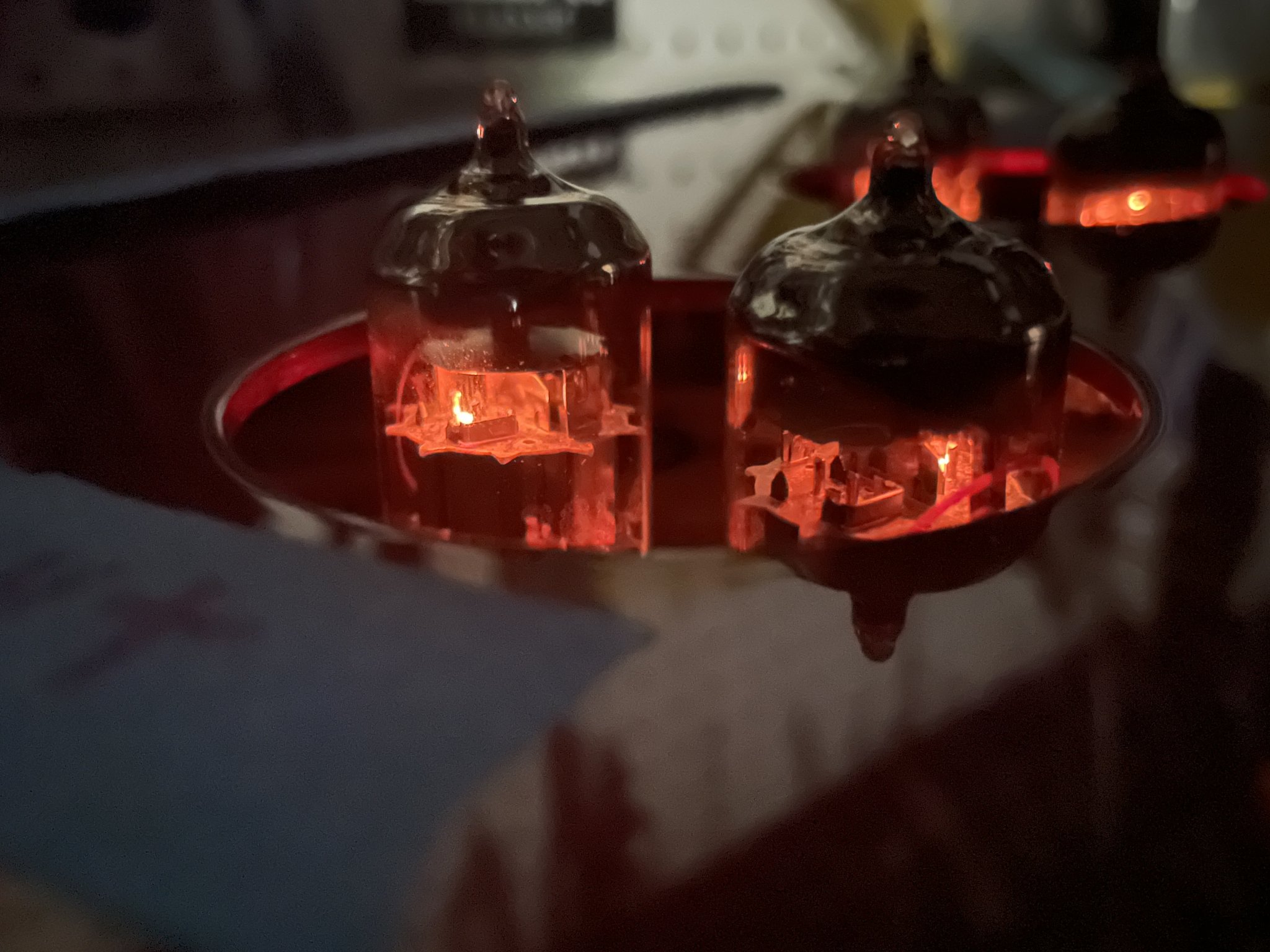

My question is how it was working since you need both triodes in V2 ?
If you build it right now is a different story
Wrong PCB , is not for 12AX7 but 6DJ8 or similar tubes
Maybe soviet 6N2P that is close for gain , if you asked the manufacturer probably they will tell you
The output stage uses only 1 triode, if only one filament is lit.
That makes the cold output triode into a set of parasitic capacitances in parallel with the lighted triode, if indeed the two output tubes grids, cathodes, and plates are wired in parallel. And, that makes the output impedance 2X as high as two triodes. This preamp was never made to use a 12AX7 in the output socket; And a parallel 12AX7 for the input stage would be lower noise than a single 12AX7 triode, so the input socket was not made for a 12AX7.
A single 12AX7 filament draws 0.150A at 6.3V (the cold filament draws 0.0A)
A 6DJ8 filament draws 0.365A at 6.3V.
A 6922 filament draws 0.300A at 6.3V
An ECC88 or E88CC filament draws 0.356A at 6.3V
More current = less than 8.7V on the filament
Pick up some new tubes (that use pin 9 as a shield, and that usually require grounding of pin 9.
Who installed 12AX7 tubes in a socket that was made for something like a 6DJ8?

Update: the manufacturer got back to me finally. This unit uses 1/2 of 12AX7 in stage 1 and 6N1P in stage 2. Filament voltage is now 6V3 on 1/2 of 12AX7 (other half dark) and 6.3V on the 6N1P. All good on the filament supply. So that's sorted. I put some labels on the unit so prevent this problem for any future owners.
I replaced all the electrolytic caps while waiting for some info on this one.
I tried different tubes on the bench and put a 1kHz sine wave in to measure the output. My goal was to get the best tube matches in-situ. So far so good. Sound is great now.
Now the problem, which takes me back to a fundamental question.
I put the unit into a system and play vinyl. Sounds great. Sometime over the course of 36 hours of being powered up the left channel output comes down. I didn't measure with a meter. Sound is there, but image is right of center. 6dB down?
I swapped to next best tube config on my list of tubes. Again, center image, even levels. It's going into the next 48 hour run now.
What might cause a channel to drift down in level? The 1/2 12AX7 thing?

Measure all of the circuit DC voltages, and compare them between the channels when they are imbalanced.
There must be a bad connection in the left channel, triggered by heating up. Not likely to be a bad capacitor.
Also check the filament voltages, just in case that's the problem.

On the channel to channel problem - I think I've come to the conclusion that 1 set of 4 tubes that shipped to me are ~8 years old and are tired. I also have a set of 4 fresh tubes. Those measure much better on the bench. I'm going to do a 24 hour run on a few different positions to see if things behave as they should. If so I'm happy. Then I can send this unit back to my friend.

I’m on the pin 4/5 and 9 track.
you should be able to checkt the continuity of the tube sockets there: which one has power?
once correct (good fitting tubes will give light on both sides; ) then the power draw will be as intended; and the voltage should drop as expected.
