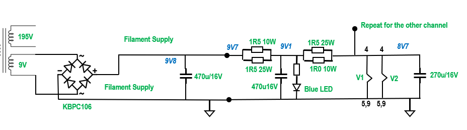

Tube MC Phono Stage - RIAA Calculator / Formula Help?
