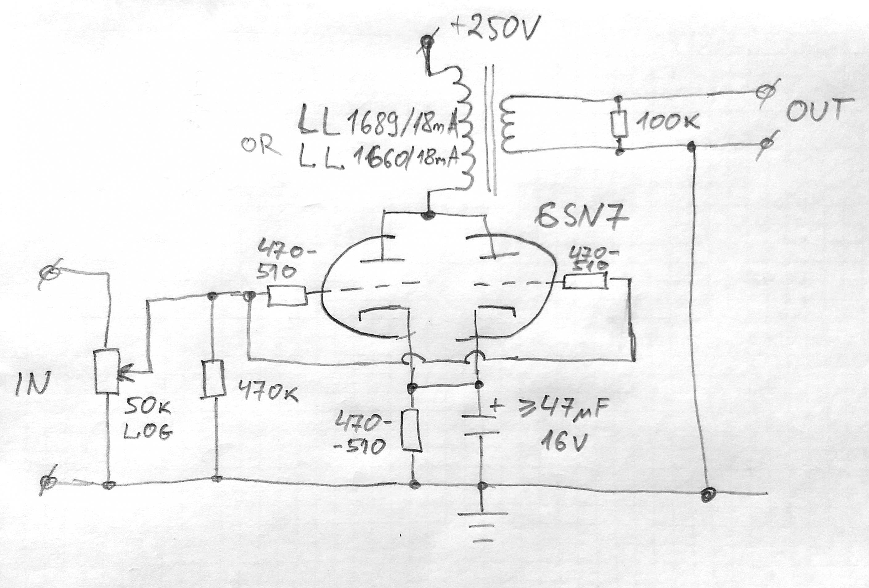

jazzzman, here you go
Quick, dirty, straightforward classic, no extra parts and stages, about 10-12dB gain (depends on the next device input impedance), can be inverting or non-inverting (just switch the secondary ends as you wish)

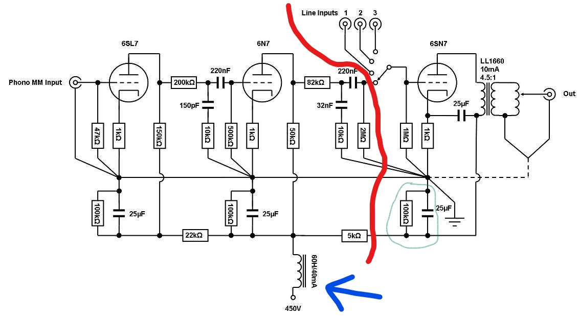

Thank you sjs and TG. TG, your design looks interesting. The design from Thomas Mayer also looks interesting. I am between the two, but first I have a couple of questions regarding the Thomas Mayer design.
I have attached a copy below. I would only use the line amp portion which is to the right of the red line. I have circled in green the portion that Thomas said decouples the power supply (he is using the same power supply for both channels). He also says that the choke (see arrow) is also used to decouple the power supply. I seem to recall that somewhere he says that the choke could be eliminated. My first question is whether decoupling the power supply is important. I do not recall any discussion anywhere else about any concern of using the same power supply for each channel of a preamp. Any thoughts from anyone?
Secondly, the designs clearly have differences, but I do not understand the significance of them. Does anyone know of any advantages/disadvantages of one approach over the other?
It is to some degree.
You can use common CRC-filtered supply for both channels.
You can use common CLC-filtered supply for both channels.
You can use separate CLC-filtered supplies for each channel with common rectifier for both (common first capacitor, then separate chokes and second capacitors).
You can even use fully separate (including rectifiers) PSUs for each channel.
You can also go for LCLC, CLCLC or LCLCLC filters, B+ voltage regulators and many other things.
Each step is beneficial. You basically stop when your budget ends 😀

My design is classic common-cathode stage. Thomas' design is commonly known as "ultrapath". They differ essentially just in one thing - where to connect the other side of the cathode bypass capacitor - to the ground or to the B+.
You can read on the pros and cons of both designs in this TubeCad article:

1) You want to choose a triode with a low rp, so you don't need gobs of inductance from the primary.
True. That's why I used both 6SN7 halves in parallel in my design above. That would have rp slightly under 4k, and LL1660/LL1689 need 3k or more for 4.5:1 connection - that 100k on the secondary is there just because I don't like secondaries hanging in the air when the device is not plugged to what it's intended to drive.
