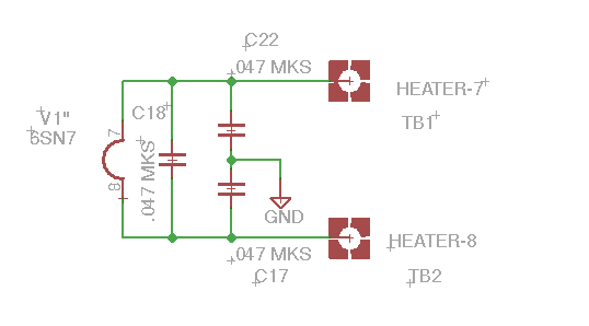

I'm doing a 6SN7 preamp layout right now. So far all the mock-ups have worked great with DC.
On the board Im thinking the filament should be bypass as shown. I have a bag of .047 600V MKS good for power filtering.
The preamp is designed specifically to operate on ultra cheap ebay switching supplies. A $1 bucking supply feeds heater.
Its hybrid CFP and uses Plus 24 and minus 24 VDC. The Plus 24 also feeds one TPA3116 d power amp. I listening to it right now.
The pre board is for a mono block.
So any opinions on bypassing, the goal is keeping switching noise down.
I don't hear any now but since probably one pass on the board fab I want to get it right.
pic attached
pic attached
-bruce

Guess I'll remove the caps and put power quality fix on a separate PS assy.
I planed on keeping the power supply/amp separate from preamp anyway.
For testing want to be able to use AC heater too.
Easy to use 12SN7 that way.

The caps will do nothing, apart from occupy space. If the heater supply is unusually noisy then you need a filter or a better PSU.
I am unclear what this means.jfetter said:I have a bag of .047 600V MKS good for power filtering.
I agree they are gone now.
Preamp board not a good place to clean up system power supply.

I only use WIMA MKP and MUSE BP in signal path.
The WIMA MKS 600v is good high quality for bypass cap, can take a lot of nasty.
