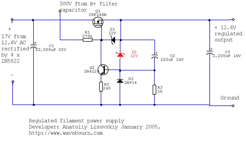

I use regulated AC with current limiting. It prolongs life of filaments due to small in-rush current causing less local overheating of filaments, working points of tubes are more stable, and level of hum is less than possible with AC.
SS components are very cheap compared to what has to be spent to obtain transformers!
Edit: here is one possible sample (C2/R3 time constant instead of current limiting):
