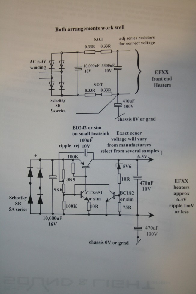

richj,
is the schematic you posted converting 6.3VAC to 6ish VDC? I am asking because I am considering using dc on a JE 300b monoblock I am piecing together now. I've been reading this thread to get some ideas on how to put it together.
I guess my general question to the group is what terms should I use to find AC conversion to DC so I can understand and implement a good design.
thanks
77seriesiii
thanks
77seriesiii

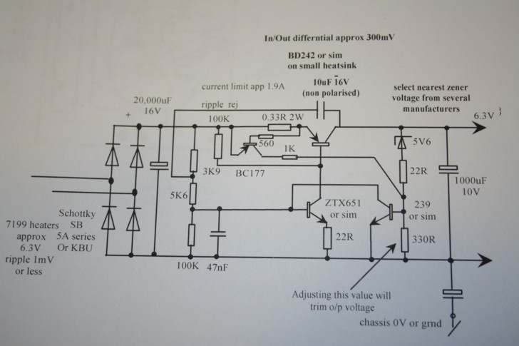

77seriesiii
The upper pic (passive cct) has some volts headroom but not for high current stuff. It will get the worst of the worst AC grime off.
Yes connect both it to standard 6.3V AC. Schottky diodes SB550 or sim with low Vf are recommended as low voltage conversion is the least efficient in power terms.
The lower diag is more serious, has typ less than 0.3V diff between in/out and will easily challenge the -60dB ripple rejection of a standard 1A low dropout LM series.
Experimenters and physicists should see the lower dissip & Vin/Vout drop-out advantages of using a pnp as a pass tranny. Ironically most industrial pnp designs get vetoed out.
The only drawback is selection and trimming of the zener to get exact 6.3V DC output and chosen over several makes. A TL431 could also be used here. (Haven't tried this).
Current limiting resistor can be hung on, the Vin/vout diff thus increases to app 0.45V. The jist is enclosed.
There are loads of this type of circuits about... that can be botched up and about..and still work.
:-richj

richj,
cool. The last design you attached that should work with the necessary 5vac to 5vdc for the 300b application I am using correct? I need to do a bit more research but looks straight forward enough.
For the zener selection, how many do you go through normally until you find the good one? What ranges have you seen in this until you find the good zener? Also, the resistors that are not labeled wattage wise, these are 1w correct?
off to do some more reading!
thanx
thanx
