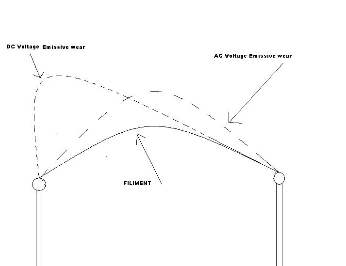

Yes there is some long term damage to filiments by running current thru one way as opposed to AC, but the gains outweigh the losses. Another Pro is DC regulators can put your heaters in a standby mode......something your AC can't do.

I don't understand. How does DC damage filaments? Can anyone point to any real data that proves this or an explanation of how this occurs?

My understanding is that the 'wear' on a filiment is polarity dependent...I recall someones 813 SE amp whereby each time it is powered up the polarity is switched....a solution to a perceived or real problem for sure but this guy had to use a microproccesor to accomplish it!

Zero Cool,
My concern with trusting a tube amp manufacturer is that I suspect that they may have been trying to sell an amp that uses an AC heater supply. One that costs less and is easier to manufacture and brings in a greater profit if they can market it well...
I'm not saying that you can't make a great amp with AC heaters, but it is in a tube amp manufacturer's best interests to create a little fear, uncertainty, and doubt regarding DC.
Let's think about it a second. The filament(in an indirectly heated tube) is a wire. It's sole purpose is to get hot and radiate that heat to the cathode, so that the cathode can emit electrons. If the resistance along this wire is not completely uniform(it isn't), then some parts will be slightly hotter than others. But I don't see how polarity or AC vs DC would make a difference with these hot spots.
Rick,
Are you talking about DHTs only? I could see maybe some emissive coating might get worn with DC due to the fact that one part of the cathode always being at a different potential than the other half. The electrons would prefer one end more than the other. However, this would not be an issue with indirectly heated tubes. What are your thoughts?
ZC, it is a faint, vague possibility for a directly heated cathode, but for a "normal" tube, that's rubbish. What amp manufacturer made that claim?
