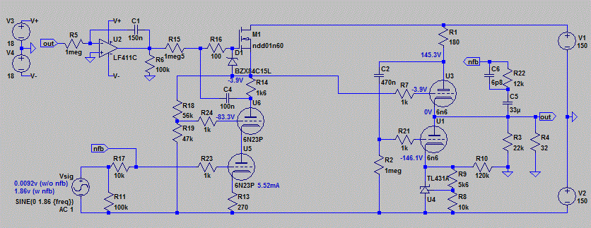

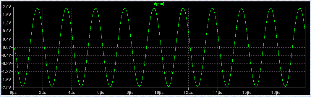

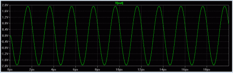

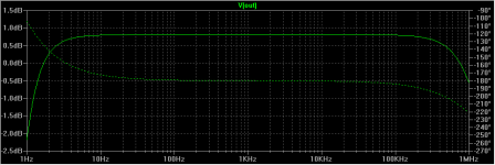

Some data from my latest project, an OTL - OCL headphone amp, with bias servo, 6N6P WCF output stage.
It manages to push out 60mA, which is 60mW into 32 ohm cans, at 0.2% THD. Zout is ~1.7 ohm over the entire audio range. Have a look at attached diagram for (simulated) frequency response and phase shift.

It's not finished yet. Still needs an input buffer to shift the signal down to the negative rail. Also, a startup protection may be required, depending on how the tubes and servo power up. So, it's just the basig engine for now. Note, although this shows 32 ohm load, the circuit works stable for 600 ohms as well, your just need to reduce the nfb.

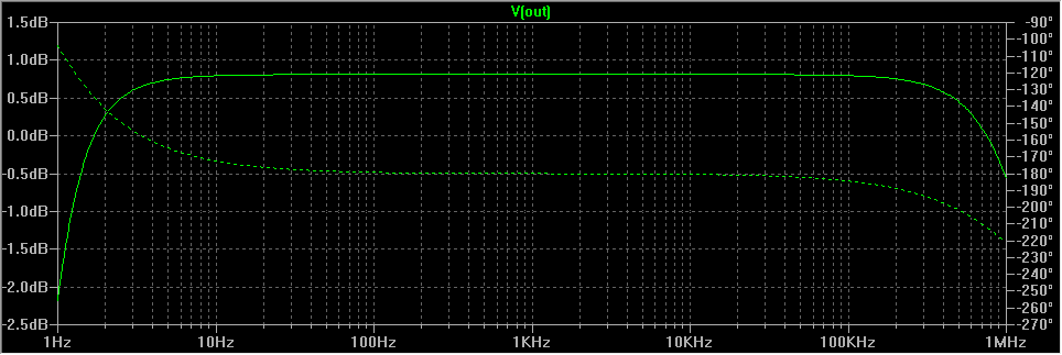

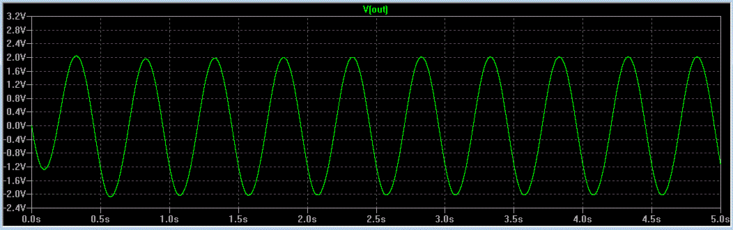

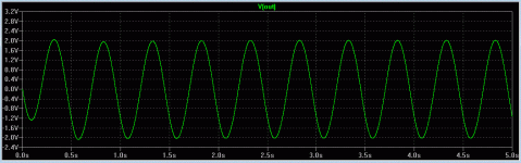

Scheme and response at 2Hz & 500kHz attached. Try that with a transformer 😉😛
sure, but what's the point ? You can have pretty much a flat response from 20hz to 20khz with a decent transformer (can be quite cheap if you go parafeed) and that's all that matters.
And honnestly, I would never dare to use a headphones amplifier with +/-150V supplies without a cap or transformer at the output. Way too many things can go wrong. An output cap makes things easier, safer without sonic disadvantages if properly sized.

Flat response is not all that matters. There's also phase shift and distortions, which rise at the extremes of the audio range when going thru an opt.
And while the sonic impact of phase shifts may be debateable, the limits on nfb are not.
You are right. I delved in a little further and it's too dangerous, at least without elaborate protection. Just about every failure on the output tube - which will happen sooner or later - will kill the phones, and probably hurt some more. An output cap is safer, just make sure you use high quality stuff. The usual 'lytics will probably also short out, sooner or later, resulting in the same hazards (if your output is not dc free for other reasons).
Also, with OCL you don't gain as much as you would think, since you only move the big ole cap to the nfb network.
In the end, it's probably worth it to use both the dc servo and an output cap. This way, no single failure will kill your phones, while the numbe of caps in the audio path remains the same.
Fair enough wrt phase shifts and thd (mostly at the lower frequencies).Flat response is not all that matters. There's also phase shift and distortions, which rise at the extremes of the audio range when going thru an opt.
Limits on nfb are indeed clear. I must admit that my latest builds didn't use any, so that was not of concern to me. An advantage of headphones is that power requirements are so low that you can achieve low thd even without gnfb.

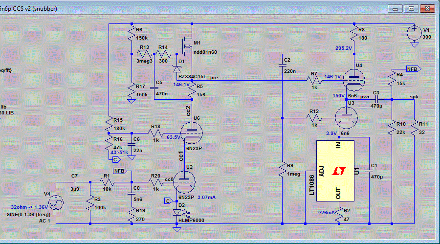

I also had another look at the OTL design and came up with the attached schematic, this time using output caps. Frequency response is a little narrower, I needed to cut the top and bottom end a little to keep the feedback loop stable and to avoid overshoots and ringing. Zout is <0.2 Ohms and THD <0.03 at full power into 32 Ohm load, thanks to large nfb >50 dB.
If my thinking is still healthy, the nfb loop should also correct for any possible distortions originating from the output cap as well as the bypass cap?

As for the latest amp, it seems sound. Of course, the difficulty will be to build it in such a way that it is stable. With that much feedback, do you really need the lt1086 ? How much a difference in sims do you get with either a diodes string or simply a resistor instead ?
The snubber at the input should suppress all oscillations above the audio range. The following stages are very wideband and phase shifts in the audio range between input and output are minimal.
Of course you can simply use a 150R resistor in place of the LT1086. The LT1086 simply forces the optimum current thru the output triodes at all times, regardless of tube variations and ageing.
