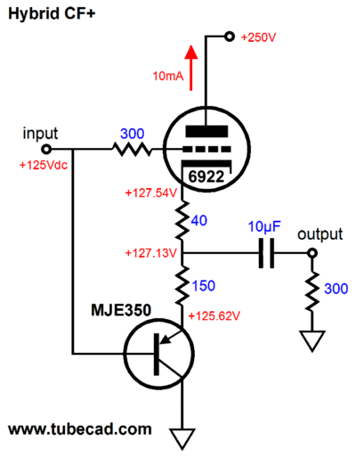

Anyways, would a pentode or triode as a cathode follower be enough to drive headphones that are more than 100 ohms?
Also, don't most headphone amps have a 120 ohm output, to make hearing damage less likely?

According to this, many headphones work well with a 120 ohm series resistance: Headphone Amplifier
I guess something like that should be achievable with a cathode follower and negative feedback..
Anyways, my friend's headphones are 250 ohms..
PRR's observation that '7V behind 29 ohms will drive "any" headphone' is a useful rule of thumb.

Many people confuse output impedance with drive capability. It is not too hard to make a cathode follower with a lowish output impedance. The standard formula for this is 1/gm for a cathode follower and, depending on the tube used, results in a calculated output impedance of a few hundred ohms or less. With additional negative feedback this can be reduced still further. However, it is important to remember that these formulae apply ONLY to small signal conditions. The volt or so you need to drive 250 ohm headphones is NOT a small signal and these formulae no longer apply.

Perhaps you could get away with a White Cathode Follower, where Zout is more like 1/2gm. Using a 6DJ8 (=ECC88) with both halves in parallel you'll get a Zout of roughly 1/4gm which might just work. You'll want to run it at fairly high current in order to get a good gm and ensure that there's sufficient current for the load.
With 250R phones, perhaps their sensitivity means you don't need any more than 10mW of power ? - and you'd be unlikely to need more than 10mA of current into the phones. That's well within the capability of a doubled-up 6DJ8 which you might run at 15mA per side, total 30mA for a doubled-up for each channel. Providing there's enough current I don't see any issue with there being enough drive capability. Plus these tubes are reported to work at reasonably low plate voltages too.
This is all theoretical, I've never built anything like that myself. My phones are 32 Ohm so I'd not contemplate this approach myself.
Edit: Here's another option for a hybrid that borrows the high gm of a transistor for lower output impedance. I've never seen a report of anybody who has built it so no idea of the sound or any complications.
Brains & Brawn Cathode Follower

But what about this: The Morgan Jones Mini Tube Headphone Amplifier | HeadWize
Also, would it be reasonable to replace the output cathode follower with ECC82? I have been under the impression that while not good in audio in most roles, it will work fine as a cathode follower.
Apparently it seems like it would be possible to drive reasonable amount of power even to 32 ohm headphones. About 10mW should be enough for headphones, after all..

No, it cannot supply enough current to drive headphones.Also, would it be reasonable to replace the output cathode follower with ECC82?
A White CF using an ECC88 (such as Morgan Jones) can deliver about 10mW into 50 ohm phones or 100mW into 300 ohm phones, with <1% THD. Into 32 ohms you *might* just get 10mW with less than 5% THD... An ECC82 would fail miserably on all counts.Apparently it seems like it would be possible to drive reasonable amount of power even to 32 ohm headphones. About 10mW should be enough for headphones, after all..
ECC82's maximum current rating is 20mA, while ECC88 is 25mA. Hardly a big difference, so what makes it so bad?
If you read my link, with ECC88 the optimized version with NFB put 10mW to 32 ohms at 1.4% THD.
ECC88 can deliver a lot more peak current (and with a lot less voltage drop across it). I suppose an ECC82 White CF with a 400V supply might just mange it, though it would be frightfully inefficient.ECC82's maximum current rating is 20mA, while ECC88 is 25mA. Hardly a big difference, so what makes it so bad?
Yes that's with global NFB to reduce the distortion.If you read my link, with ECC88 the optimized version with NFB put 10mW to 32 ohms at 1.4% THD.
