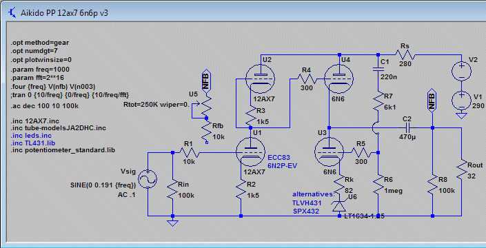

Try one of the Aikido circuits for High Impedance Phones
I've had very good success with the Aikido amp configured for HPA use.

The Aikido, as push pull and with some feedback wired in, should also work nicely for 32 Ohm cans.

The Aikido doesn't use any loop feedback. It has also been my experience that it doesn't play well with low impedance 'phones, certainly not AKG 701s. The "Morgan Jones" amp has variable feedback that is said to drive low impedances.

The stock Aikido pcb has no feedback, but for DIYers should be no Problem to wire some in. See attachment. Zout falls to ~4.5 Ohm, which should be plenty good for 32 Ohm phones.
Joined 2009
This looks grossly inefficient though - don't you want something like 100mA drive for 32R phones ? Just using an output transformer to match a tube output stage with low impedance load makes more sense no ?
This circuit can deliver ~1.3V rms into 32 ohm, which may or may not be enough, depending on the sensitivity. If it's >100dB/V (which many cans are), it's probably sufficient.
