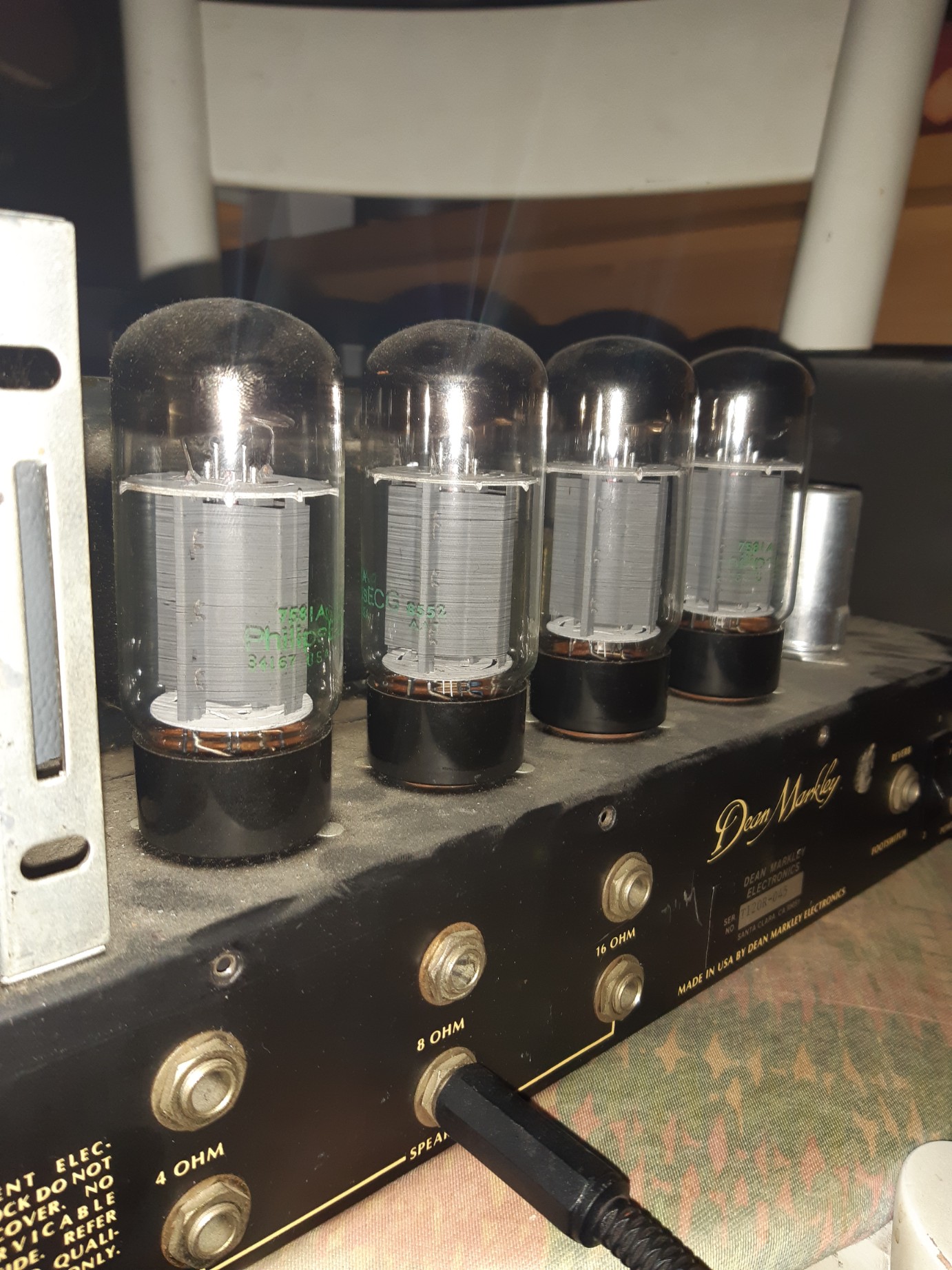

I had a good poke about in the case before I made live again, as it had been sat unplugged for a day or two. Besides some weary looking, mangled legs on these 100R resistors, nothing is jumping out at me.
I have to wonder how I measure quiescent current for bias adjustment though, seeing as all cathode are tied directly to socket then star pointed, and a single ground return. It's going to take modification (ok that's a given), but in the most cramped tight spot!
Who ever decided to wrap the anode wiring around the PSU PCB and out to the OPT should've been sacked. The heater wiring is sloppy too. These amps are renowned for being hand built, and you can tell.
Re tensioning sockets? Well I dont know what that is, or how it is done. I just cleaned off the preamp valve pins, which were slightly tanned, and darkened up by the tube base. If I had thought about it, I wouldve used a flux pen, as it looked a little like blued metal tarnish.

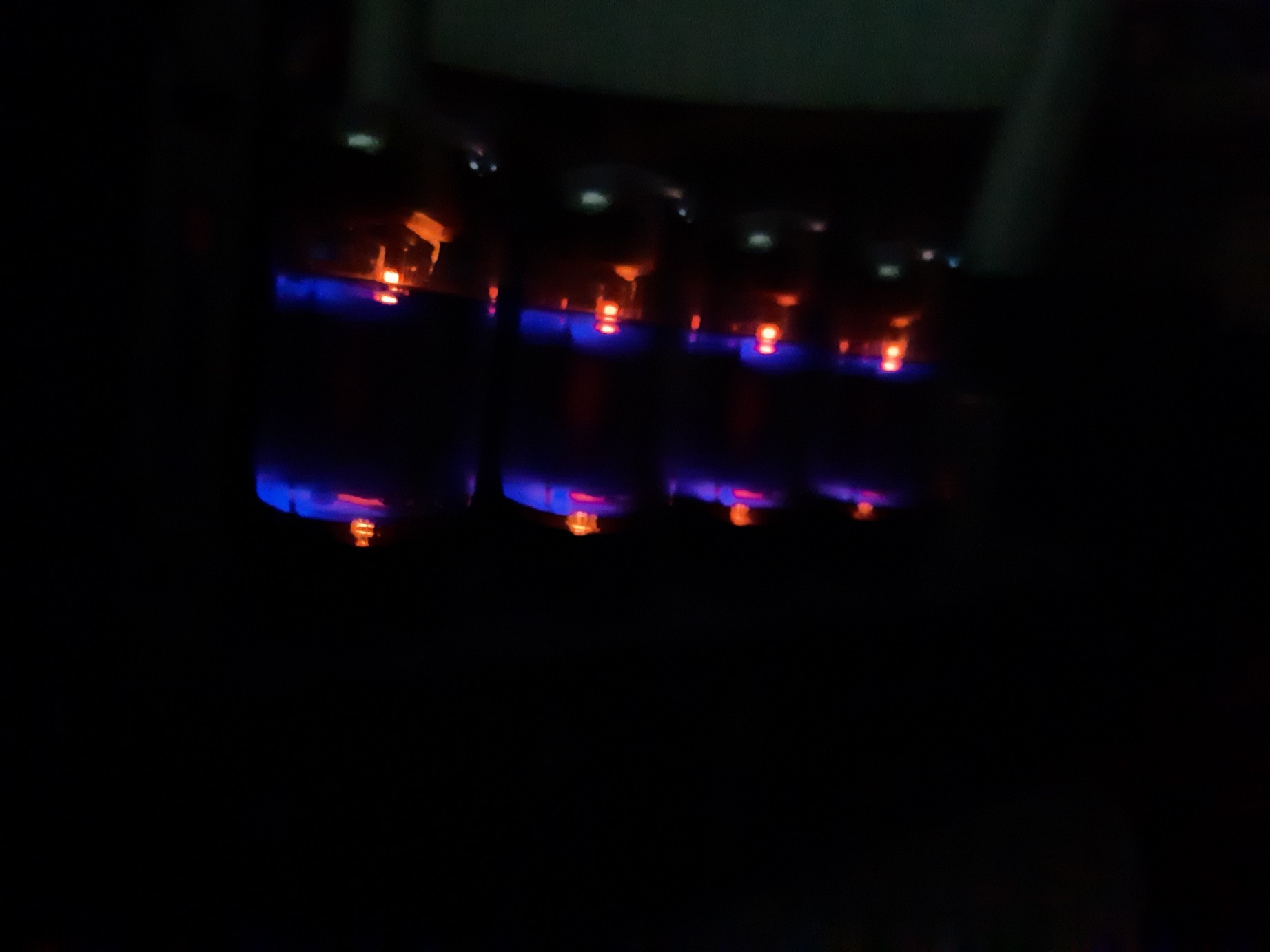

I have closed curtains to search for red plating but its bright here this week. I see some blue glow, which I dont think is a problem. I haven't measured voltages yet, I need to find my clip on leads.
For now I've left tinkering, to resume when it's dark and I can check the for red plate more easily.

Not quite visible in the darkened photograph is slight red plating on all 4 valves.
So I think a re cap is in order.

Once "redplating" happens, even slightly, the tube is now weakened due to coatings burned off the plates.
They might still work, but any that I've tested show a partial loss of emission over a non-abused tube.

I plan to replace the hot bits that have caused browning of the PCB, and I've worked out that this is actually the bias circuit and zener split rail supply for the op amps and reverb circuit.
I should probably put all the info and internal photo detail into my original necro thread here:

It would seem that it's not at all unusual for guitar amps to run the pentodes with screen volts similar to plate volts rather than say 20% less.
I wonder then, what difference to running in triode wired?
The only difference is g2 and anode aren't directly connected (isolated by supply choke)
I need to re measure the screen volts at the tube (rather than the PSU tap) just to be sure. Theres additional resistance in the screen circuit, so chances are that drops the supply voltage slightly.
When using triode mode you can get away with a B+ a bit above the usual (pentode mode) G2 screen voltage rating.
In pentode - as the tube conducts heavily on signal peaks, the anode voltage is pulled down and becomes much less than the screen voltage, as a result screen current peaks (and hence screen dissipation [volts x amps] peaks too).
In triode mode screen voltage and anode voltage are the same so the usual ratio between anode current and screen current stays the same. There is no extra peaking in screen current and so the screen can tolerate a bit more voltage without overdissipating.
Similarly for Ultralinear Mode.
Whenever an amp has had a red plating of output tubes experience, (run away anode current) it is a fair bet that it has had screen current peaks too, and those 470 Ohm 2W screen resistors suffer. They can be a source of crackles and pops. Check them with a multimeter, on amps which have suffered a red plate I have measured them anywhere between 320 Ohm (way low) to 880 Ohms (way high) plus the ones which just fall in half (way way high).
Ian
Ian
Hi Ian,
I have to admit I had not considered checking or replacing the screen resistors, so thank you, that's another worthwhile check.
I have a feeling once I replace the first pair of PSU capacitors, the B+ will be higher.
(Currently I measure 482Vdc, with 360Vac input to the diodes, even considering the double diode drop x 2, theres some more volts lost, I assume by the 100uF reservoir being past it's best)
