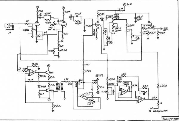

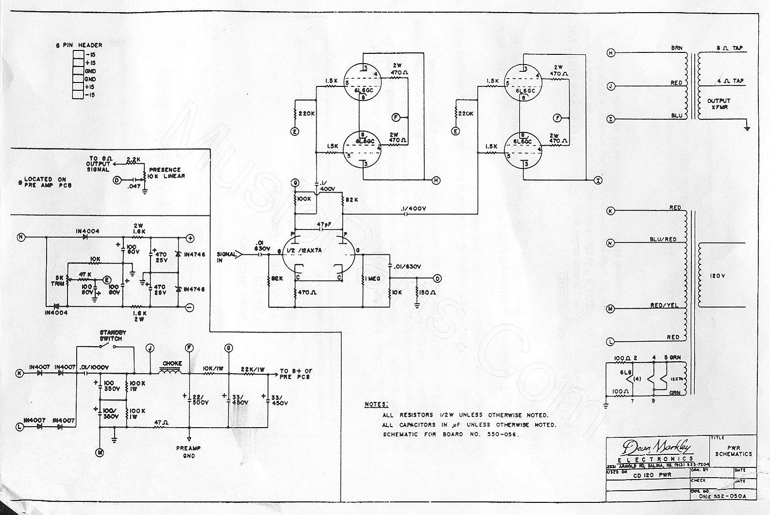

Hang on, I've found most of the schematics
:eek:
Multiple fails, HDDs and mobile devices has meant I has lost all the schematics and info I'd picked up.
I know these aren't quite complete, but at least I have some more idea what I'm looking at.

The schematic cannot be completely correct, since there are no connections
to the cathodes of the output tubes. Perhaps they are all grounded.

It puzzled me why the cathode are just joined, but appear not to be referenced to ground.
I've pulled the tubes from the output, and all pins are shiny bright metal, sockets dont look too bad either, brown bakelite/tufnol? Not a trace of arcing topside.
When I check the underside, I'll have to see if the cathode really are just joined to each other!
