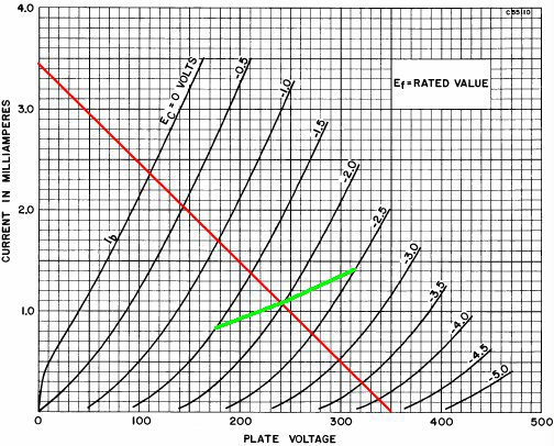

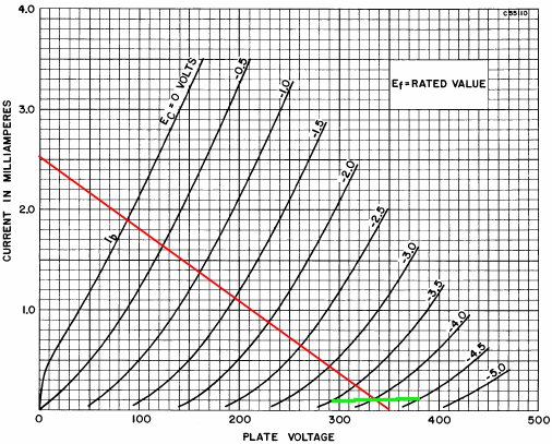

I'm happy for you, that you found what you were looking for. 🙂~425V...Crisper distortion, more alive feeling, not "hazy" at all...
considerable difference in the distorted tone
I have read similar comments about distortion changes with increasing supply voltage in the past. I just wish I understood exactly why you got the results you did.
Increasing B+ slides the load-line to the right and upwards, and increases the amount of (negative) grid-cathode bias voltage. But I don't know why that should translate into crisper distortion. I wish I did.
-Gnobuddy

Understand. Can you report the Rk and Ra values? We can all work it out from there.No, didn't document voltages, nor calculate load lines.
Hence the question. It'll be interesting to see where the load line has ended up, particularly compared to the operational areas chart (Marios?) we saw in another thread about a month back.But I don't know why that should translate into crisper distortion. I wish I did.
It suggests that we should abandon the conventional chain-of-RC filters from the screen supply for preamp supply and instead run the preamp straight from the rectifier (or from it's own HV tap), perhaps with some additional filtering.
V1a: 100k / 1.5k
V1b: 100k / 1.5k
V2a: 330k / 4.7k
V2b: 100k / 1.5k

Thanks for the details. You could always try 220K on plates and 2k2 on cathodes and see if it floats your boat.
Believe me, I've tried every plate value from 47k - 330k, and cathode values from 470Ω to 100k (lol). And as many combinations at each stage as I had to patience for.
I've settle on 330k/4.7k for the 3rd stage. It gives the right amount of sizzle and sustain I'm looking for. 100k/1.5k balances out the brighter tone.
And the funny thing is, is my ear always seems to gravitate towards a 1.5% cathode-plate ratio, regardless of Ra. Weird.
