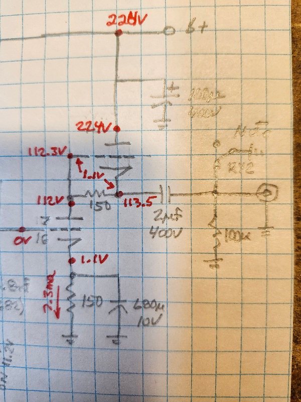

Tube, Explain this circuit topology
Hi. I came to this unusual circuit topology, can someone explain it to me, what are it features, output impedance, gain, noise, etc...
the cicuit is done using the two sides of the same tube, one top the other.
Tube is the unusual Mullard E180CC

I reckon that's cascode.
The top valve is 'just' a constant current source. Without it , instead just the usual load resistor, the current through the lower valve will be more when the valve is more 'on' when the input signal asks for that and less when it's 'less on'. With that topology the lower valve (both actually) will always operate with the same anode current.

I learnt it recently in another thread on this forum.
In short. It doubles the output current capacity.
It works in push pull. Imagine there is 0 current on the lower part. The top triode gets 0v grid voltage, and all the current will be sunk by the load. The upper portion is far from a current source. You might only get couple times the plate resistance out of it.
