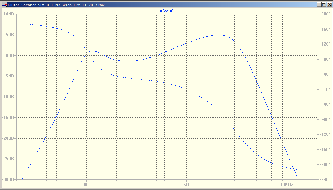

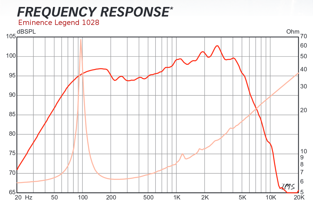

There was a thread elsewhere on diyAudio where the subject of (guitar amp) loudspeaker frequency response came up. I grabbed the first frequency response I found on the net, drew a couple of straight lines on it, and then fiddled around with LTSpice to see if I could roughly duplicate the frequency response.
In the Hi-Fi world, speaker frequency responses are measured on-axis. In the world of Eminence guitar speakers? I have no idea, but if the published curve is on axis, as I suspect it is, it's already falling off dramatically (3rd or 4th order) above 3 kHz.
So if that's the on-axis response, imagine what the response looks like when you also point the speaker at your knees instead of your ears? Is it falling above 1 kHz? That's about a one-foot sound wavelength, small enough for a 12" speaker to beam noticeably. 😱

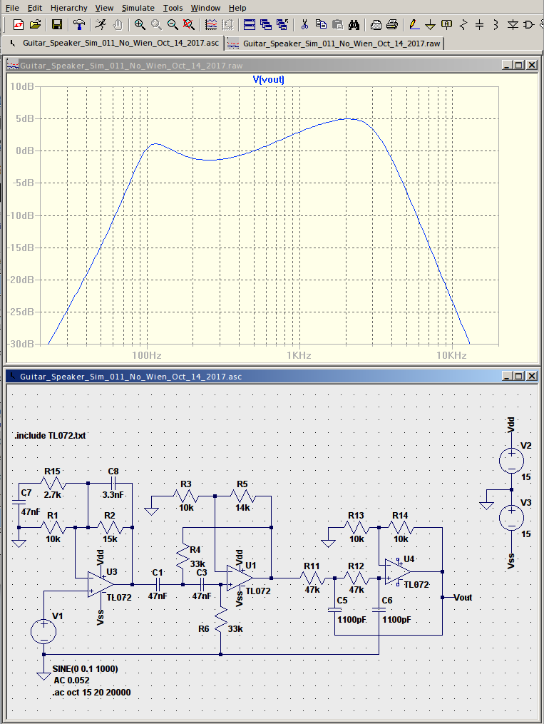

In LTSpice, it took me an hour of fiddling and three virtual opamps (or one and a half dual opamps!) to roughly reproduce the Legend 1028 frequency response. In the attached schematic, the first opamp implements a crude first-order peak at around 3 kHz. The second one mimics the bass end of the speaker frequency response curve (2nd order high pass). And the third implements the high-frequency rolloff (2nd order low pass).
I'm hoping I can simplify the electronics with a little more tinkering. But, worst case, opamps are cheap.
Meantime, I have a couple of guitar pedals that are supposed to have speaker emulation built-in. Before I try to build my own, maybe I should try one of those pedals between a guitar and my nasty-sounding DIY amp to see if they improve things.
-Gnobuddy

I was quite surprised that the Legend 1028 rolls off as early as it does. Only three kHz? Geez!

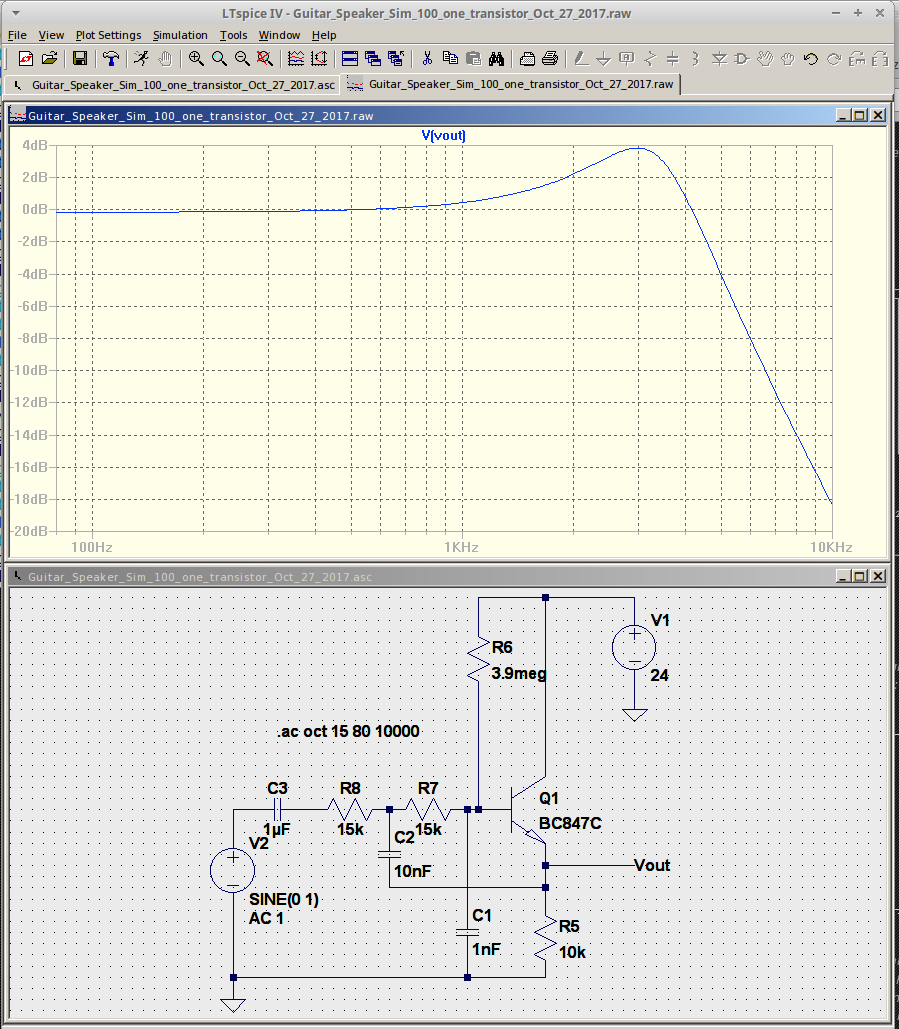

Here is my first attempt at a very simplified speaker emulation circuit (simulation only, not built yet). This time, I made no attempt to duplicate the low-frequency end of the speaker response (my little boom-box woofers already have their own bass roll-off). So I tried to duplicate only the roughly 3 kHz peak and rapid fall-off above it.
I grew up with the wonderful BC147/148/149 transistor family, so I used one of their descendants in my circuit. It looks like one single transistor will do the job, though it must be fed from a low impedance, not direct from the guitar.
-Gnobuddy

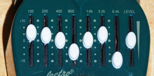

I did try this today. My guitar went into the Fish-n-Chips graphic EQ, the output from that drove the class D power amp module, and that in turn drove the stock speaker in my Princeton Reverb reissue, still mounted in its stock combo cabinet.
To start with, I left the EQ curve alone (as dialed in yesterday for the little boombox woofers). Through the Princeton Reverb speaker and cab, there was noticably more bass, but the overall sound quality wasn't all that different.
The next step was to bypass the EQ curve. The guitar sounded worse, with some harshness, typical of every solid-state guitar amp I've ever heard. But not as harsh as when using the boom-box speakers.
Step three was to set the Fish-n-Chips to a flat response (all EQ sliders centered), play the guitar through it into the Princeton Reverb speaker, and then, by ear, dial in the EQ curve that sounded best to me. (We're talking entirely clean tone here.)
Surprise - when I was done, the EQ curve was not all that different from what I'd dialed in for the two boombox woofers in their smaller enclosure, except for less bass boost. I still had a notch at 800 Hz, still had some bass boost, and still had the 6.4 kHz slider dialed all the way down.
I took a photo of the Fish-n-Chips (attached), and then sat down and measured its frequency response the old-fashioned way (function generator, Fish-n-Chips, oscilloscope). I have the data in numerical form in a Libre Office spreadsheet, if anyone wants them, but for now, I'll just post the frequency response plot I generated from the spreadsheet.
Evidently the 6.4 kHz slider does interfere with the 3.2 kHz response, as the frequency response I measured actually peaks at around 2 kHz, rather than 3.2 kHz.
So my next task is to try and generate something close to this frequency response from some simple analogue circuitry, which should give my guitar amp a good clean base tone on top of which I can experiment with adding harmonic distortion (JFETS), tone controls, et cetera.
There are lots of caveats - obviously, this frequency response was tuned for my ear, and maybe also for the two guitars I tried today (both twin-humbucker models).
Nevertheless, I think this method of voicing a guitar amp is a promising one, and I think it might save a lot of time, and produce better final results, than the traditional "tweak one capacitor at a time" method.

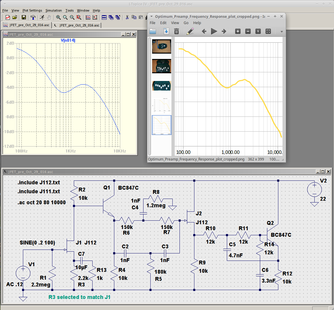

I did some tinkering with LTSpice, and a combination of a mistuned twin-tee notch filter, and a modified second-order lowpass filter, comes pretty close to the frequency response I'm targeting.
Screenshot attached.
-Gnobuddy

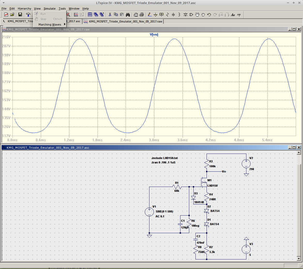

And now for the next interesting thing to share. I stumbled across this old thread yesterday: 2BJTE - 2 BJT triode emulator
The thread was started by yet another guy trying to make bipolar junction transistors sound good in a guitar distortion circuit. It's been done a thousand times, and it never sounds as good as a proper "toob" amp, right?
But this thread includes a link to a sound clip, and hearing it made me sit up and take notice. Here's the link: http://www.diale.org/mp3/v1.mp3
Now, to me, that is some pretty good-sounding rock guitar distortion. I have never heard anything that sounds as good as that come out of a BJT-only circuit before, so I am more than a little intrigued. Does this circuit really do what no other BJT circuit has ever managed to pull off - sound really "valvey" while driven deep into classic-rock guitar territory?
I threw the circuit together in LTSpice and it produces visually very similar waveforms to the ones posted in the thread.
I have also done a little fiddling and tweaking of component values in the simulator. One thing I can tell you is that the rounded corners of the negative half-cycles are very dependent on the bootstrap circuit - the values of the 500 ohm resistor (!) and 100 uF capacitor.
That is only a 50 millisecond RC time constant, so the capacitor discharges appreciably during each half-cycle at the low-frequency end of the guitars range (83 Hz), and this seems to cause the rounded corners of the negative half-cycles.
I can also tell you that fiddling with the 1k (!) emitter load of the second transistor changes the output waveforms drastically (harder corners, unlikely to sound good). Much though I would rather not operate a BC109 at 9 or 10 milliamps of collector current, that seems to be the magic spot for this particular circuit.
Note also the size of the input signal - this circuit is already beginning to distort with an input of 15 mV peak value, and is well and truly deep into clipping at 50 mV peak. There are going to be no cleans with this circuit and a normal guitar, not unless you attenuate the heck out of the signal before it gets to the first BJT.
This isn't necessarily a problem, though; you can get decent cleans out of JFET or two, and this two-BJT circuit could comprise a separate, parallel "dirt channel", with a switch or relay to changeover.
This is all hinged around one thing - how good that clip sounds. There is one big question mark in my head, though. The person who posted that sound clip says he used a BOSS OD3 overdrive pedal as a buffer/clean preamp to drive this two-BJT "tube emulator" circuit. He says the OD3 was set clean - but was it really?
The OD3 is an unusually valvey-sounding OD pedal that sounds very good in the right hands, and works its magic with a succession of slightly overdriven JFET stages, including a differential stage or two that mimics push-pull valves. It wouldn't be too far out of line to describe it as an analogue valve amp emulator built with JFETs. You can find plenty of good demos on You Tube if you want.
So the question in my head is, was it really the OD3 that produced the nice rock guitar timbres in that MP3 clip? Or was the OD3 really set clean, and did all that rich-sounding distortion really did come from that weird two-BJT/ weirdly bootstrapped/ weirdly mis-biased circuit?
The obvious thing to do would be to breadboard it and try it out, but I want to stay focused on my current project, building a preamp to take the "nasty" out of the little solid-state guitar amp I'm building to give to a friend, hopefully, this Christmas. Not to mention, I have no BC109s or BC108s around. I can't even find the 2N2222s I was sure I had somewhere. The only small-signal NPN BJTs I have are lovely BC550Cs, which have far higher beta than the BC109, and so may not sound the same in this rather oddball circuit.
But if any of you is interested enough to breadboard and try this out, I would love to hear about your results. (And if nobody else is interested, I will definitely build this and try it out once I'm at a good stopping-place with my current project.)
-Gnobuddy

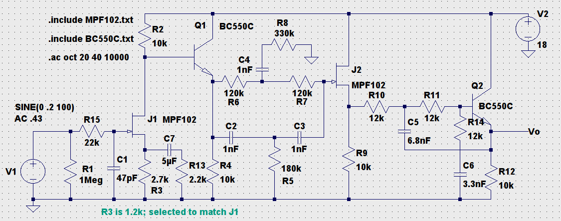

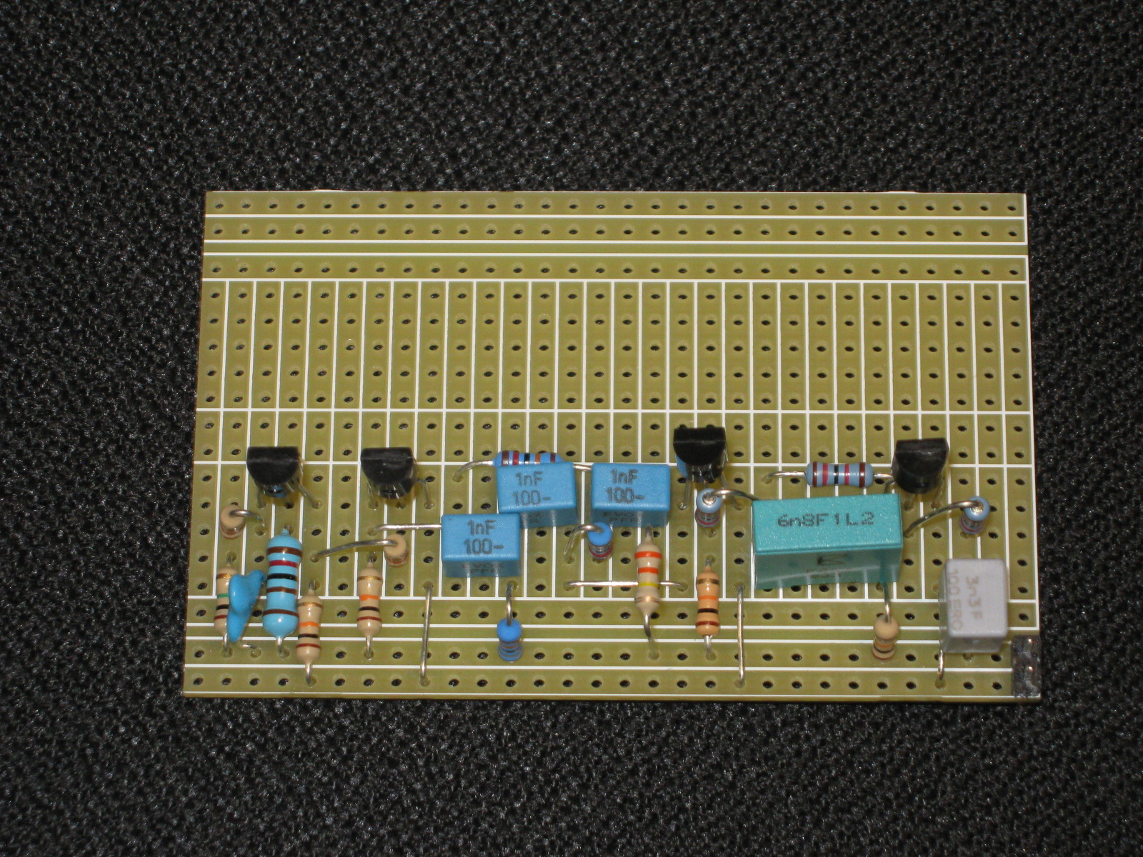

Last thing to share - this (attached) is what I've been working on. This is a solid-state preamp with a JFET input stage / buffer / triode emulator, and a frequency response shaped to match the one I got from a 7-band graphic EQ set to product the best clean tone (to my ears, obviously).
To recap, I mounted a pair of small 6.5" woofers taken from a thrift-store pair of boombox speakers in an 8"x10"x19" MDF enclosure. This sounded absolutely awful with a solid-body electric guitar played through it using a solid-state preamp and power amp, an experience many of us may have shared if we tried playing an electric guitar through anything other than a real guitar speaker.
So far, so futile. The interesting part came when I found out that I could dial out virtually all the "nasty" sound using a graphic EQ pedal, and lots of trial and error.
This is a very interesting result to me, because real guitar speakers are expensive, and the cheap good-sounding alternative speakers from vintage Hi-Fi or vintage organs seem to be very hard to come by (except for Printer2, who gets them regularly from his tooth fairy. 🙂 ) Also, real guitar speakers are physically large, and the light cone and tight cone suspension demand physically large speaker enclosures as well.
But, because smaller and more modern speaker designs always seem to sound absolutely nasty when you play a solid-body electric guitar through them, there was no acceptable alternative.
But if careful EQ can take out the nasty - which is what my ears are telling me - then a whole world of speaker possibilities opens up to us DIY guitar amp builder/tinkerers.
So I designed a circuit to emulate the frequency response I had dialed in with my EQ pedal, and it is going to be part of the preamp. If all goes will, it will work the same magic as the EQ pedal, and the pair of 6.5" woofers will sound good instead of nasty.
JFETs have such wide parameter spreads that it takes special circuit design techniques to control them. In a design intended to go into mass production, there is little alternative. But I'm building a one-off for a friend, so I chose a route that would allow me to use a simpler circuit design: I decided to simply measure one specific JFET from my junk-box, and design the biasing circuit for it using the specific parameters of that exact JFET. Throw in another JFET and it may not bias up properly, but as long as I use this particular JFET, it will work perfectly.
So yesterday I picked out and measured an MPF102 N-channel JFET from my box of goodies (Vp was 1.96 volts, Idss was 4.66 mA). With those all-important parameters known, I used the usual JFET equation and calculated that it would take a 1k source resistor to set Is at 1 mA. On the breadboard, it actually took 1.2k to get to the desired 1 mA.
Today I transferred the input JFET stage from the solderless breadboard to one of those general-purpose PC boards (protoboard), and added on the first BJT (buffer) stage. Powered up with 18V DC (from a pair of 9V flat batteries), everything biased up properly. So far, so good, then I ran out of time, and had to start on some of my Sunday chores.
I also realized I only have the 1nF caps I need for the twin-tee filter in a 10% tolerance. That's not going to cut it - one decibel corresponds to roughly a 12% change, and with three caps in the filter, using 10% components might change the frequency response by up to 3 dB.
That's too much, so I need to get some 1% or 2% film caps for the twin tee, and maybe also for the low-pass "speaker emulator" that comes next in the signal chain.
It will be slow going during the week, but I expect to make some more progress next weekend, if not sooner.
-Gnobuddy

Notch filter and lowpass (aka "nastiness remover") built and ready for audio testing (see pic).
I managed to cram my entire "de-nastify" filter (four active devices plus support circuitry) into one half of that little protoboard, so there is still some real estate left for whatever comes next. Direct-coupling the whole thing helped a lot, by cutting down the number of capacitors, and simplifying biasing of the 2nd, 3rd, and 4th active devices.
The board passed basic DC checks late last night, just before I went to bed, with the output sitting at right around 9V when powered by 18V DC.
The two BJT emitter followers each drop the usual 0.7 volts DC or so, but the MPF 102 source follower brings the DC voltage back up a couple of volts, so in the end, the output is at about the same DC voltage as the drain of the input MPF 102.
I'm hoping the input stage (MPF 102) will add at least a small sprinkling of the good kind of harmonic distortion. There is a 1.2k source resistor, chosen to provide the right DC operating point. For triode emulation (i.e. three-halves law) when biased exactly halfway between cutoff and saturation, the source resistor should be 353 ohms according to Dimitri Danyuk's paper ( Triode Emulator by Dimitri Danyuk | Field Effect Transistor | Amplifier ).
I have the option of AC coupling a second resistor in parallel (510 ohms or 470 ohms) with the 1.2k source resistor, so that the parallel combination is about 350 ohms to the AC signal.
However, real vacuum triodes don't exactly follow the three-halves law even when the anode is held at constant voltage, and they very definitely don't follow it when a non-zero anode resistor is connected between anode and B+. The presence of an anode resistor causes internal negative feedback, which straightens out the transfer characteristic a little bit, presumably reducing that exponent to something less than (3/2).
So I'm not going to worry about the exact AC value of that source resistor until I've at least had a chance to hear how it sounds, as-is, first.
If the notch filter and low-pass do their job, and "de-nastify" my amp, then I'll move on, and try to get some good clean tones, maybe using KMG's ideas and an LND 150.
If I get as far as having good clean tone, after that comes the question of tone controls. This one gives me a headache, as I have yet to find a tone control circuit that I really like for use with guitar.
The friend I'm building this for really only ever uses clean tones, so that is probably it as far as he's concerned. But I do want to investigate that two-BJT bootstrap distortion circuit (post #2108), to see if it really sounds as good as the posted MP3 clip.
-Gnobuddy

I got home late, but managed to get a few minutes at the work-bench. I hooked up a function generator to the input of the "de-nastifying filter", and a 'scope to the output, and powered the thing up.
I didn't have time for multiple accurate measurements, but a few quick twists of the frequency knob on the function generator showed that (a)there is indeed a notch in the frequency response, somewhere near 800 Hz, and (b) there is a slow rise in bass response below that, and (c) there is a slight peak around 2 kHz, followed by a fairly rapid fall-off.
So it looks like the circuit is more or less working as designed. Hopefully I'll have a chance to check it out properly soon, and also play some guitar through it.
I also found a few minutes to throw together KMGs first LND 150 tube emulation circuit from the thread that Printer2 linked. Here is a screenshot, and the LTSpice schematic file, if anyone wants to tinker with it. Oh yeah, also the LND150 model (LND150.txt).
-Gnobuddy
