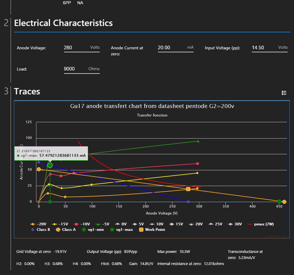

In order to propose usable tubes datas available at all, I have created a website to store tubes datas and curves.
The site is hosted at the following address:
tct-home
From this site you can:
• Search a tube by name or electrical characteristics
• Add new tubes
• Attach document to each tube and visualize it.
• Create graphs (Va / Ia) with mouse as those in the datasheet. And this from an image extracted from the PDF datasheet.
• Add on these graphic an example of usage (load line, SE / PP, class A + B) and obtain the theoretical values ​​open loop distortion, pmax, gain, etc ...
• Move the operating point, load line and the deflection the mouse and see the effect on the settings, and search a working point for the point of theoretical minimum distortion.

not happy on my laptop running chrome browser on Win10.
Page loads but nothing happens.
Edit: Same in IE11. The search dialog is here but hitting the search icon produces nothing. Same with News and Advanced Search buttons.
Hello aardvarkash10.
Thanks for return. I have accessed to the website (hosted in switzerland) from a New Zeeland proxy and effectivelly I get some time out error. Welcome in the real life (for me). Il will revisit all my request timeout and republish until tomorrow a version that hope is working for you.
The best browser for the speed is chrome, If you get always an error tomorrow, please press F12 to open the chrome console and reload the page with the console opened. If you can read some erroRs in the console window, please send me a copy by mp. Thank you very much for your help.

Hello
You can do that, but in edition, and you need to be authenticated for that. You can also save your values/usages in your private area, and only you will see the changes.
Note that Firefox is very lagy in SVG and is better to use Chrome for this fonctionality (Move load lines, bias point and voltage limits)
