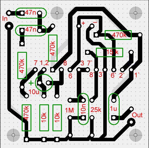

i changed the two input couplage caps to 47n and the output couplage cap to 1uf , and use it before pre ,
it didn t work !
any idea ???????

i mean it doesn t work correctly 😛 ...
it s a very loud sawtooth or square wave around 80/100 hz ( i m not sure bout the wave and freq , i don have a scope ) comin out of it , but when i turn the 2nd pot (25k) all the way down the noise become silence suddenly , i connected my signal generator to it , very very little pulsin sound come out of it !!!

+ and - inputs reverse ? no ...
i checked all the wires and pcb again and again ,, no error i think ,,, any idea ?
Ummm, what else can cause this... transistor in backwards or one that's leaky, R/C time constant too short (getting FB through the LED/LDR), which can also happen with correct R/C if the LDR is in the wrong spot in the circuit and finally, the 3900 is a hi-Z device - incorrect wire dressing wreaking havoc.
no man ! i m talkin bout the valve comp/limiter schematic i sent , i built it , ...transistor in backwards or one that's leaky, R/C time constant too short (getting FB through the LED/LDR),
here s the pcb , maybe i make a mistake and didn t seen it 🙁

Then what you're describing is powersupply ripple. It needs a superclean supply and good decoupling.
Just wondering?, why make a PCB and then not mount the valve holders on it? - it seems rather a waste of time?. If you're mounting the valve holders on a chassis, why not hand wire them? - in classical valve fashion (particularly for something as simple as this).

cuz it s just a test pcb , i ll built preamp,comp and tone control on one pcb ...
and u said hand wired .. does it make more noise ???
and is my problem is my power supply ?

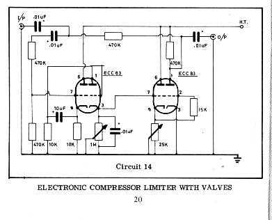

Hello.
I am also a novice in building with tubes.
I am trying to build the compressor based on the schematics mr Ahmad supplied us with here in this thread.
I have a couple of questions.
1. On the original schematics ground is marked and this is the negative point I guess.
Another point marked "HT" is at the top right.
I guess
this is where the positive feed to the circuit is to be placed. How much in voltage/ampere is the circuit operating on. Is it 220V=, 220V~ or just the heater current 6.3 V~?
2. Can I use just one transformer 6.3 V~ on pin 4+5 and 9 on both tubes?
3. What kind of resistors is to be used? Metallfilm for low noise or common carbon types. Or is the effect so big that I have to use effect resistors?
Anyone who knows about this please reply and you will help me out alot.
Thank you, All the best/Fredrik E.
P.s. I attached the schematics here again. Thanks.

Tube Compressor **CIRCUIT 14 DIAGRAM**
Hello,
I am a novice in building tube compressors, or anything derived from schematic diagrams for that matter. I searched on the internet for shematics and I came accorss the same diagram as those you have been building.
I was wondering:
1) what voltage do the capacitors need to be?
2) How strong the voltage of the transformer should be?
Also I have never built anything electronic from scratch, so I have no knowledge of AC or DC, regarding how they operate, so I was wondering what would be easier and produce the best sound? the least amount of hum. Any information would be of great help. Thanks.

Ahmad_tbp said:hi
i m wanted to start building a tube compressor for my bass guitar , i found a compressor schematic with two ecc83 , but it seems it s too old ,and i confused bout the pin connection in first tube , it seems somebody draw it after the original schematic , can anybody tell me , are pin2 and pin1 directly connected to together on first tube ? ( i shown it with a red line around it )
sorry i didn t remember the original link of schematic and the image has no info or copyright on it so i attached the photo ,...
--any idea for another compressor ? any mods ?
