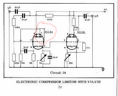

i m wanted to start building a tube compressor for my bass guitar , i found a compressor schematic with two ecc83 , but it seems it s too old ,and i confused bout the pin connection in first tube , it seems somebody draw it after the original schematic , can anybody tell me , are pin2 and pin1 directly connected to together on first tube ? ( i shown it with a red line around it )

Yes, they are joined together - the first stage is an AC triode amplifier, the second is strapped as a diode to rectify the signal level. The DC output from this rectifier is fed to the next triode as a DC amplifier, the DC output from that is used to bias the final triode, which is used as a variable resistor - making a variable attenuator in conjunction with the 470K.

Assuming the preamp has a high input impedance?, designed for a passive bass - obviously it's designed to feed a valve preamp, but a high impedance solid state one will be fine.
Don't know how well it will work?, and personally I don't see the point in doing it using valves - and it's somewhat cruder than solid state ones (for example only using a half wave rectifier).
