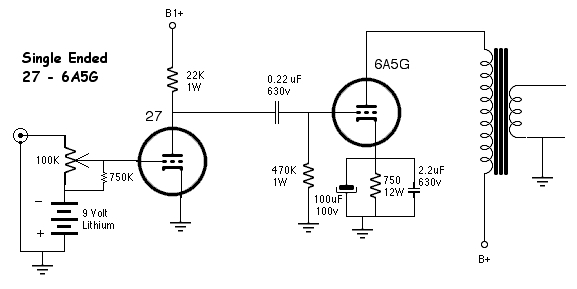

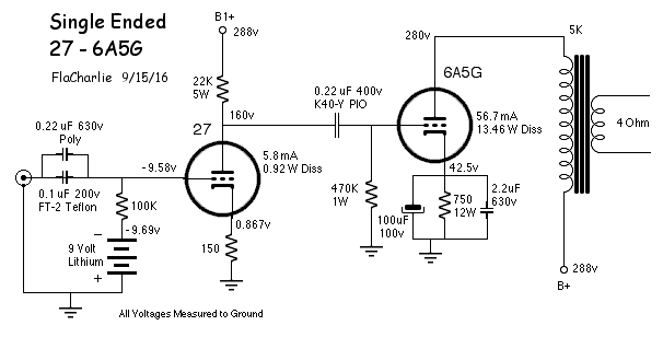

Without a coupling cap you'll send 9V into your source. Put the battery between the pot wiper and grid instead.
Fortunately I have a couple of older Macs that work well, when needed.
I too have some old Macs i use to run old software that i find irreplaceable.
dave
Ooops, posted an earlier version. I ended up removing the volume pot. This is the current configuration, which was suggested to me by Eli Duttman. I've been using it with a Fisher 100-T preamp / tuner but I plan to build a very simple tube preamp at some point. Tubes under consideration are 37, 2C22, and maybe 6V6 in triode.
