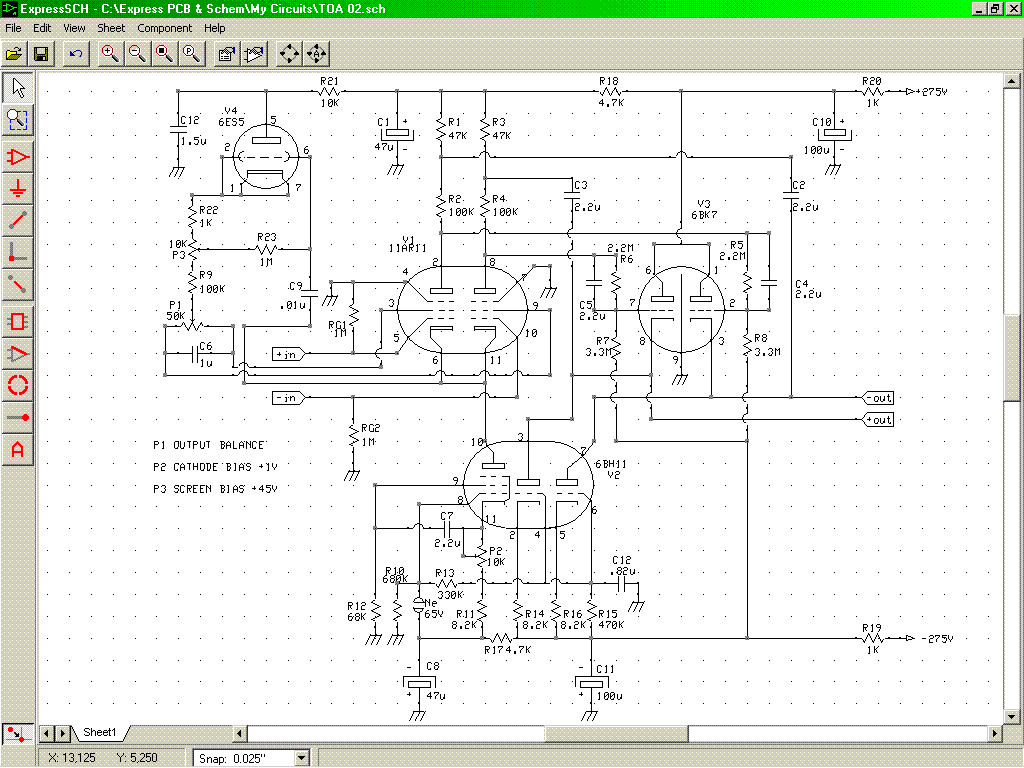

I added my own valve symbols to the PCBCAD software I wrote myself PCBCAD720.
It has the flexibility to look like how I want it.

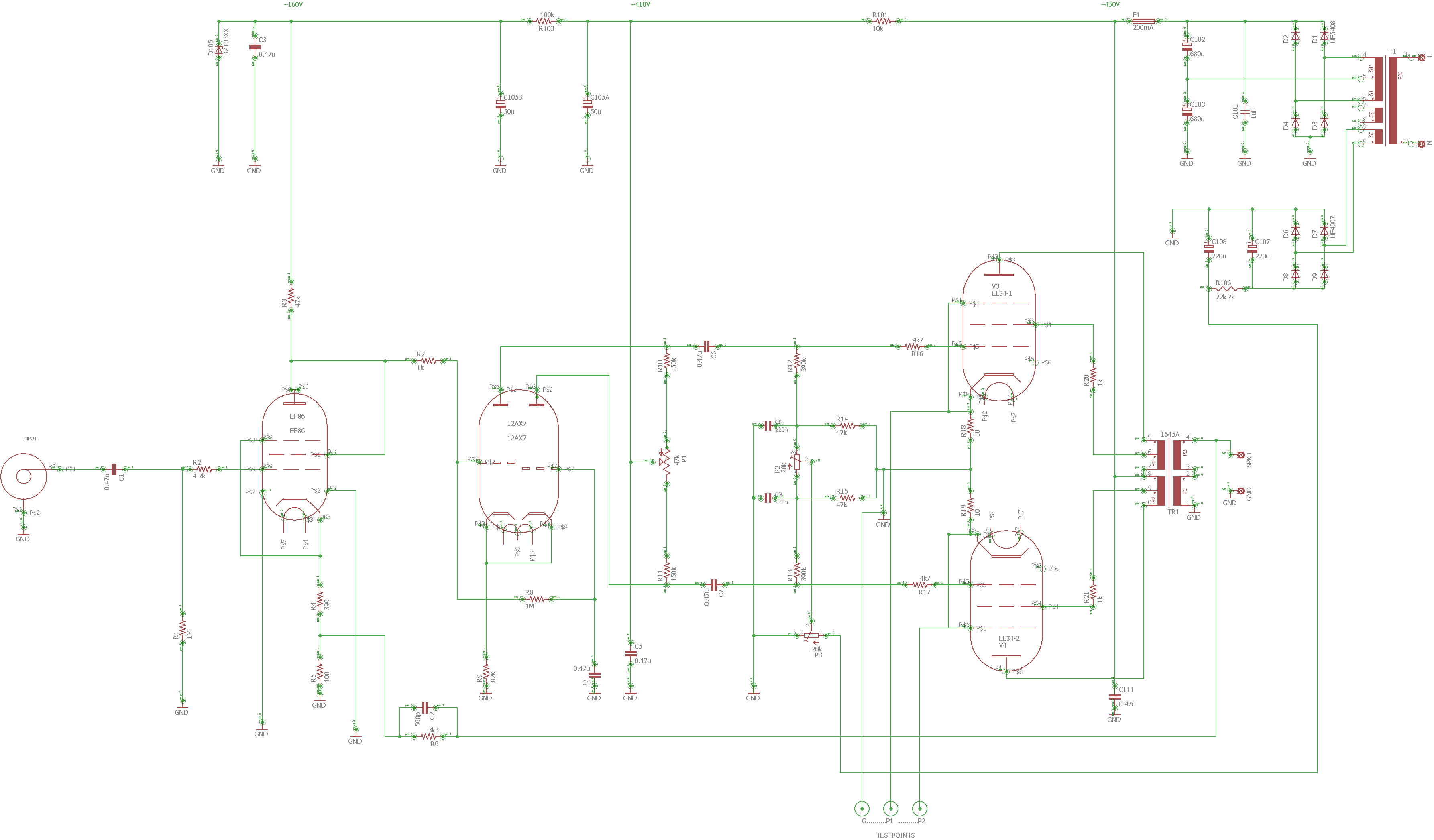

That makes sense, yes. Basic principle: break up large circuits in understandable parts if you would need more than a single sheet to fit it on.
It's more work for you, but if you want to show it to others and get meaningful comments (not 'hey that looks great' , that's is a waste of your time), put yourself in the shoes of someone who sees it for the first time. IF they want to give meaningful comments, they will need some time to understand what the f*ck you are doing ;-)
Take it from someone who published 100's of articles and had to field lots of reader questions.

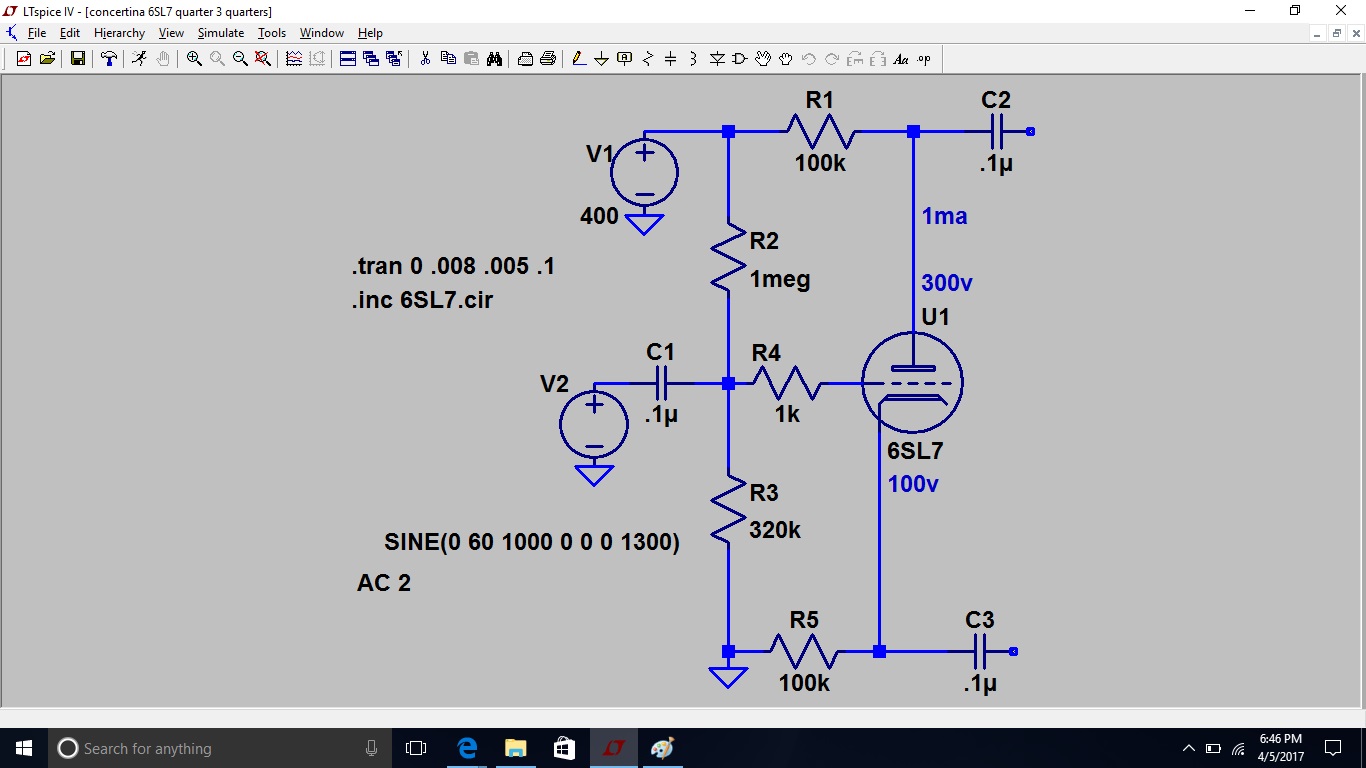

Sims will get you in the same (big) ball park, but I know that the ltspice models differ from other load-line calculator and all of those differ from each individual tube section (ie each triode/pentode).
LTspice is easy-ish to use and it's interactive. There are tube models (go into components and search for triode) but the mapping between models, symbols and things from the web that fill the missing gaps are all part of the ltspice learning experience.

Playing around with ltspice as im keen to try simulating the circuit.
Ive got the tube models and symbols, but cant for the hell of me find how you add them to the toolbar to insert!
Also got all the *.inc files for the different tube types but not sure what folder these are supposed to go into.

I use the Mac version but for that only the “standard” files in the diode/jet/etc directory files are put under the component selector. For other models, you will need to use control+click to bring up the properties table, change the type to X and then add the model name to the property (spice line iirc). That tells LTSpice what model to use out of the .inc .lib files.
