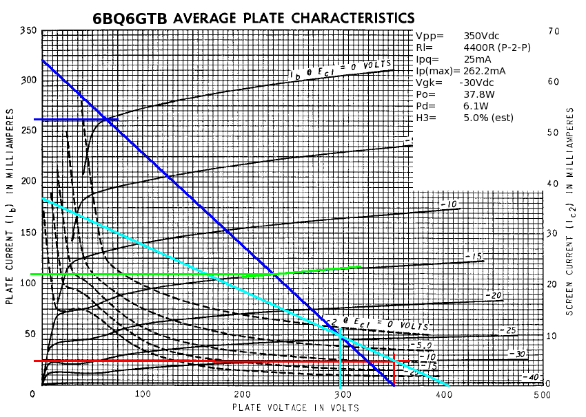

In my experience, the 6/12/25-BQ6 sounds great. The A Number One problem with the 6BQ6, and the reason why the spec sheet makes no mention of any audio applications is that you can't use 'em as SE finals. The plate characteristics (attached) show that the most linear part of the characteristics are well within red plate territory. Of course, you could drop the screen voltage, but you lose lotsawatts by doing so. The 6BQ6 is best run as a PP, Class AB1 final to stay in the most linear regions. That's also true of other TV HD finals.
As for sonic performance, the 6BQ6 is like the famous 6V6, only capable of much more output. If you do some spec busting, and increase the IPQ to 50mA (PD= 17.5W v. 11W rated) you can reduce the THD and improve the sonic performance. Being that these TV HD types were designed to run at full RMS continuously, the rating is very conservative. Since audio is far from "brick on the key" operation, you can get away with spec busting without compromising life.
The Twin-T test shows mainly h3 with a trace of higher order harmonics, so you don't get that pentode nastiness at least until you're close to clipping. All you need is just enough gNFB to take the edge off. The 'DQ6 probably operates similarly.
