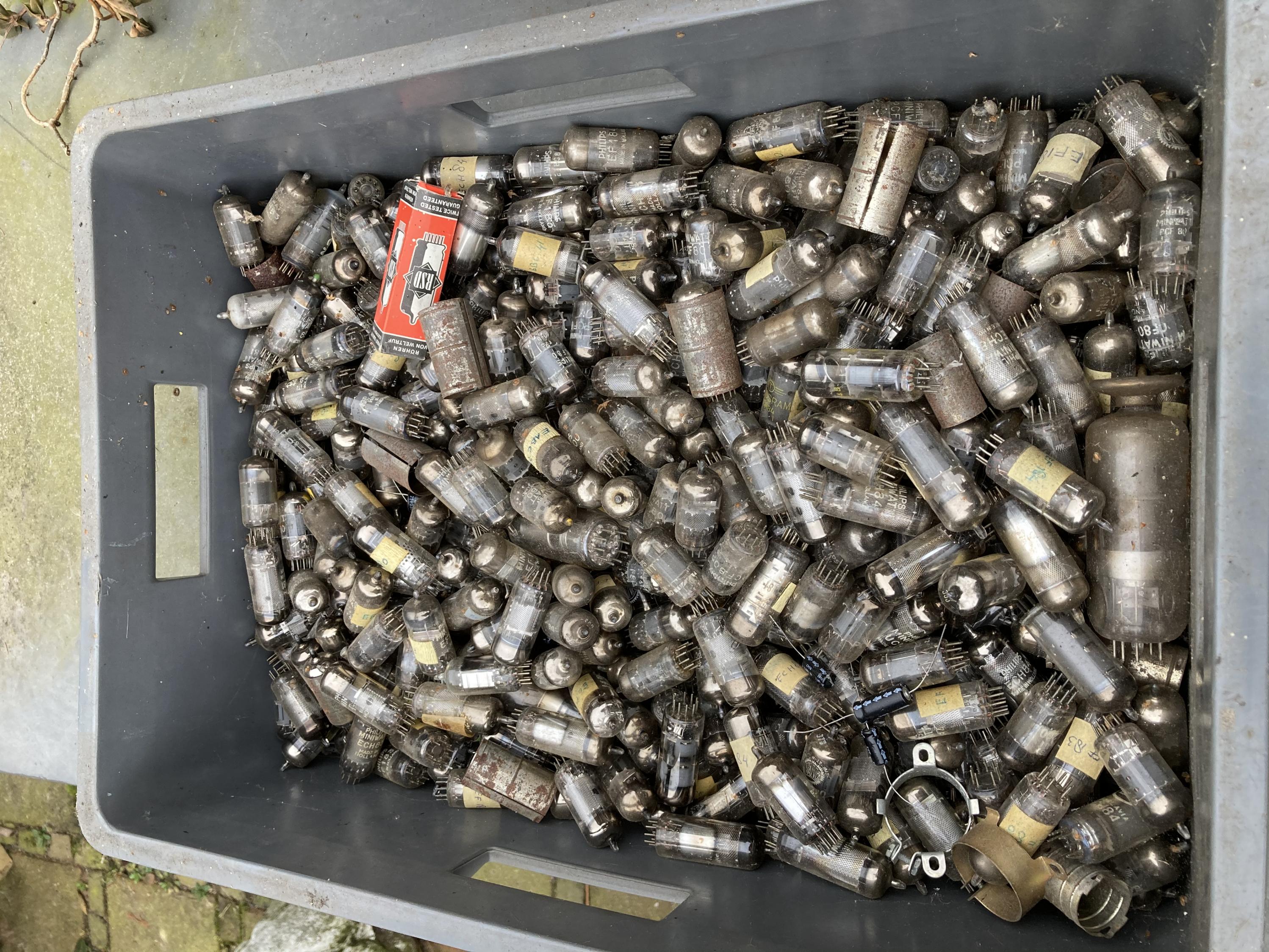

To make sure no tube rolling is required in the amps i build, i use television tubes. No hype (yet) about those....
I sometimes need to repair microphones, these require very low noise tubes, so here i will roll some tubes but not by brand. I found however that the russian tubes are very good in this respect, better then most "hyped" Siemens or Telefunken gold pins etc.
So it is up to you to change hobby or not.
Best regards. Frank
