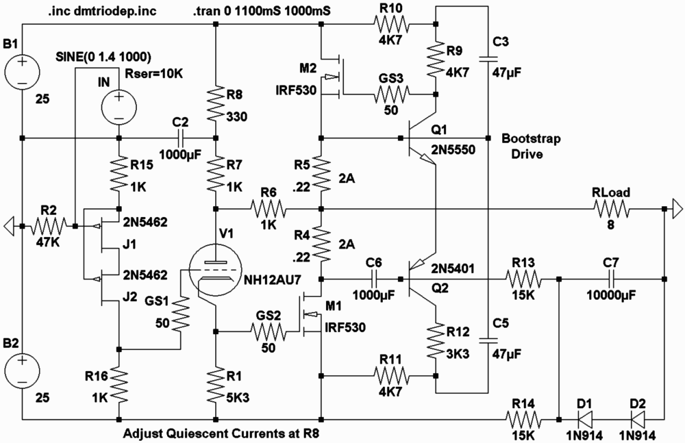

An old simulation I messed with about a year ago and never built.
Keeping 6DJ8 plate above 12V essential, else grid leaks too much.
90V would indeed be better, but maybe get away with a lot less?
Here the triode is abused in plate to cathode 1/(Mu-1) feedback.
First, input to plate is divided 50% to the B+ rail. Not for fake "UL",
nor for doubling Mu gain, but merely to keep that plate well above
serious grid leakage.
The lower IRF530 is setup up as a Triodlington, and the upper 530
is set up as an Aleph/Anti-triode current sink. The BJTs on the far
right maintain bias, and the diodes below are for correcting offset.
JFET cascode on the left is not cause the grid is expected to leak.
The intent was to flip a common GND reference down to the B-rail.
1K vs 1K, set up just like a unity gain concertina splitter, but only
utilizing the inverted output... Not intended to "split" anything...
All sand here are restricted by local feedback to unity voltage gain.
Except the Triodlington, which I guess the 50% UL feedback allows
a gain of 2x(Mu-1).
  • ULAsh.zip
    ULAsh.zip

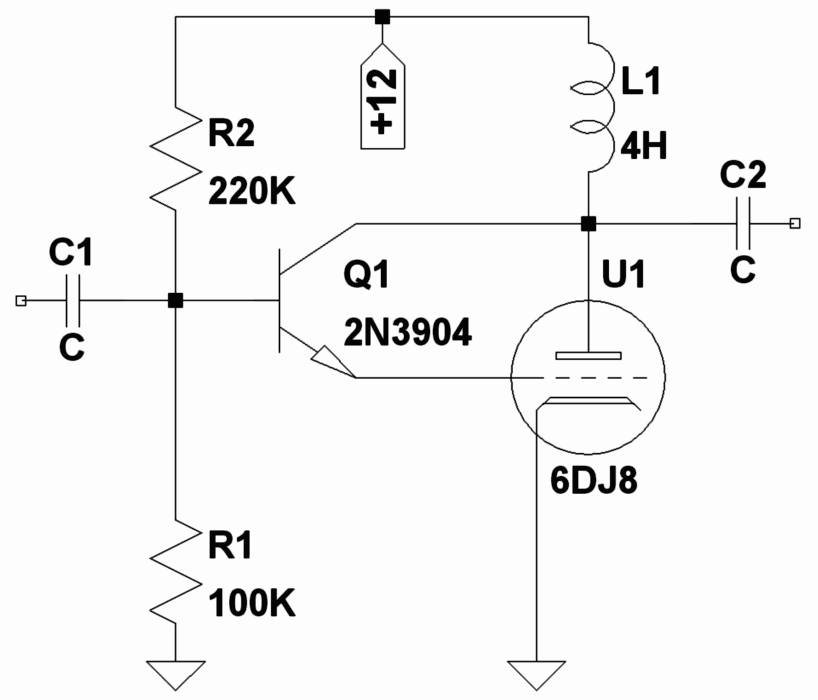

No longer related to schematic above...
If one were to operate 6DJ8 below 12V plate?
Leakage is assured. Probably only A2 operation
is possible. But if you allow an emitter follower
to drive the grid into A2, and ground cathode,
and apply constant current to plate. Maybe,
just maybe, you could still have a linear Mu.
Which gives linear Mu? Constant plate current,
or constant cathode current? Cause in severe
A2, these currents won't exactly match.
My guess is that constant mu needs constant cathode current, as it is the cathode current which is determined by the net electric field seen at the cathode. The grid current will steal (nonlinearly) some of this. However, there could be a small amount of cancellation if mu increases with current at the same rate as the grid steals it. But why design a line amp which needs an input buffer?
L1 might be bootstrapped gyrator, ccs, or whatever...
The question: Now is cathode current a constant?
Let us assume a grid leak so severe, Q1 never off.
Does Mu work as intended (in fulltime A2) or not?
Yes, thats +3.3V on the grid...
I'm asking, not saying. I don't know if this is plausible
work of science fiction, or just plain nuts???

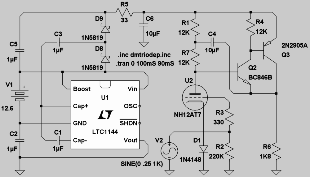

LTC1144 with minimal supporting parts (2x shottky diodes, 3x 1uF caps)
seems able to simultaneously upconvert +18V supply to +35.4 and -18.
With pin1 tied high, the frequency should be 100KHz (50KHz ripple out).
Just my interpretation of the spec sheet, could be completely wrong...
But looks like could supply a small signal triode or two.
LT1144 spec sheet does not show the combined doubler and inverter
application, look to lower voltage and frequency (but otherwise same)
ICL7660 and MAX1044 spec sheets and app notes.
This device is a cheap 8pin DIP inductorless capacitive charge pump.
+12.6V would convert to +25 / -12.6 ?
My knowledge, is it fixed yet???
This is voltage tripler described above, except I had severe PSRR probs
with the negative supply, so I chose to ground the negative rail instead.
Means the heater now floats a few volts above ground, not a bad thing.
The plate load needs explaining: I have an emitter follower bootstrapped
back to provide CCS , hold the tube's loadline flat on Mu , hold cathode
bias diode at constant current too. This is both output buffer and main
power supply filter. Anyways, Q2's emitter following the plate is held at
constant current (and thus constant voltage drop) by action of Q3. I
chose Sziklai rather than Darlington. Specifically so the emitter of Q3
(which is not at constant current) would not have funky voltage drop
in series with the clean emitter controlling the following action.
Considering both the tripler and the bootstrap, I see 36V rail, and the
strap can actually swing a little above that, up to about 40V in total.
Linearity of the tube don't seem bothered by the low voltage, as long
as I am forcing a constant current loadline, Mu is still in full control.
You also need Duncan Amps "dmtriodep.inc" for NH12AT7 triode model.
NH meaning "No heater".
My currents are biased to the limit of 1/2W this chip can dissipate.
Taking them any further might let the magic blue smoke out.
Let us assume a 12.6VDC isolated wall wart that won't be bothered
to float slightly (another 12.6V) above GND for the heater supply.
