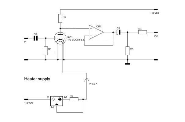

Tube can work in low volt~~fix your knowledge
As we know tube are work in high volt.
but in this circuit tube are work in low volt.
and work in linear.

Yes, it can work at lower voltages.
But distortion is of course much much higher.
By using an EMITTER Resistor on the tube, you can try lower current.
The lower the current, the less distortion.
Higher EMITTER resistance - lower current - lower distortion.
What is good with your circuit is the use of OP-Amp as load.
Tubes want very light loads. And have difficulty with heavier loads.
Op-Amp, especially with JFET input (like OPA2134) is practically no load at all.
So, that's perfect :)
That circuit is likely to have significant grid current, so needs feeding from a low impedance source. The op-amp may offer practically no load, but there is still an anode resistor so not perfect. It is not necessarily true that the lower the current, the less distortion.
This circuit neatly combines two issues: a poorly biassed valve, and an op-amp with high levels of feedback. So you get lots of low-order distortion from the first and (allegedly) lots of high-order distortion from the second. And almost no headroom!

in this circuit tube is a typical common cathode amplifier.OP is a buffer.
If it has the less distortion we can use an oscillosc to test it.
but I do not see any distortion in it. ( maybe it is very low )

Loooking at the circuit at hand,
we have Tube, which will induce some distortion. No doubt.
The Op-Amp we can say will produce zero dist. No distortion.
As a follower there is practically no THD at all.
SUM: We will hear the TUBE.
If there is any contribution, alteration to the input signal
it is coming from the TUBE.
If you see no distortion with an oscilloscope all it means is that distortion is less than a few %, not necessarily low. I was not saying that you light it up with LEDS, but some people do.
Unless you like listening to distortion you would probably do better to remove the valve and just use the op-amp to get the gain you need. If you want to use a valve then do it properly with a higher supply voltage.

I setup a test.
Using 6DJ8 which is similar to ECC88 and OPA134 which is a great opamp for audio.
With 3k loading the current is ~ 1 mA give opamp like 9 Volt at input.
(Using 4.7k give around 8 Volt and a gain of ~12)
The gain with input signal 100 mV is just below 10.
(985 mV out).
I test distortion BEFORE and AFTER the opamp.
At the input and att the output = load.
The load is one 300 Ohm Headphone. This does not bother OPA134.
Because the Tube generated distortion before OpAmp is: 2.84%
And after the Opamp it is still: 2.84%
In other words, the contribution of distortion from Opamp
is so small we can simply ignore it.
And as there has to be a distortion in order to effect sound signal,
we can conclude we will be listening to music + tube.
The opamp is there, but it is 99.9% transparent.

The schematic I designed and posted works with little distortion, it was designed as an experiment to see if a valve could work at 12v and produce a reasonably neutral sound.
--I was not looking to make distortion!
As a low volts pre-amp with a little gain it worked well. I was not looking for 'tube effects'
Gawd knows what the 'Tubaliser' was supposed to achieve....
Sure your circuit works at 12volts. But you have zip dynamic range, will draw grid current (at which point the dist goes way up), and even small signals give you high amounts of 2nd Hs. So you have built a circuit which will sound very sweet at low levels, but not a HiFi low distortion circuit.
