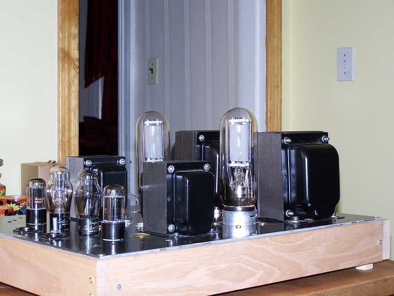

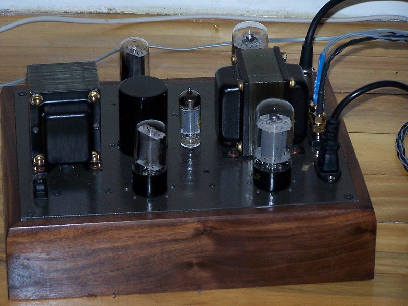

Beautiful top plates can and should be done... However, you will spend epic amounts of weekends gathering measurements, creating cut-out macros and suffering over the layout in the CAD tool. First photo is an 845 SE amp of mine, my first top plate - lots of time spend measuring everything, printing out parts of it on paper to make sure holes line up. Took a year to get there. Second photo is a Lynn Olson Amity Clone mini-monoblock. Same CAD tool and Front Panel Express, took a month to layout. Third photo is a top plate I designed for my cabinet maker friend who helped me out with woodworking, took a weekend to layout. None of these top plates cost more than $200 in mill fees - and it was all done by uploading files to a mail order CNC milling shop!
