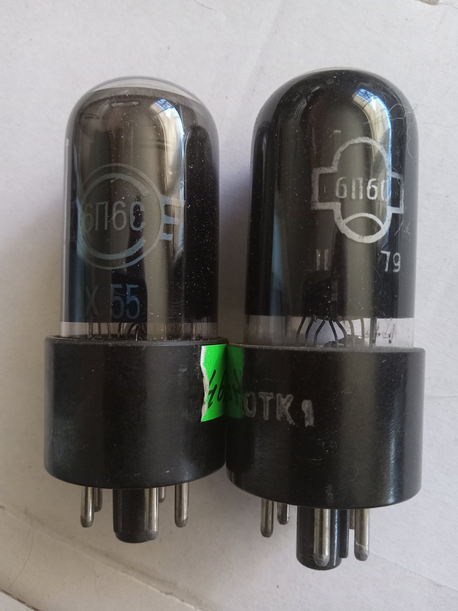

That said in my HK A-300 amplifiers Svetlana 6P6S sound far superior to Reflector tubes.View attachment 1396012
Do they bias the same, and display similar voltages? Because I don't think 5 or 10 plate volts, or a couple of milliamps difference in standing current, accounts for how different two tubes can sound in the same circuit.
A300 has a unique design in which all 4 output tube cathodes are tied together and connected to ground via a string of two 12AX7 heaters, giving auto bias of about -25 V and idle current of about 35 mA per tube. This requires matched quads. Getting two quads that bias exactly the same would be pretty difficult. So no, I cannot claim that Svetlanas are generally better than Reflectors.
Also, Svetlanas have military acceptance stamp, and Reflectors are consumer grade.
Well, "sounding far superior" would certainly be an important criterion to me! ;-) Assuming they are NOS and operating roughly within the parameters of the circuit, it sounds like they are better tubes. Of course, longenvity, reliability and other factors are important. But I trust you when you say they sound better!
OTOH, I'm perfectly willing to grant that a lot people buy what they believe are good tubes, but have no way to properly test them or even measure their performance in the circuit. Then all bets are off, as they say. We've all seen someone say something like, "These used Telefunkens I bought are warm and syrupy," having no idea that the emissions are weak or the Gm is well below spec. So obviously, when swapping tubes, it's important to know what you have before you make a judgement call.
It is also about tradition and pride of craftsmanship. Svetlana factory was founded more than 100 years ago in St. Petersburg that was at the time technological and cultural capital of the country. Reflector is in Saratov, a remote province where people didn't care. Just look at their sloppy silkscreen.
Moscow Electro Lamp Works (MELZ/Foton) is another highly reputed manufacturer. MELZ 6N8S (equivalent of 6SN7) currently goes for about $100 apiece, while Reflector one is about $5.
