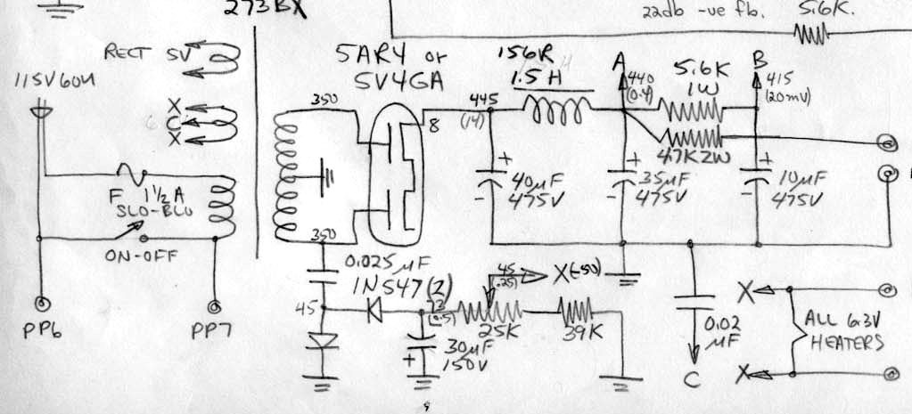

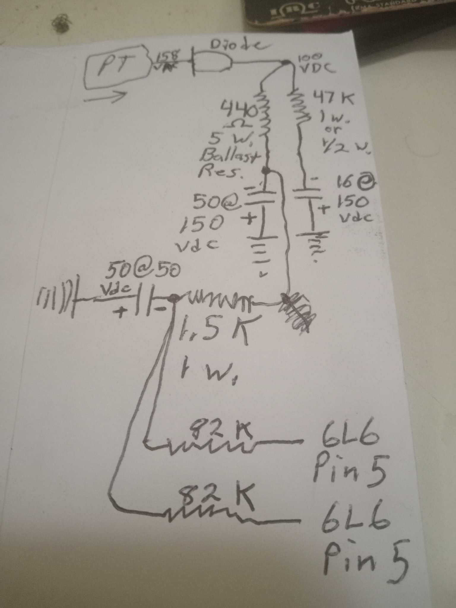

Here's a homemade writing diagram of the Bias section from The PT to the grounds to the tubes.
How about a photo of the whole underside of the chassis - clear and big as you can make it and still post here.Here's a homemade writing diagram of the Bias section from The PT to the grounds to the tubes.

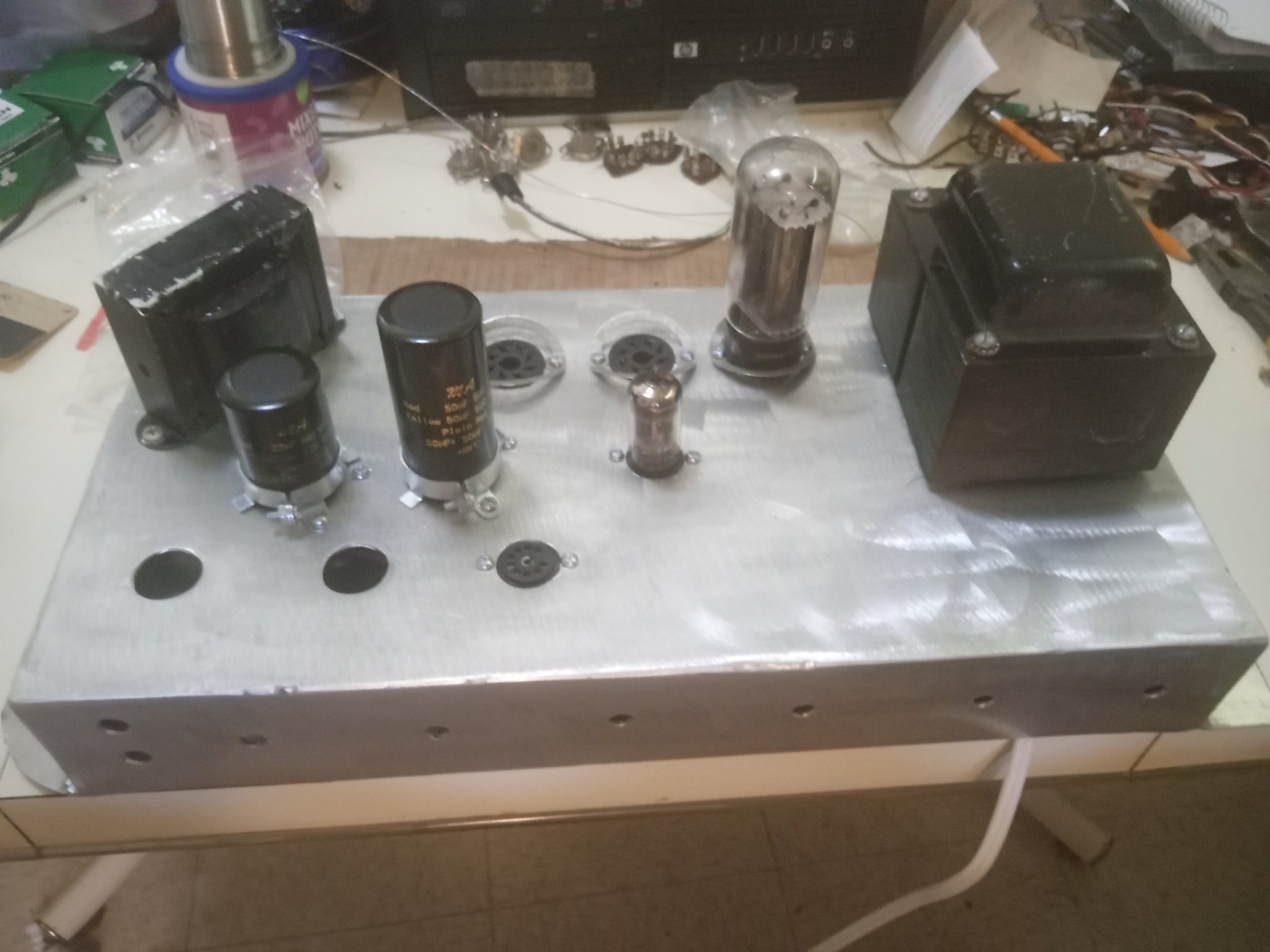

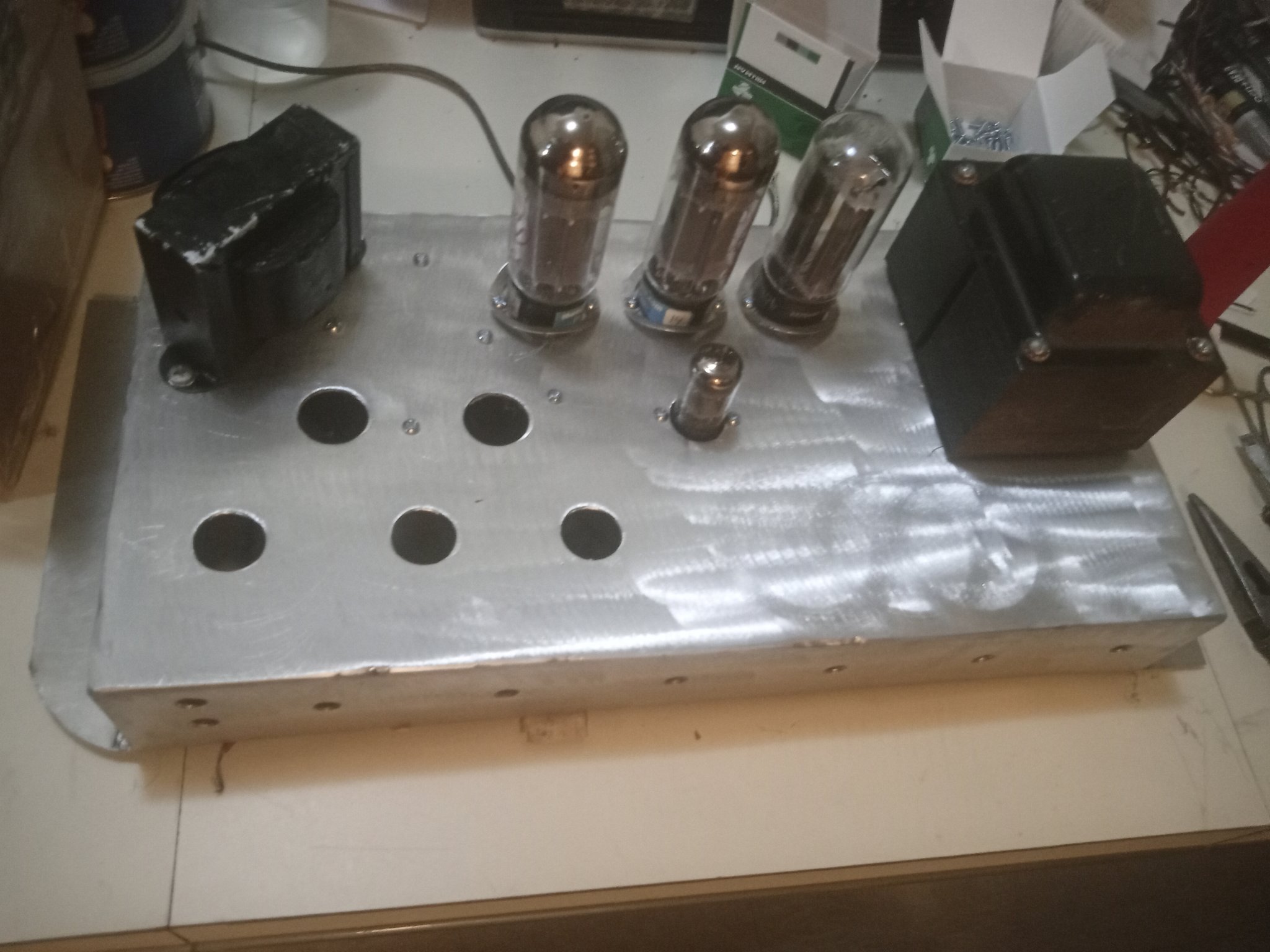

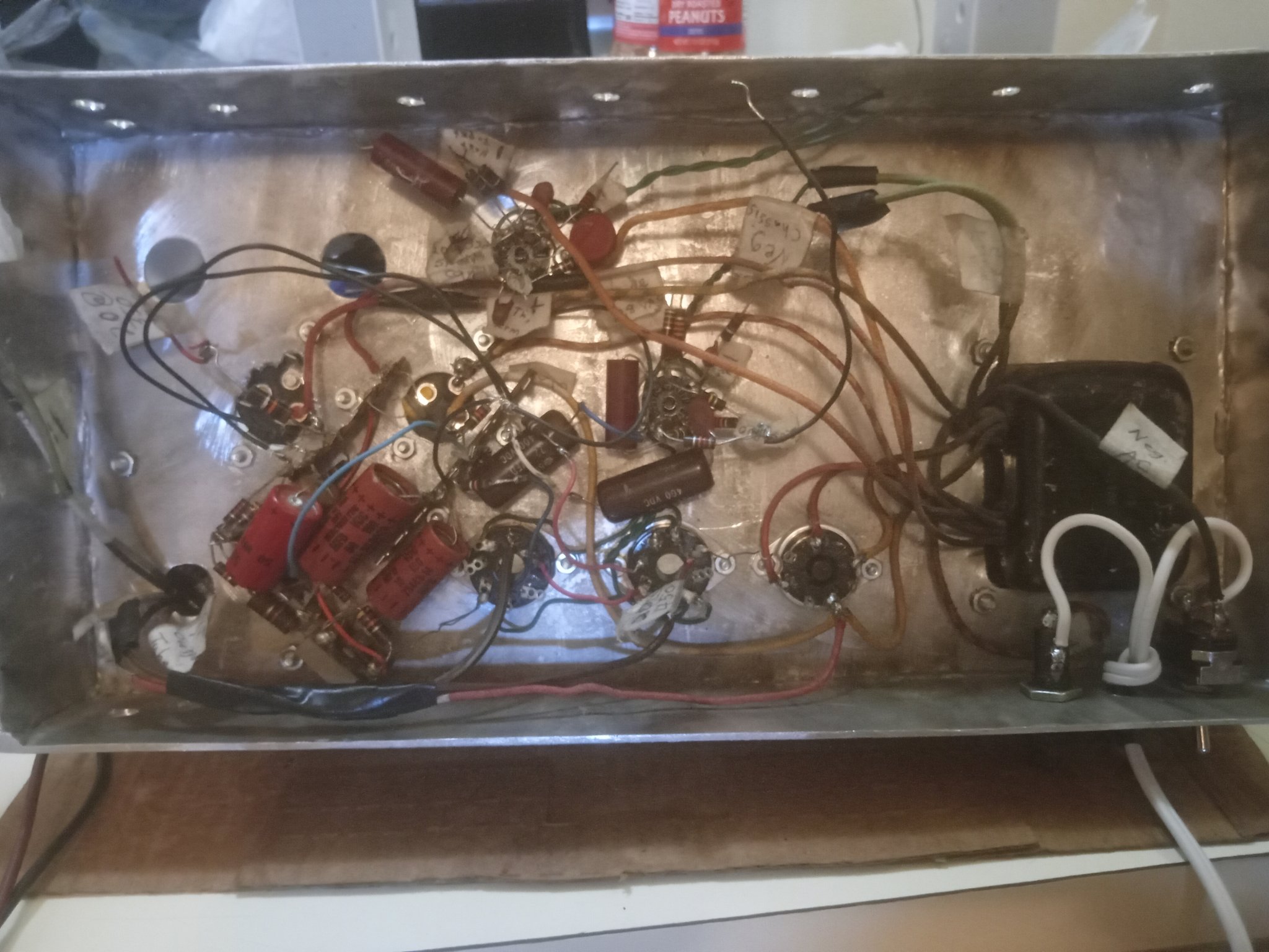

It's not all together yet I'm waiting for A bunch of parts, Let me finish putting it together and then I will take another voltage reading and some pictures. But here's a few pictures of the project. Thanks for All of you helping me figure out what Was going on with The negative Bias. It's a big relief knowing that it is working properly. Now I can keep wiring things up. I'm a little bit rusty been a Few years since I did this. Thanks Again !
OK I see what you did there - I was somehow assuming the original chassis / wiring! Nice project.

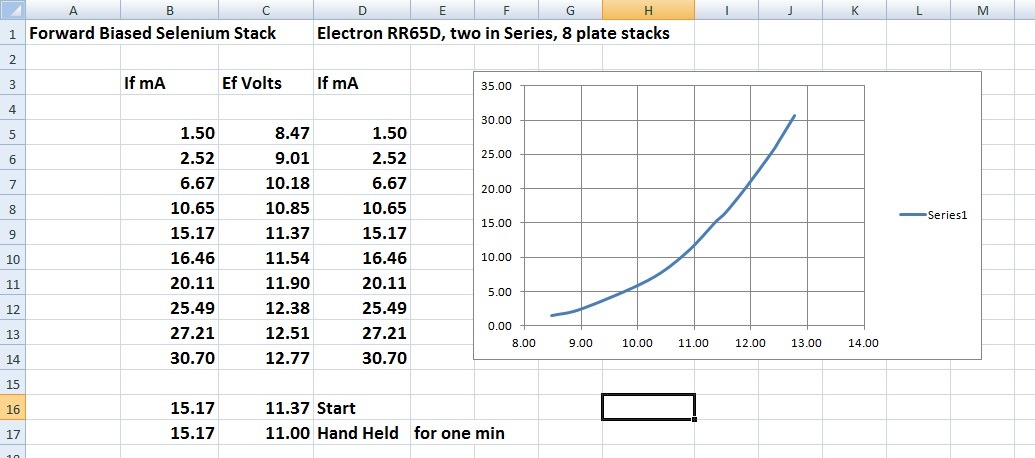

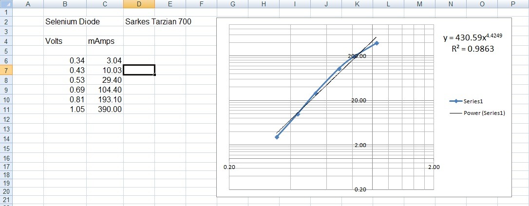

A Sarkes-Tarzian 700 single Disc Selenium Diode showing forward Bias drop on an XL plot I did several years ago.
The curve fits well with Square Law, typical of solid state diodes.

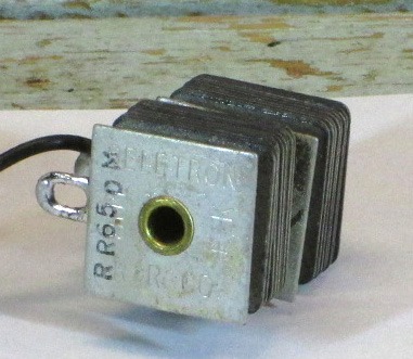

I'm wondering if this mystery rectifier is some form of a copper disc rectifier with leads attached and dip cased? Probably a short lived type if so.

Your circuit may be using the same -ve bias circuit I used, it uses 2 diodes.
The loading on the PT is symmetrical, current is pulled on both halve of the AC supply.
So no DC offset of the magnetic flux in the PT as in the other circuits.
I see in my very olde schematic of the PS I've used 1N547 Si Diodes, probably since
there were plenty in the lab. The 1N547 diode was MIL Grade in that time.

There seems to be an error in the drawing regarding the wiring of the 47k resistor.Here's a homemade writing diagram of the Bias section from The PT to the grounds to the tubes.
As shown, both the 47k as well as the 16µ cap would be useless.
The yellow diode is an International Rectifier 'Tri-sealed' model. I have one with IR marking and model 2E4, which IR catalogs from circa 1962 indicate are a 400V PIV of abt 0.25A silicon rating, and still being sold on ebay !
