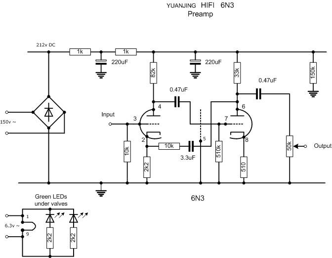

Ive just bought one of these on ebay which uses a pair of 6N3-Js.
Works well but gain is a little low. Traced out circuit shown below.
I assume that the gain is defined by 10K feedback resistor and 2k2 cathode resistor. Decreasing feedback should increase overall gain.
Circuit specified at rectified 150v for B+ supply. Will however give useful output if B+ is reduced to 50v 🙂
Just a suggestion.
Tony.

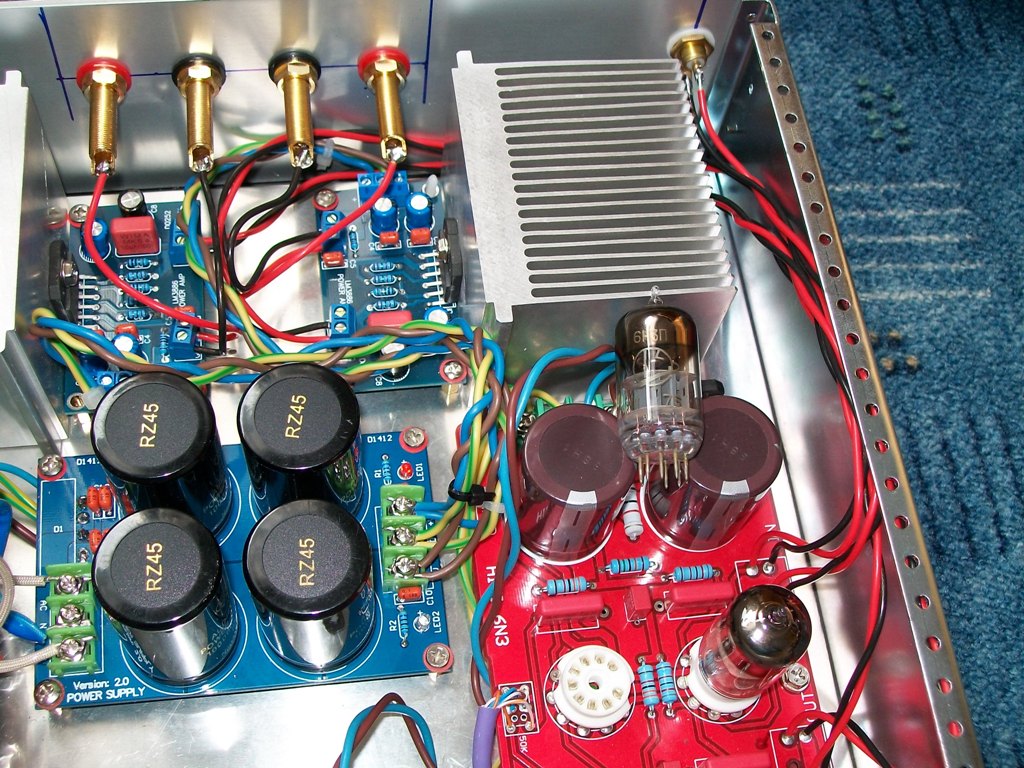

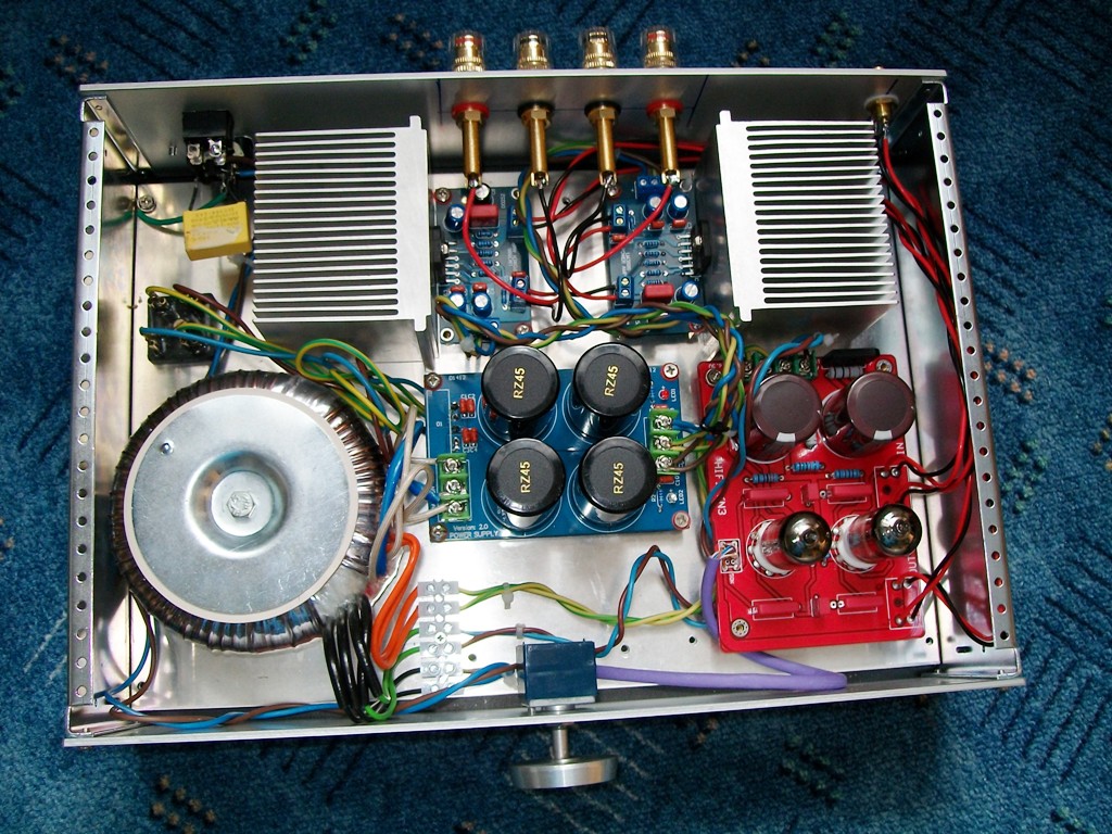

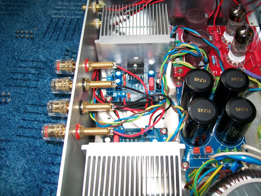

a few weeks ago I build (not yet finished):
6N3P preamp, LM3886 amp modules, ALPS pots, JantzenAudio terminals for speakers, JantzenAudio Silver cable. Sounds very good. Still working on front panel.
Next step - planning to change Wima capacitors with PIO on preamp

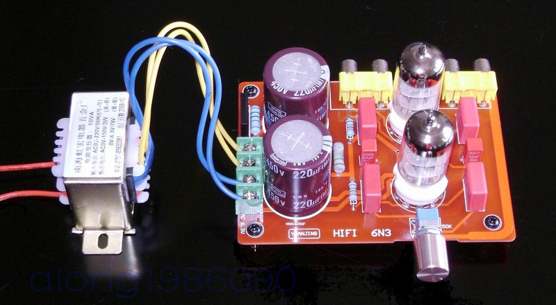

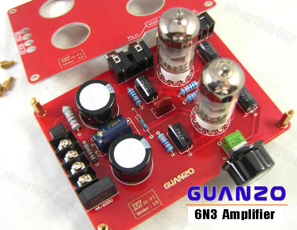

I am new to tube audio. I wanted to start with just a little pre-amp. Is this the refined version of that amp? the circuit looks similair. It does carry a slightly beefier transformer though.
I just saw this
QINPU Q-2 mini HI-FI VACUUM TUBE INTEGRATED AMPLIFIER 100% BRAND - $67.39USD : Enjoy music, enjoy hifi audio!, we sell Music Angel,qinpu,yaqin,MeiXing MingDa,Bewitch,Bada Amplifiers, CD player,power amp, preamp
Looked up the tube and got a half wave rectifier which doesn't make sense. I suspect it is a mini dual triode running a chip amp with low wattage. Pretty cool for $70.
I was looking for the tube and found the amp, and this thread. Google really is changing things.

so, you run both the chip amp and the 6n3 buffer with the same transformer? what are the specs for such transformer? and where to get one?
Please let me know
