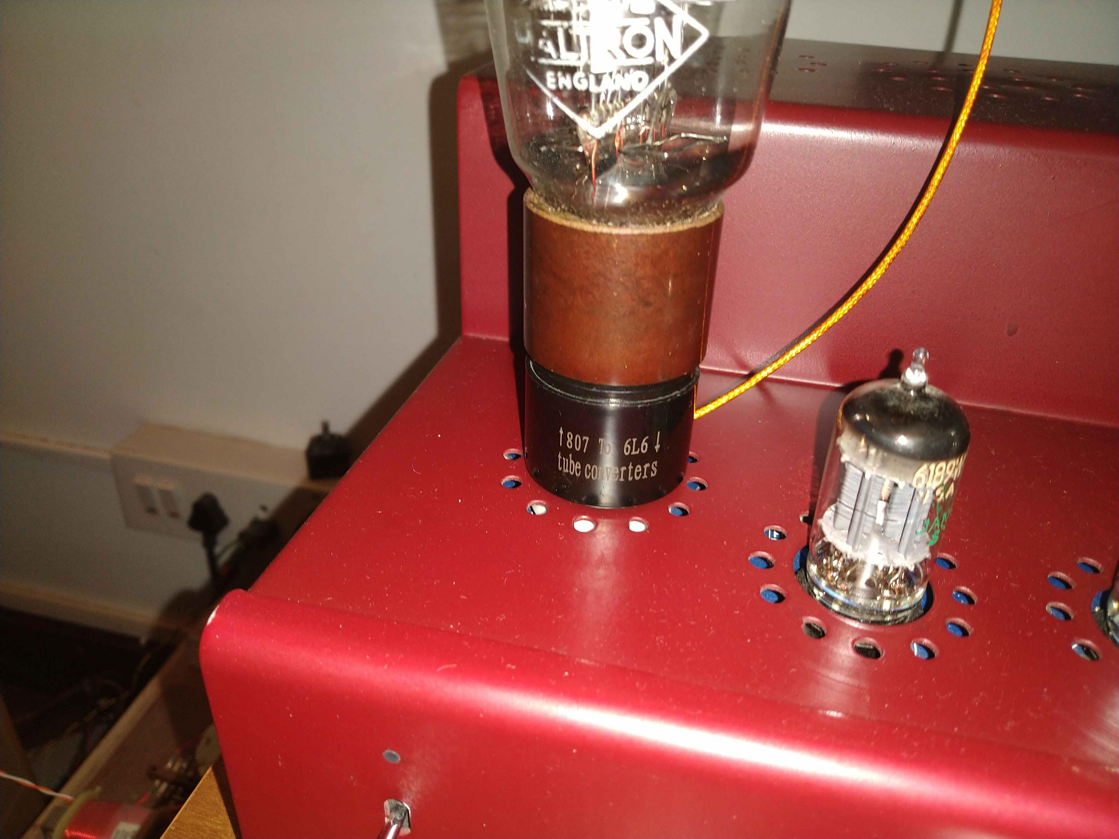

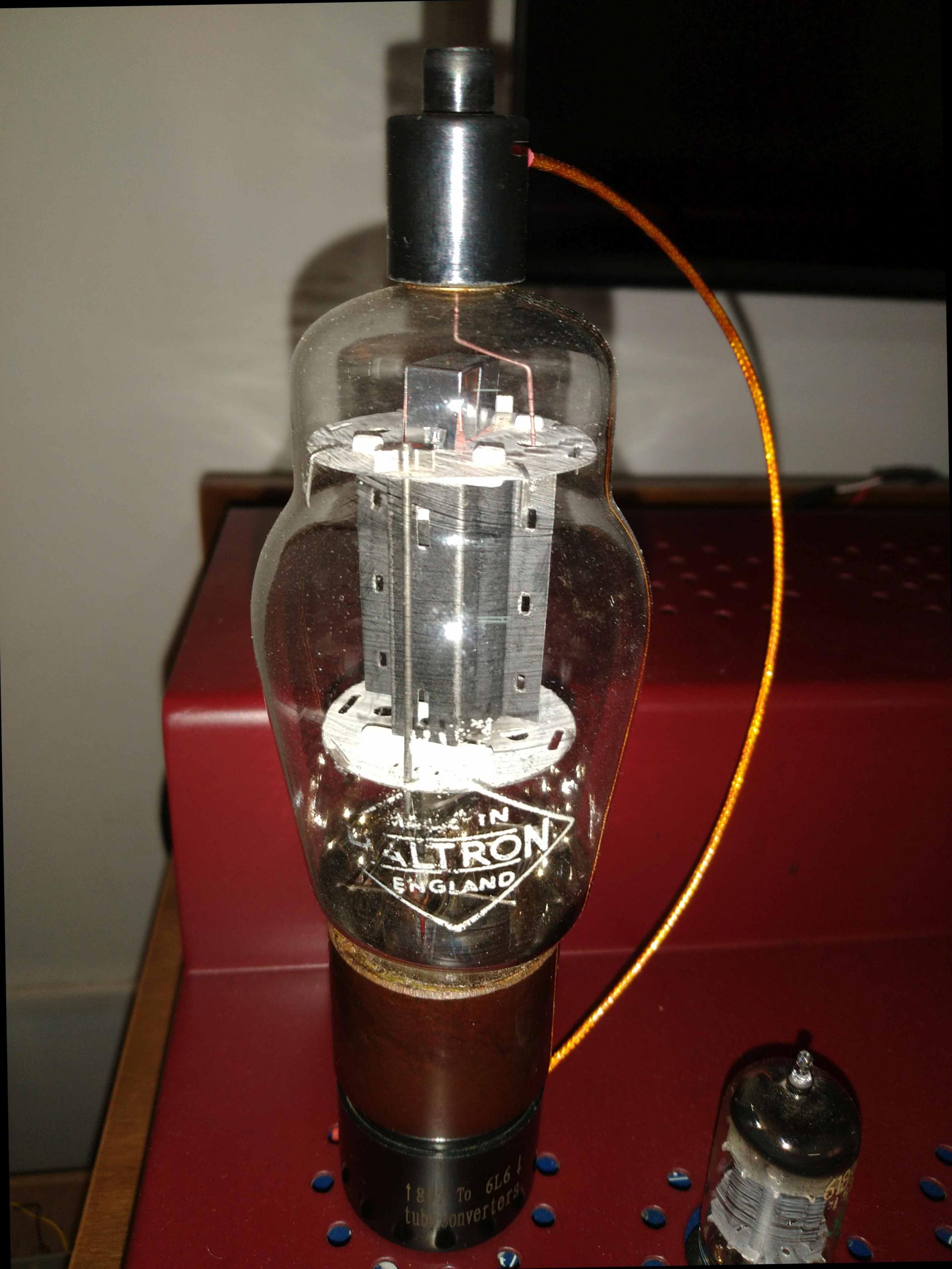

I can’t get past a very strong buzzing when I fire up the 807 tubes with adapters on this tu 8200 amp, does amp need to have a certain setting to use them? Just wondering why everyone else gets to listen to these tubes and I don’t—buzzing stays strong so I just switched it back off, and went back to 6L6. Any ideas let me know
What happens if you put back the stock 6L6GC tubes? If buzzing does not disappear then the 807 or some other tube that you tried must be defective and killed the FETs in the power supply.
Never got to the bottom of it, 6l6 tubes played well. Resold the Raytheon 807tubes with my story. I couldn’t find anyone with a tube tester in my location. Never had the guts to try another 807 in it, but now I do again… due to the nice 807 prices. Wonder if the China made adapters had anything to do with it? Is there a known good adapter to buy?What happens if you put back the stock 6L6GC tubes? If buzzing does not disappear then the 807 or some other tube that you tried must be defective and killed the FETs in the power supply.

Hello Sándor,
thank you for your answer!
Since then, I have gained several experiences:
-the Westinghouse pair begins to distort roughly at the 10 o'clock position in SE mode.
Since then, I managed to acquire wonderful Tungsram black anode pieces (3 pieces) and a "pair" of them play music perfectly, without any distortion, in SE mode, even with an extreme volume level turned up to 12 hours.
At the same time, if I replace one of the pairs for the third piece, the distortion can already be heard around 9-10 o'clock.
I've also tried the Russian G-807s, I have two pairs, a '71 and a '78, both of which hum and hum in SE mode, while these tubes also sound absolutely flawless in UL mode, even loud!
So something is "wrong" with SE mode with 807 because only my Tungrams can jump.
In UL, they are all super good.
