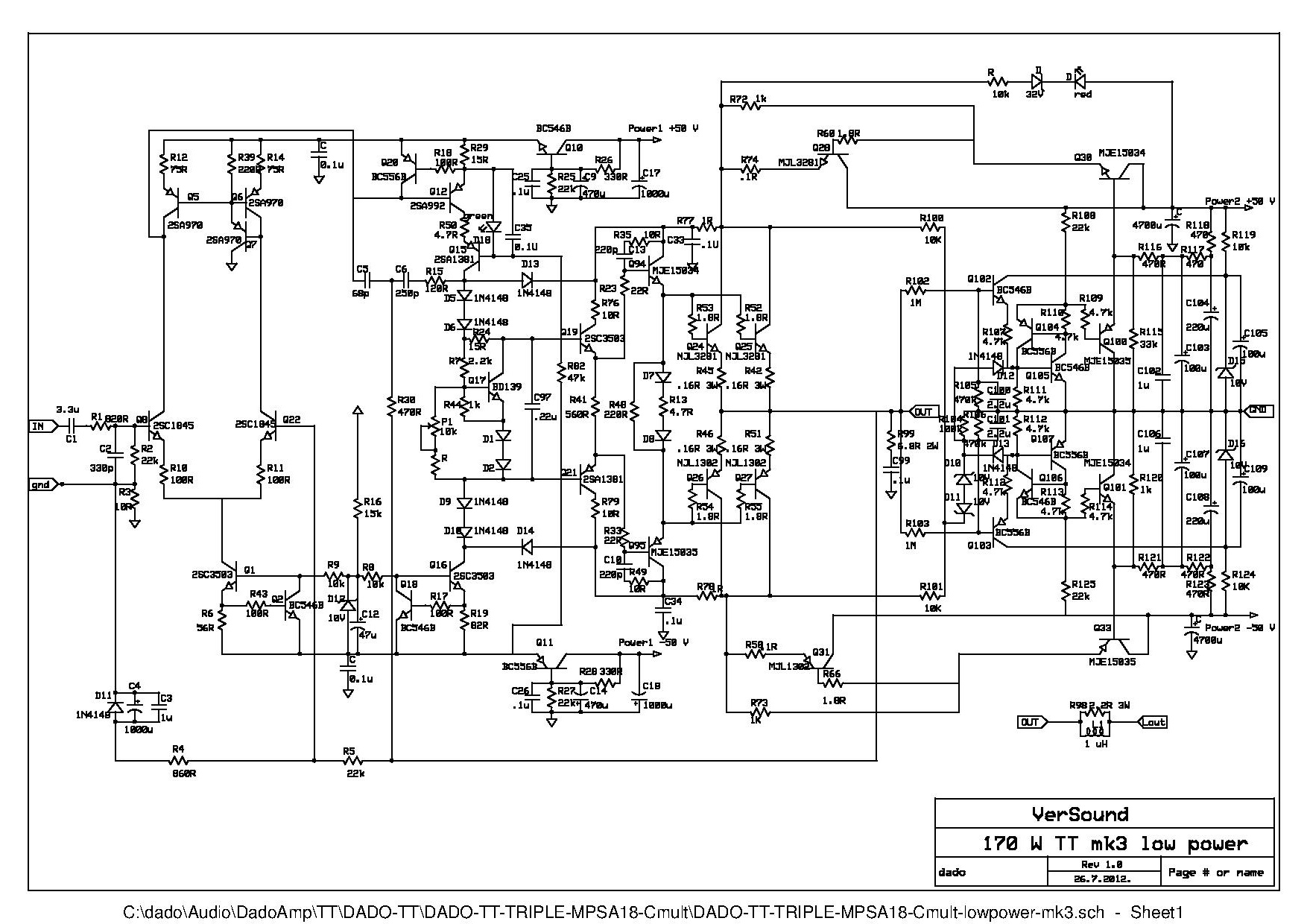

Low Power version
Here is low power version and very good to start with this amplifier.
Challenge, now, it to design good PCB according to discution we had in other thread starting somewere here: http://www.diyaudio.com/forums/solid-state/209658-has-anyone-seen-front-end-before-88.html

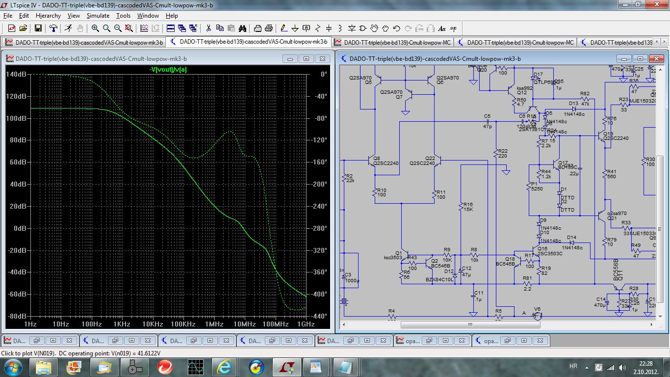

Thanks to catalin http://www.diyaudio.com/forums/solid-state/135122-wonderfull-sziklai-21.html here is a variation on the TCM. What do you think if it could work, simulation is OK? TCM capacitors and resistor could go lower.

Did you have the opportunity to go through more simulations with your last proposal? What is the THD obtained with the new feedback combination?
Any prototype realized?
Moreover, to have an idea of the C-multiplier effect, did you run simulations using rippled power supply or... simulate using a power supply schematic?

I simulated it long time ago, I need a time to find out what I did. If you are very interested I could do more tests for you? I never built that one, but I built AudioCube TT amp(from the same thread). As that one use separate power regulator(C multiplier) the result should be even better as here the C multipliers are close to the amp on the same PCB. Let me know if you are interested and I'll do more simulations

Just been reminded of the title:
200W into 8r0 (+23dBW) and 701W into 2r0 (+28.5dBW).
That is an almighty current capability. Only a loss of 0.54dB with a loading that quarters from reference.

That one was with four output pairs, never made that amp. One guy was interested and started to design the PCB, but then no more news from him.

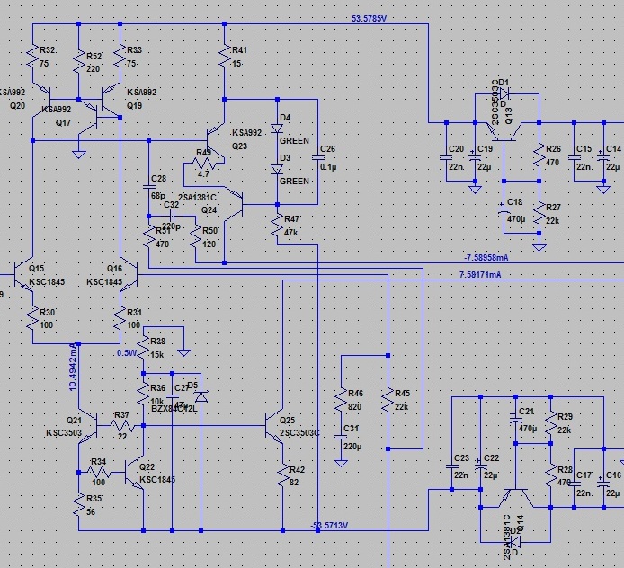

I am not searching for perfection, just following D. Self rule, to make “blameless” amp, but not Self copy.
This amp looks complicated because it integrate cap multipliers, or power regulator on the same PCB, with all needed protection. Most complicated part here is to make good layout and then everything looks simple. One example of the “blameless” principle is how LTP cascode was biased. If you want high power amp and want to use jfet or high beta small transistor(normally low voltage) then you need cascode. Standard way to bias cascode is resistor divider referenced to the ground. Better if it is referenced to the LTP tail, but then the cascode current disturbs the tail current. Small transistors are cheap and way not use one to bootstrap cascode to the LTP tail, and next step to replies lower bias resistor with constant voltage like zener or LED. Next step would be to replace upper resistor with the CCS, but then that is “complicate”. I did that in my first TT amp, but I think that was over the top.

I try to simplified the IPS. I have already draw modular PCB of 3EF OPS like Ostripper. My target is making simple amp to build but high performance. I am not finishing the simulation. May be you can help me.

First I suggest two separate CCS.
