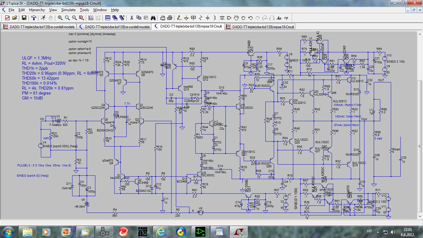

Here is schematic as I used for the simulation.

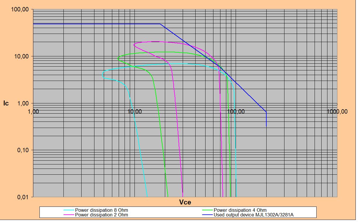

I've done a quick SOAR calculation for 4pairs 1302/3281. I used the 1second SOAR curve from the datasheet
65V output peak:
- 190Wrms / 55° phase angle / 8R
- 300Wrms / 45° phase angle / 4R
- 410Wrms /35° phase anlge /2R
OPS is running at max 50°C
==> 4 pairs is NOT sufficiënt, see picture below
==> 5 pairs is on the edge, I would use 6 pairs.

65 V is the Capacitance multiplier input, then you should drop it to 57 V after C multiplier.
There is Backer clamp too defining max output volatage peak and it is 54 V. I showed power dissipation on C multiplier transistor too(there are 6 pairs actually if you count C multplier power transistors).

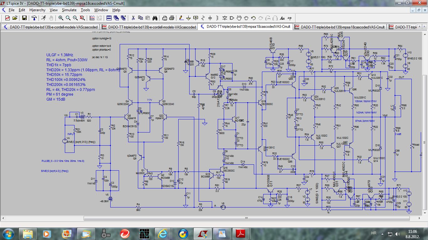

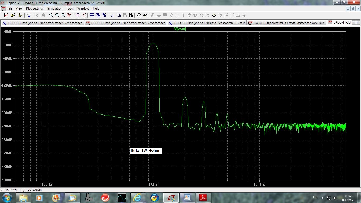

Those are simulated result for a bit different schematic, VAS is now Hawksford enhanced cascode. Some resistors are changed(LTP emitter resistors) and TMC is standard not bridged. Distortion figure are better a bit only(much better at 100kHz) but the stability is much better. I used beta enhanced VAS in first schematic because I implemented in my working TT amp http://www.diyaudio.com/forums/solid-state/182554-thermaltrak-tmc-amp-5.html#post2856550 and it works really good. I tried to use before Hawksford enhanced cascoded VAS but it simulated the same as beta enhanced VAS and it needs some headroom to work. Now I use higher voltage in input stage then in OPS, so some voltage lose is no problem.
Included schematic, 1kHz FFT and Loop Gain screen shots.

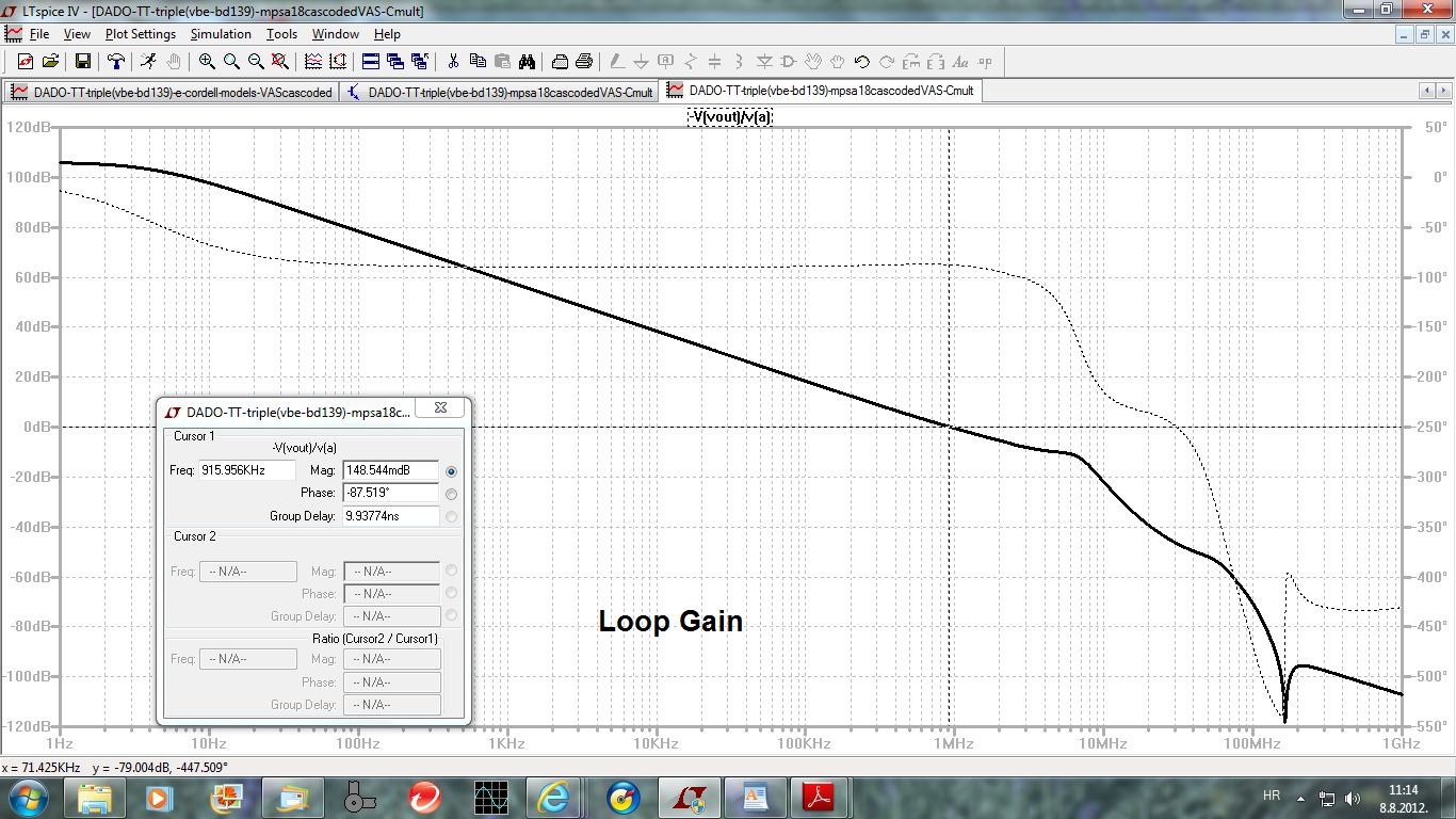

Hi D,
The loop gain plots show PM @ 87°.
Yet you quote PM=61° in your post.
Why does this difference in values occur?
The plots show (in my very ill informed view) that the 0db cross could be pushed out to ~ 2MHz and still maintain good phase margin. Would it be possible to investigate this in your simulation?
R81 located between Q18 & Q16 seems odd.

Phase Margin is difference between 180 degree and the phase shift showen, means 180-87.5= 92.5degree.
I forgot to remove R81, left from some test.
Here is the schematic.
dado

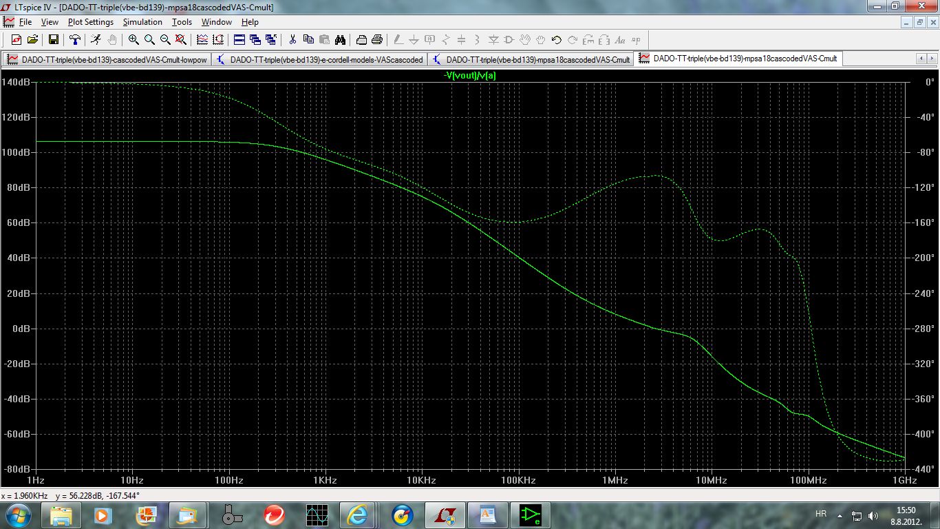

Here is low power version.
ULGF = 1MHz
RL = 8ohm, Pout=95W
THD1k = 1.09ppm
THD20k = 1.74ppm
THD50k = 16.15ppm
THD100k =0.014506%
THD200k =0.114467%
RL = 4k, THD20k = 0.77ppm
PM = 90 degree
GM = 15dB
It is quite simple, specialy if capacitance multipliers for OPS were removed and powered with +-45 V instead.
