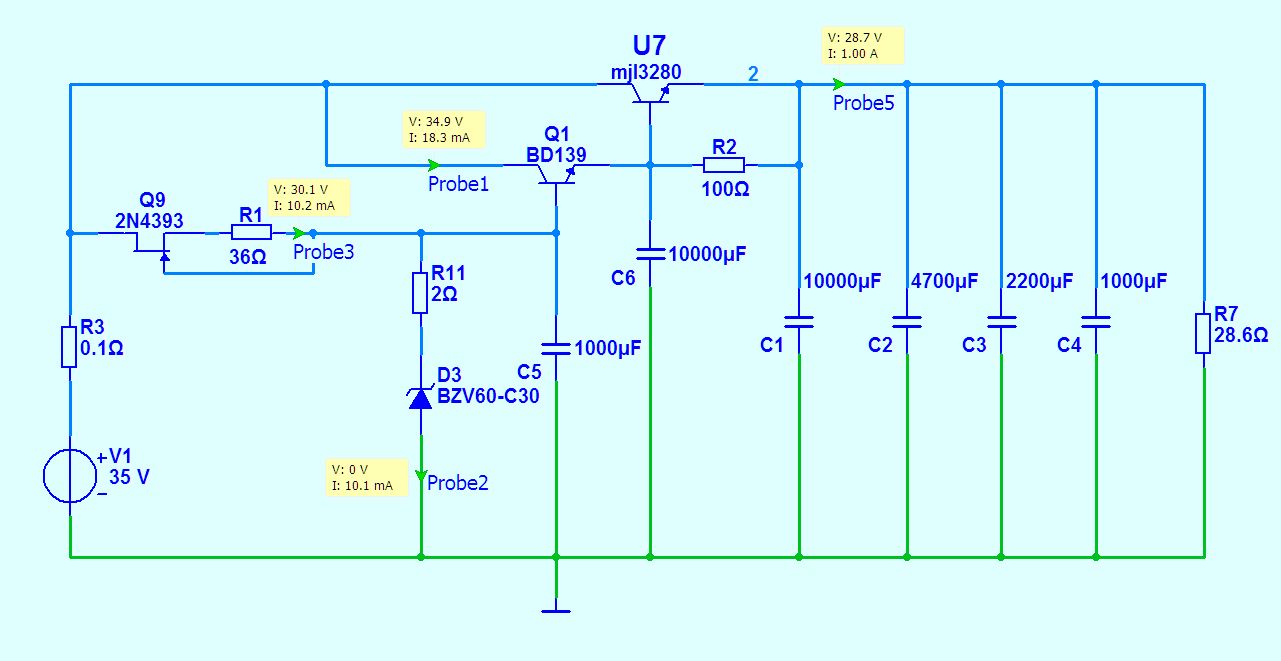

Yes. Jut an emitter follower. As the V on the emitter is supposed to follow the one on the base, if you have a single cap there, it is a so called "cap mutiplier", but if you regulate the tension here, you have a stabilized PSU. Zeners product some noise, you can improve this part, and use Darlingtons to increase ß.of the power transistor.Mike, Esperado's with TL431 and zeners you linked is just a series regulator not a multiplier or some combo..
There is a reason why i made this choice, instead of a full regulated PSU. I noticed that those kind of PSU sound better (more relaxed) for power stages than the ones with Feedback loop inside. And they are simpler.
Why ? I suppose that two different servos in serial (The one in the PSU and the one in the FB AMP) interact between each other.

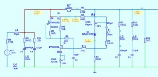

Its a nice & simple to make regulated power amp PSU the one you use. Uses feedback of course, its at the chip's ref lead. The 1mF capacitors you tie from ref adj resistors add some AC feedback too beyond filtering the combo Vref noise and its good because it augments its effectiveness by several dB. The fact that its already applied and passes your subjective tests also, makes it a standard solution for anybody who would like to evaluate his SSA or TSSA regulated.

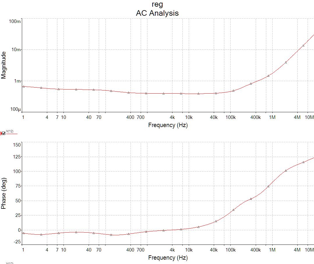

Our spice methods are slightly different. To test line & load regulation I add a 1V AC source at input and later at output and spice gives me a graphs with -xdb.
I'm not so familiar with LT spice are you adding noise to line & load simultaneously to check regulation or is your method different ?
I think a Jfet with a higher idss & resistor might give a higher impedance but perhaps in this case this is not necessary.
AC1 on the pics means AC small signal analysis is activated with value of 1. The source ripple and load play values I add are showing to compare in-out when transient analysis is the mode.
That JFET gives 3-4mA average IDSS in GR selection. I put it here for two reasons. Low Vgs(off) gives more tolerance for lower Vin-Vout, has enough transconductance. Many Jfets could be applied. That config it was about Jap parts I have in hand, nothing as ''best combination''. The TO-220 driver Q2 has the grunt, and some housekeeping as Sonny reminded regarding base resistors etc. will be necessary when you will build it to test its stability and subjectivity with any adequate semis you have easier access to.

From a theoretic viewpoint in spice this is the regulator with the best performance with regards to o/p Z, speed & stability but I will use sockets etc on the prototype so I can test an all BJT version as well.
I think with this HF performance this offers I can make do with much smaller chokes upstream perhaps 10 - 50uH will surfice - or maybe I will not need any at all !
