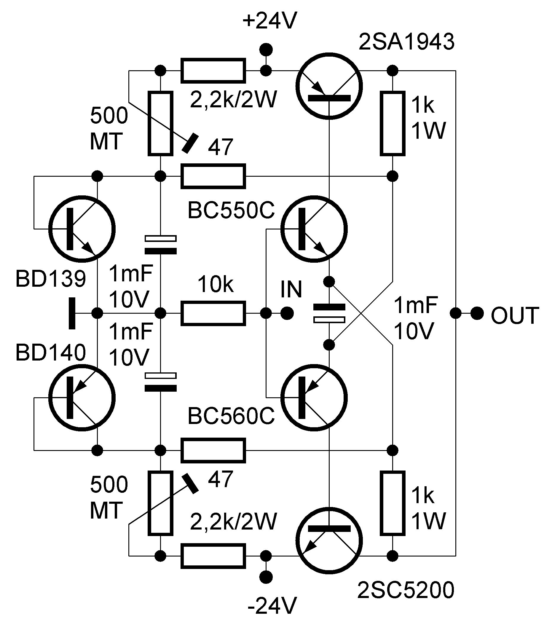

I finished my little TSSA BJT amp. There are so few parts I probably could of done it P to P but I've been trying to get better at laying out and making pcb'. It sounds pretty good. I'm using 2SC5200/2SA1943 output trans. My power supply is pretty standard, unregulated, 20,000uF per rail, 200va transformer.

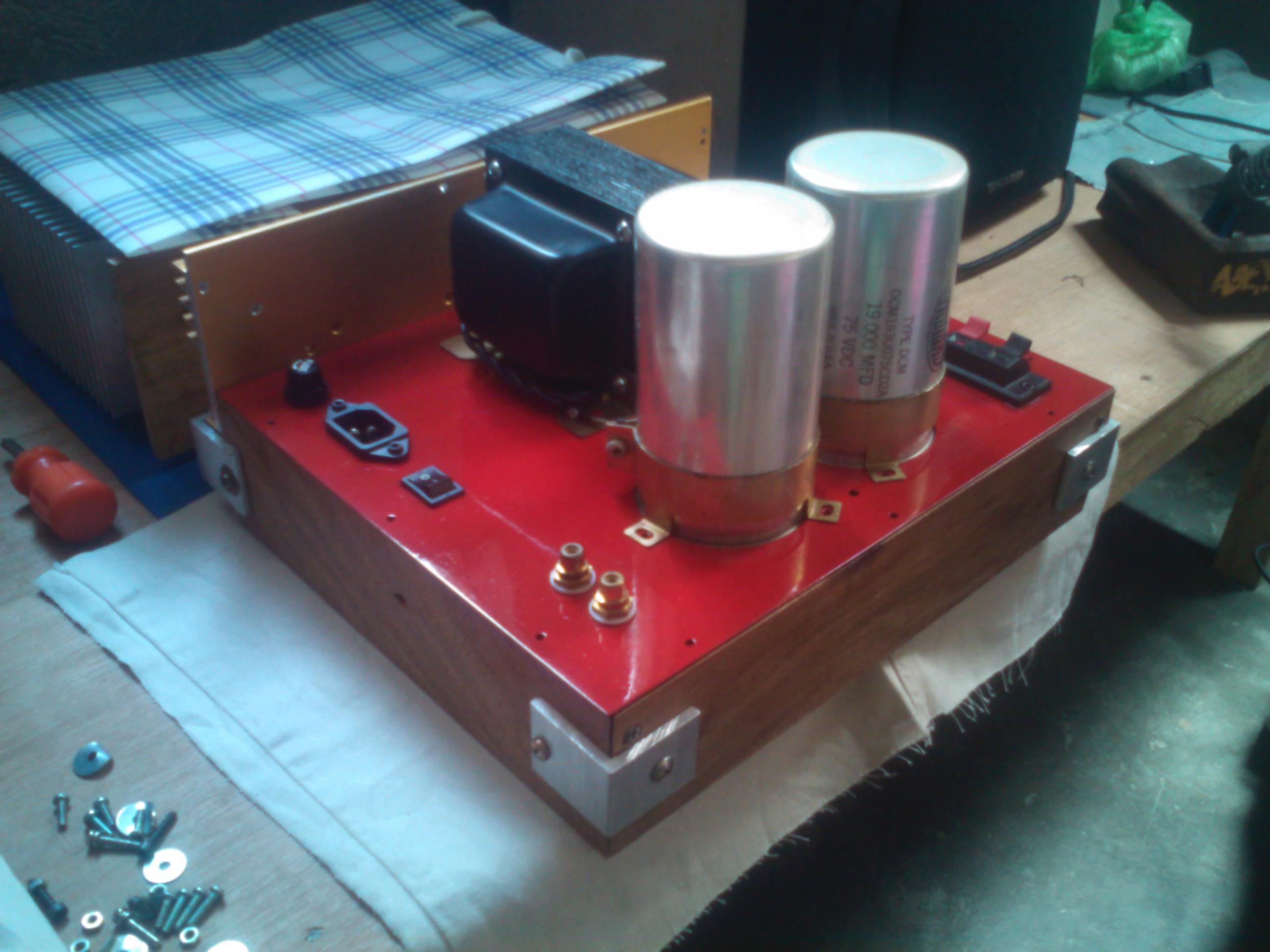

Will this amp also handle a little over +-40vdc rail? I'd like to try it-out P2P and house it on this Tube like chassis that I built out of recycled materials. I could replace the BC550C/560C with the higher power BC556B/546B. Any other values that needs adjusting?
Many Thanks!

I'm hoping someone more knowledgeable will jump in here. I'm just not sure. I think the purpose of that circuit schematic was to show how simple the TSSA can be but would probably need some support parts to beef it up with higher rails and bigger wattage. Good luck.
The basic circuit relies on high class A current. So to perform just decent it should operate at atleast 2A idle ... So rising the voltage to 40v means a lot of heat. Also the arrangement with collector into base of the output device with no basis to emitter Resistor to turn the power transistors fast off would mean slow turn of as soon as it leaves class A.
My tssa v2 to V8 is a lot more complex to keep it all running as you already had figured out. But Then it is possible to run it In class AB without sacrisfying Performance
