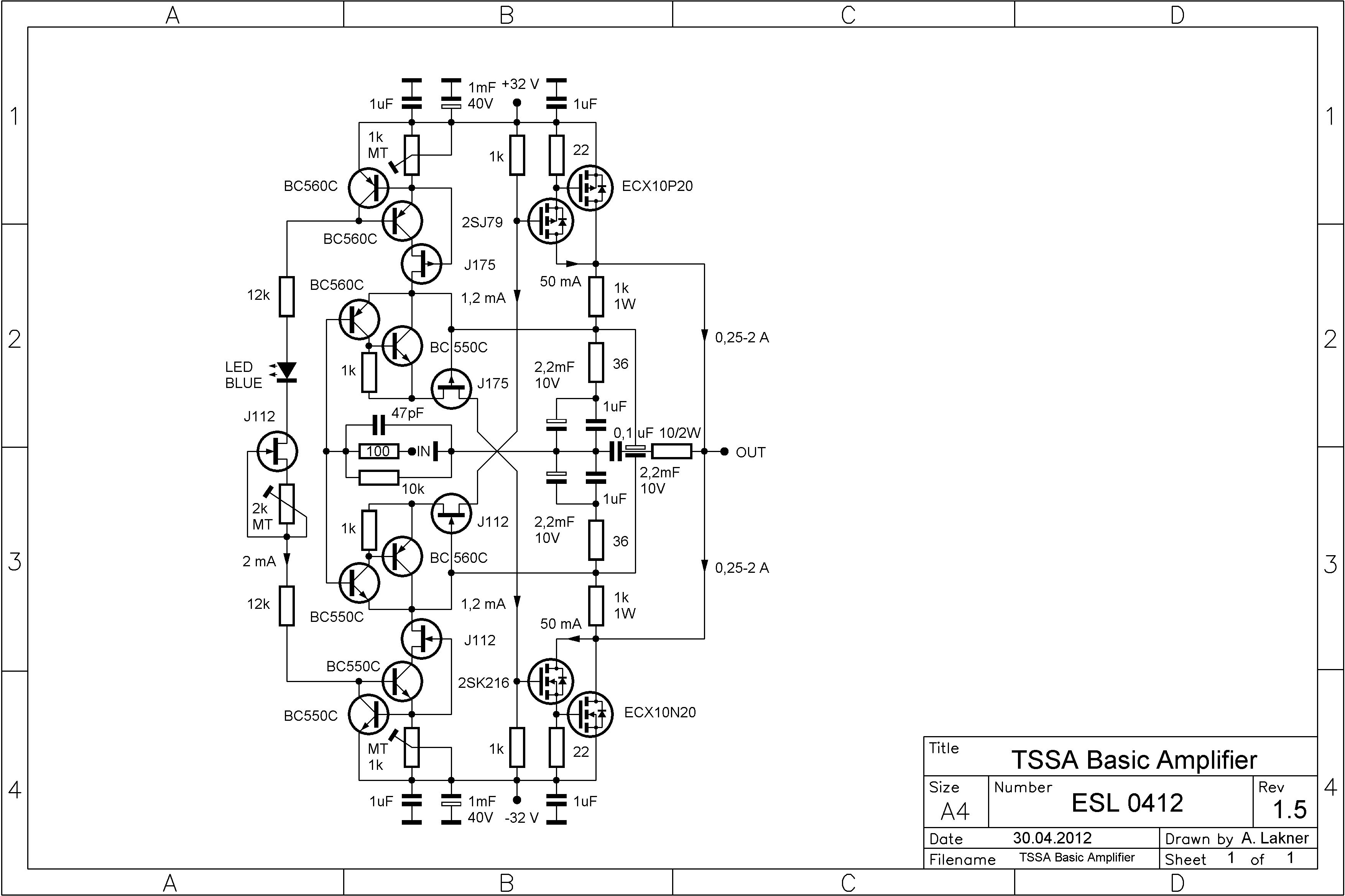

I think it will sound better with driver, 50 mA driver's bias, pure class A, 22 ohm gate-source of the output device, real impedance drive only. Total input stage isolation from the output current, can't do better than this in a simple manner. 😎

in simulation the driver does not improve distortion or distortion profile...more current seems better..It's a tricky beast and small changes means a lot...Think it needs a lot of IRL tweaking to get things right.

MiiB, on the other hand even the simple version of post 1 just enhanched with depletion mosfet CCS sounds very, very good. It may more the energy storage we hear and not so much the distortion provided we have no high order or bad sounding intermodulation.

This amp already feels like an old friend to me. I am totally convinced that using the output laterals as current fed back current sources is the way to go. High feedback emitter or source followers have problems to drive a complex load. See the measurements in the new Stereoplay.

TSSA Basic 1.5 - Update
Hi guys
Gerhard and Sonnya (and others if any interested) please look at change in schematic. 2200 uF/10 V capacitor added to feedback bridge (from TSSA BIGBT HP and SSA experiences) for extra distortions reduction. This elco decouple middle bridge DC from any AC being present because of unsymmetry, secondly it will cause our amp to raise bias slowly from firing-up, some sort of soft starting. Since this is symmetrical design we don't want anything to spoil our little symmetrical toy.
