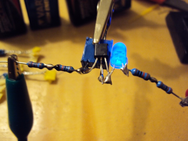

I will use BF246A to supply the Led.
OK this one is from 30-80 mA, so may be that 2 k trimmer could not reach enough Ugs to go down to 2 mA. Than add serial resistor to set Id=2 mA
Ideally would be LED current equal Sziklai current, that means both CCS BJTs same current, same Ube characteristic, electricaly plus thermally (coupled together) makes CCS very stable. 😎
P.S. BF246A Uds should be around 10 V for good regulation and AC suppression, if Rgs drops too much to get 2 mA, than lower 12 k to 10 k or less just to maintain Uds=10 Vmin 🙂
It works without problem. 1,3mA in both channels right away.

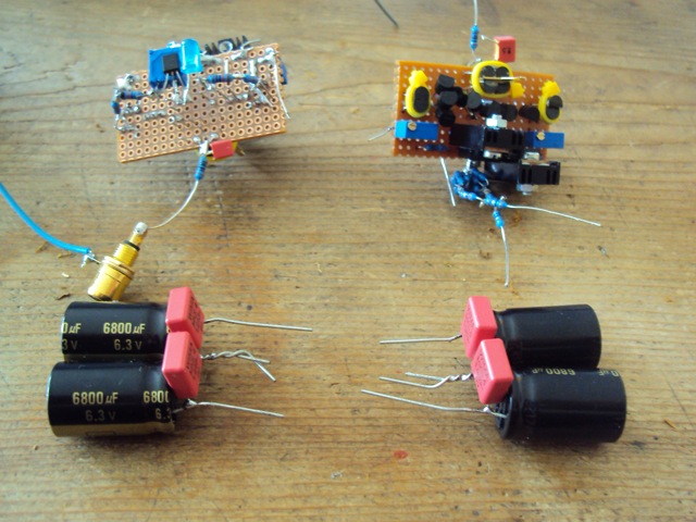

Hi Sonnya :wave:
SMT parts are perfect choice here, since there are a lot small signal BJTs connected between themselves only. Try to make as compact PCB as possible.
There are few suppliers that can provide 2SJ79/2SK216. These are lateral mosfets (transconductance falls with higher temperature) so no problem with thermal runaway, also have integrated gate protection zeners - perfect drivers. Try to find these not IRFs. 😉
