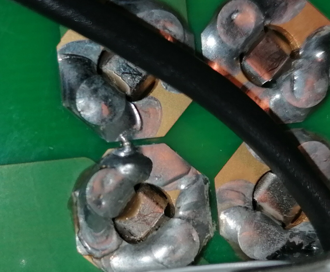

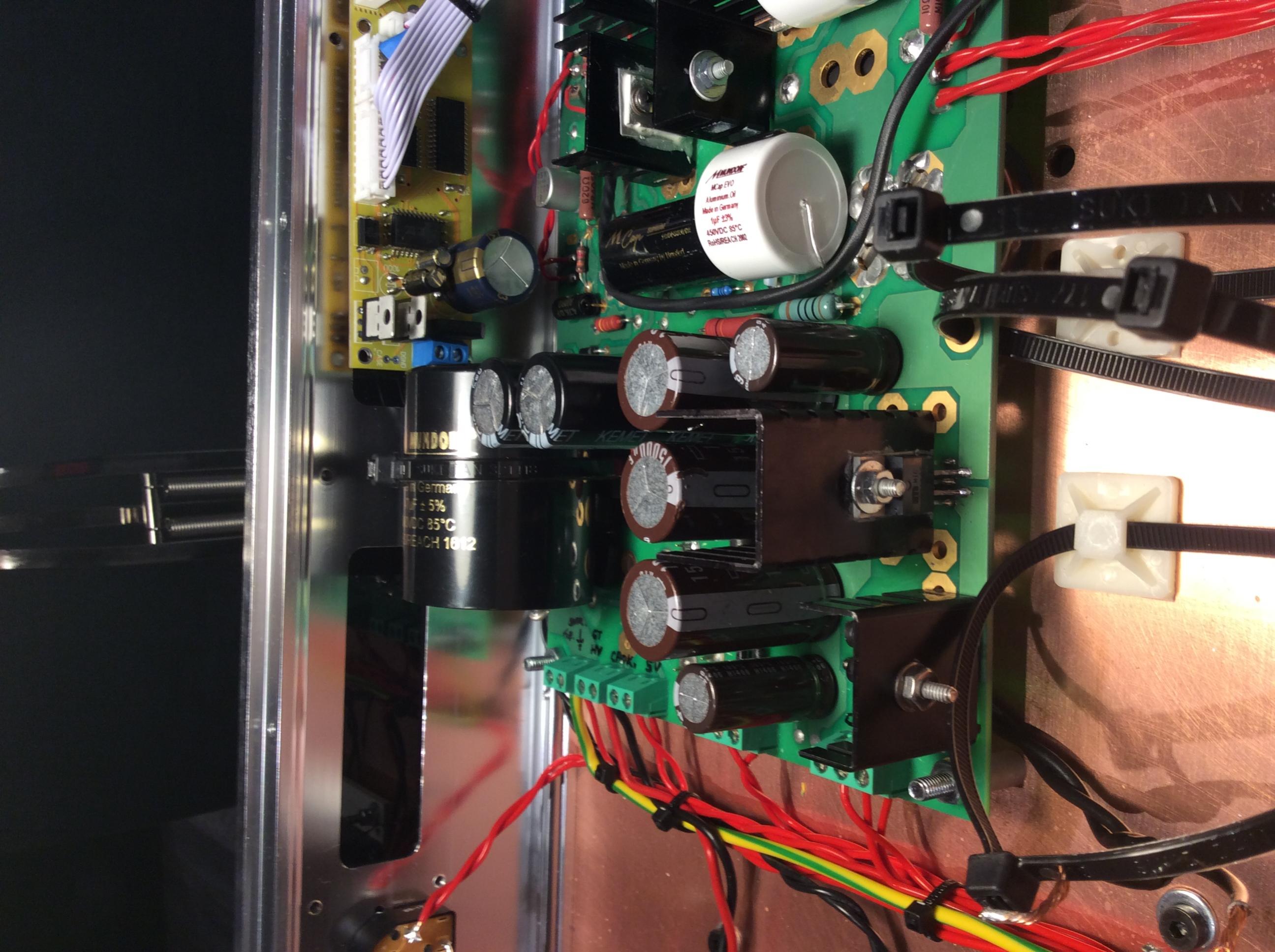

Please help me to find the problem on my TSE II board (300B tubes)
- T1-GRN1 - T1-GRN2 - measuring 6,3VAC - OK
- jumper from 3-4 - OK
- R2=300R - OK
- R1=100R - OK
- IC3 orientation/soldered - OK
- D1 orientation/soldered - OK
- D5/D4 orientation/soldered - OK
- heater voltage on both 5842 sockets = 7,6VDC - OK
- heater voltage on 300B = 0 ( zerro) !!!
- MIC29502WT - input voltage on PIN2 = 7,6VDC - OK
- MIC29502WT - output voltage on PIN4 = 0 (zerro)
- changing MIC2902WT - still same problem !
- no smoke or anything suspicius, regulator temperature moderate
- HV = OK
I'm really lost here....
BR,
Goran
still nothing...I have resolder all points around regulator and still no voltage on output pin.....on input pin is 7,6vdc...😕

I don't see any obvious build errors.
The first thing I would do is to measure the resistance across the filament pins with no tubes installed. I get 400 ohms on my board in either direction after the readings settle. The pins are rather close to each other and it would be easy to create a short.
Hello Friends,
Look this nice solder bridge bettwen pins...😕😡
It made me almost nuts:bigeyes:
Now is all ok ...5v on 300b heaters...
Huhhh...I will post finished amp on gallery soon...
Thank you all...
Goran
