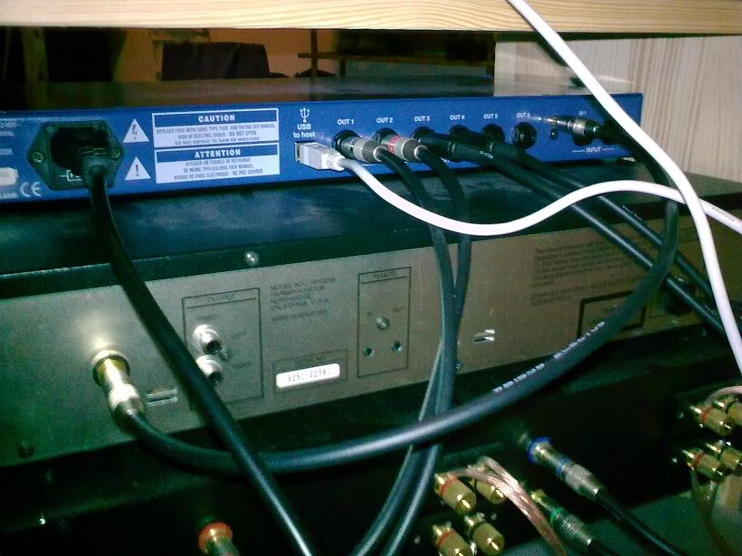

A quick update on this ongoing project.
I was lucky enough to find the schematics of my old CD player which originally doesn't have a digital output.
Even luckier: there's a version of the same model that has a digital output
So it turned out to be easy enough to add a SPDIF output to the player and plug it to the processor.
![dig.jpg dig.jpg](https://www.diyaudio.com/community/data/attachments/227/227004-7f3e9d8ad474a7715a95579328a1209d.jpg)
