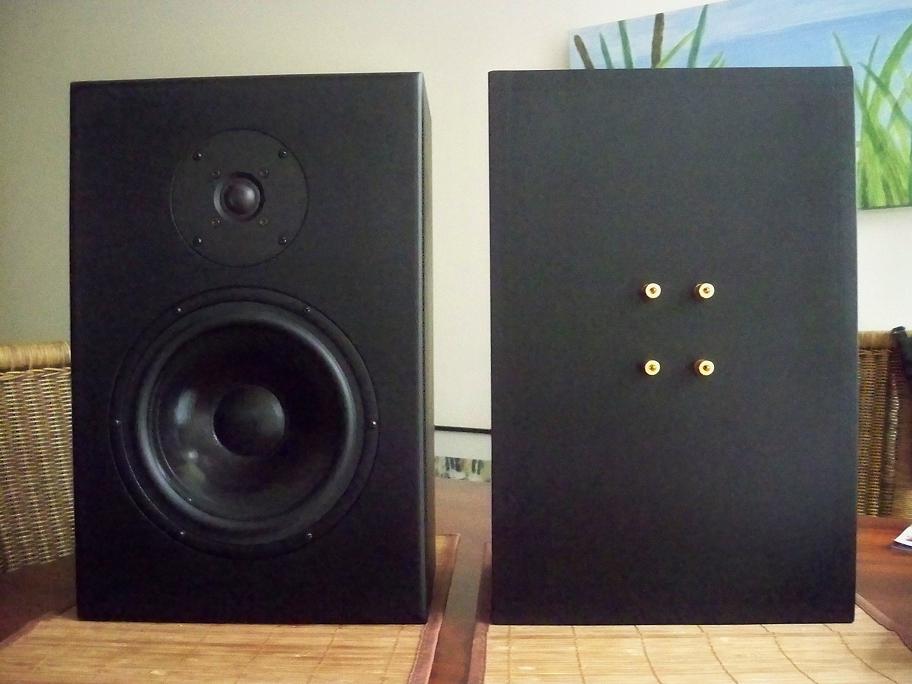

Your doing well chapark I think my speaker project took about 7 years from when I first started seriously thinking about it to when it was semi finished (no it still isn't finished!!)
Before I read Moondogs post I immediately thought of coventry fasteners for the speaker screws. That's where I got my button head allen screws. They look nice and shouldn't cause any nasty diffraction effects.

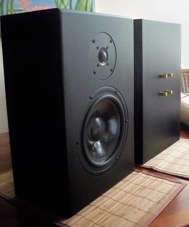

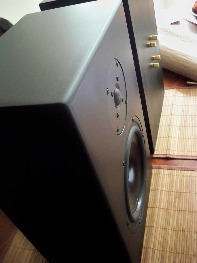

For now i'll stick to these ugly screws that i have. They were cheap and they do their job. In the future, if it happens that the sound coming out of these speakers is acceptable, i'll probably paint them and change the screws for better looking ones. Coventry Fasteners have an online catalog and it seems they're quite expensive for imperial screws...
@ Wintermute: i had a look at your speakers, they look really good! Hey instead of trying to glue hex nuts to the back of your panel, check out the hurricane nuts at PE, i confirm they work really well.

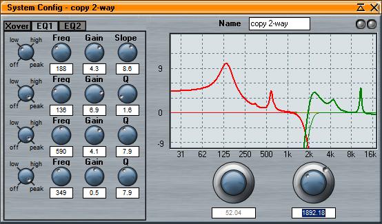

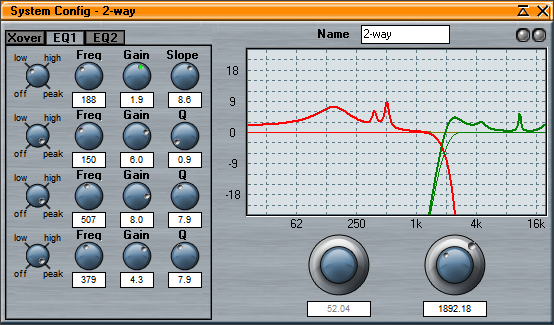

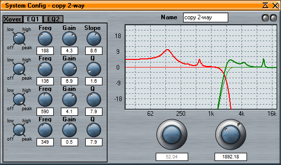

@ Speaker dave: i'm using a processor which is not intended for this application but offers basic filtering see orfeusz206 at WAF - Wroclaw Audio Force. I already own a measurement microphone, i'll post a few graphs some day

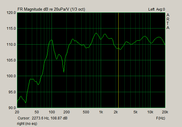

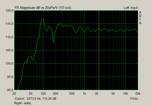

So i've used part of this rainy saturday to quickly hook up a measurement microphone and look at the frequency response as a start.
So far the xover and eq has been set by ear and it's still a FIR (169 coefficients with splitting frequency around 1800 Hz), slightly below Eton's recommendations for their tweeter (2000 or 2500Hz depending on the version of the product specs). There's also a slight shelving filter IIR with 3dB gain for the bass with fc at 180 Hz, and the tweeter is attenuated by 2dB.
So here are the plots:
Microphone was not compensated for but is relatively flat according to the calibration file from the manufacturer (+/- 1dB). Measurements were taken in the living room and include room effect as well as everyday's life noise...
Thanks! I think I'll have to get some of those hurricane nuts for my next project! what size thread are they? M5?? They look much better than T-Nuts that I had contemplated.
Those measurements look very good to me if they include room effect! My in room measurements have been shocking! I think my main issue is that the listening position is against the wall.

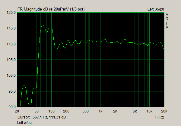

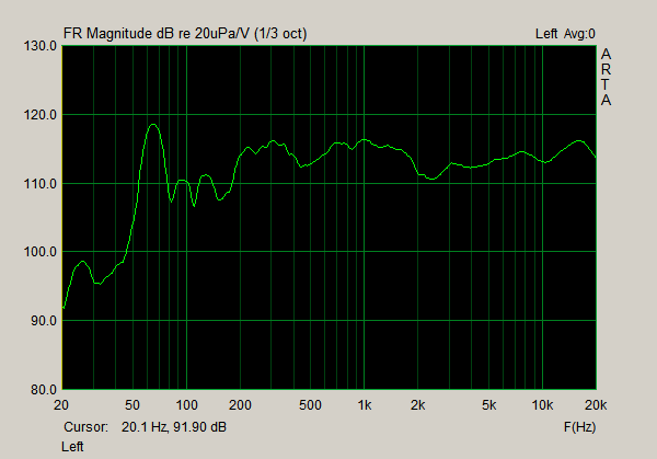

Ok I'm back with some stuff.
So here's the right loudspeaker response:
After following tweaking (i've slightly moved the split freq):
The response at same location is looking like that:
Same punishment for left channel:
And the result:
Looks quite OK, but one would need to have a listening session with it.
That's what i'm currently doing, with Freedie Hubbard 'Hub-Tones'

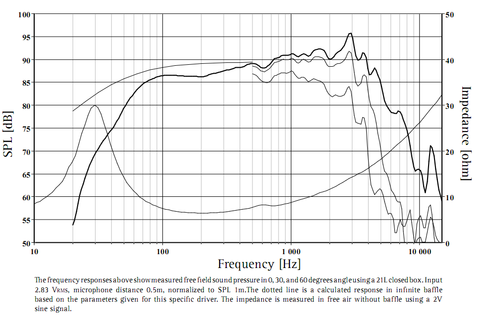

Well, regarding the bass response i'm going to start with a LT transformation. According to the manufacturer, the woofer has plenty of excursion - 12 mm peak to peak linear travel and 26 mm max before destruction so it might be a good candidate for such a tweak.
Here's the frequency response of the manufacturer:

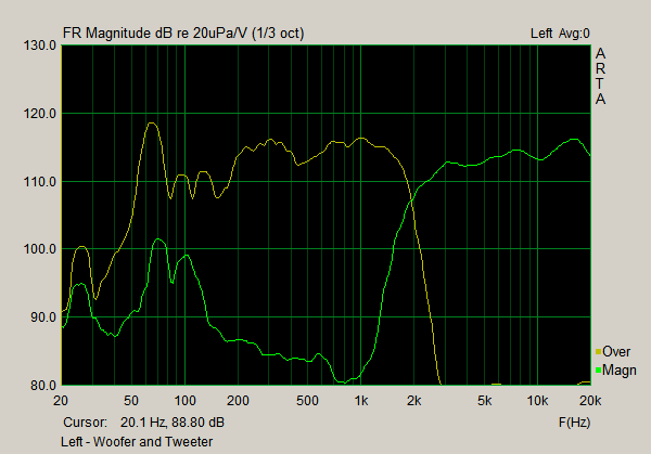

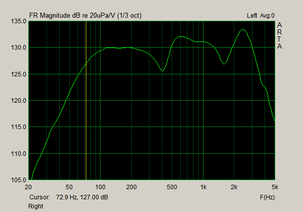

I made today quick nearfield measurements and here's what i'm getting:
Both channels are pretty similar but i don't really understand the dips at 400 Hz and 1800 Hz? Any idea? Other than that F3 is around 72/74 Hz.

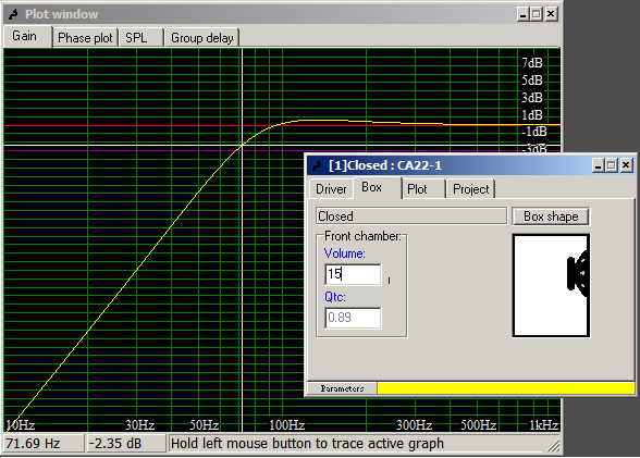

The internal volume of the enclosure is about 17 litres, which somehow confirms that manufacturer's TS data are not accurate and that the 2 sets of TS parameters mentioned in the beginning of the thread are closer to the real thing.
17 litres yields a Qtc of about 0.9 as confirmed by a quick simulation in WinISD:

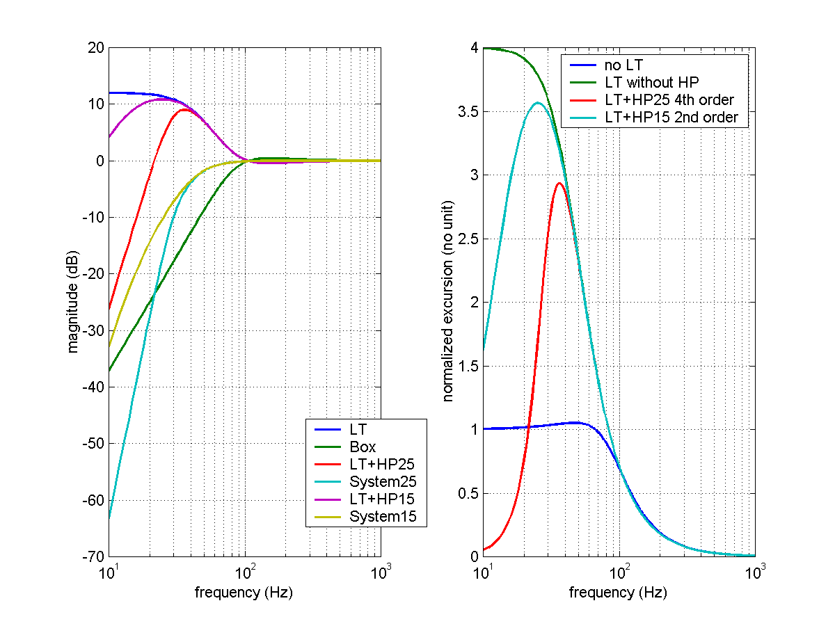

I'm now tackling the excursion problem. I understood that excursion vs frequency is the mirror of the frequency response for a closed box. This is all relative however: i'm missing the link between the normalized excursion curve (i.e. with excursion = 1 or 0dB at fc) and the real excursion in mm according to dissipated power? Any help appreciated!!!
So here's the LT i have in mind so far (with added LT + High Pass combination):
the LT applies ~ 12dB of boost. Adding the filter results in a boost peak ~11dB @ 25Hz.
This will almost double the excursion of any 25Hz signal.
Your 6mm Xmax is effectively equivalent to 3mm Xmax.

The higher dip might be the crossover frequency that's at the wrong frequency... The lower dip, I don't know...
But if this was very-near field, then the height of the microphone would have a huge impact.
This is due to the nature of n/f testing and is normal.
The usable range is limited by the diameter of the driver.

Plots show the measurement of the woofer alone in the box, i.e. tweeter and crossover both disconnected.The higher dip might be the crossover frequency that's at the wrong frequency... The lower dip, I don't know...
I placed the microphone at woofer axis elevation, capsule about 1 cm away from the dust cap.
Is there a rule of thumb for having a rough idea of how far the nearfield measurement is a good image of the farfield one?This is due to the nature of n/f testing and is normal.

Here's an other simulation with some insight on excursion requirements. It shows the effect of 2 high-pass filters: one as above (2nd order BW cornering at 15 Hz) and the other 4th order BW cornering at 25 Hz.
Right-hand plot shows relative excursion where unity is the excursion at low frequency for the unequalized loudspeaker.
What i need now is to take into account the signal power in order to derive similar curves with absolute excursion (in mm). Don't know how to do that, but i'll find.

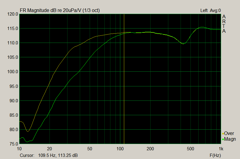

Anyway i've made a test of a LT lowering f3 from about 72 downto 40 Hz and simulating a maximally flat box loading. There's a 2nd order Butterworth HP cornering at 25 Hz to help protecting the driver.
It actually sounds rather nice. I'll probably experiment with some other combinations of Qt/f3.
