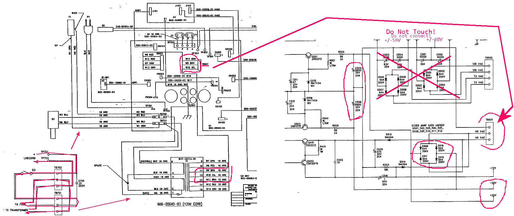

....The PSU - too much voltage for a chip amp - max is generally 25Vac for 8-ohm speakers......
Disagree, maybe.
I never understood Carver's "Magnetic Field" designs. Apparently some had a "regulator" ahead of the power transformer.
But looking at the manual cited by 00940, this *appears* to be a conventional supply, albeit with three +/- rails 25V 56V 98V for a 3-level class "G" amplifier.

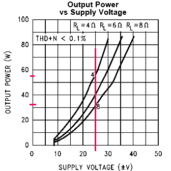

The +/-25V rails (which power the most-of-the-time part of the 350 Watts, to maybe 50 Watts) have two 6800uFd caps, ample (and upgradable).
If he takes just the +/-25V taps to an amp, that's maybe 28 Watts in 8 Ohms or 50 Watts in 4 Ohms. That can be a lot of good music.
It is "stupid" to have a 700+ Watt transformer sitting around to give only 100 Watts. But it isn't doing much else, isn't heavy enough to anchor a rowboat, and is already IN the house (not shipped from Canada or China).
The question is: can he find the indicated points, tap them, and not get shocked or burn down the house. Minor point: can heatsinks cut for individual transistors accept the wide chip-amp package.

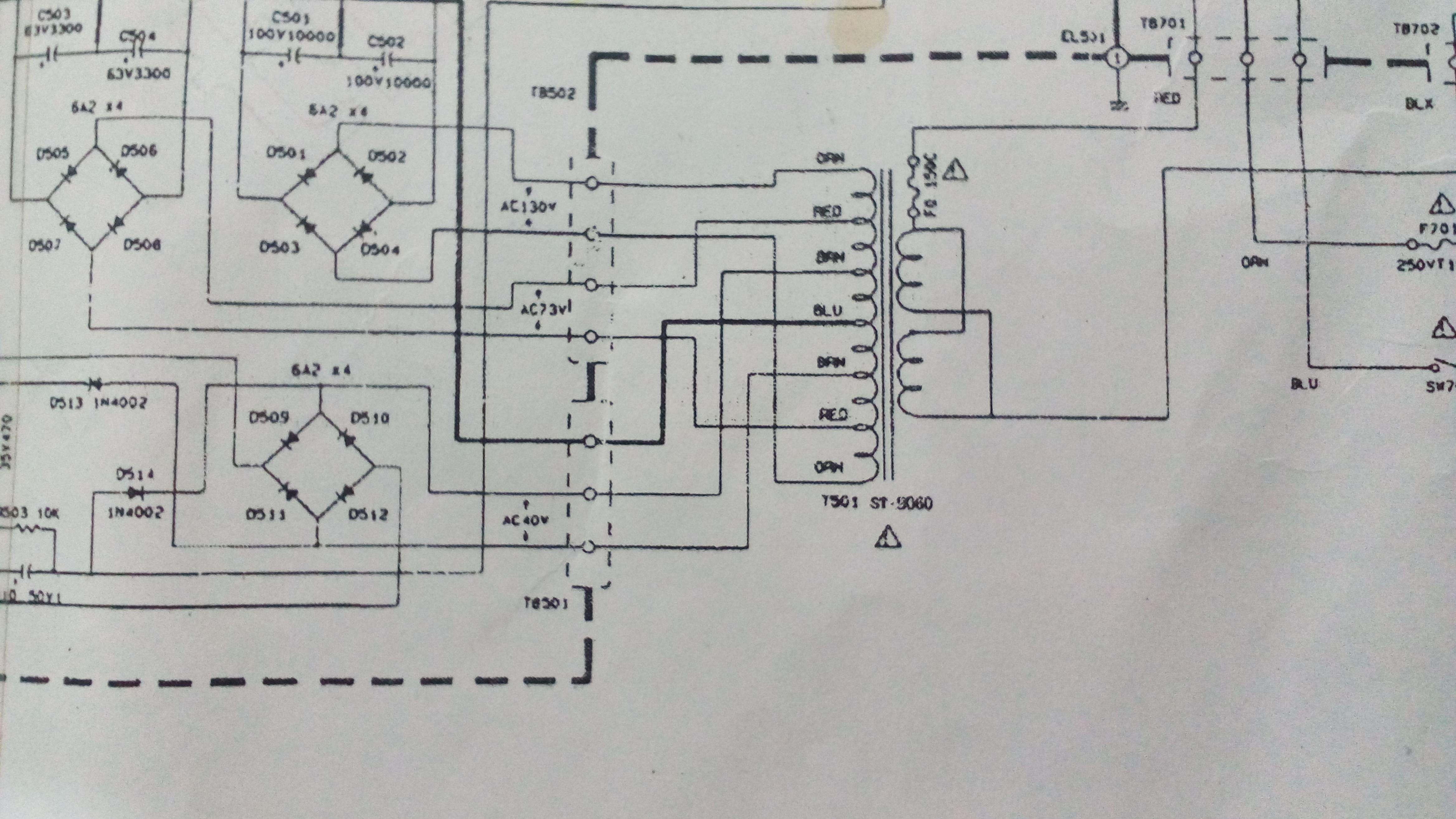

You're perfectly right, I didn't realize that the voltages on the transformers were in fact 65-36-20-0-20-36-65.

PRR, thanks for the observation. I was looking at a printed schematics I have (see below) and took note of the ACV on the transformer which are wrong as they refer to the voltage between the transformer outputs. And BTW although it's called "Magnetic field..." the TFM isn't one. (lucky for me)

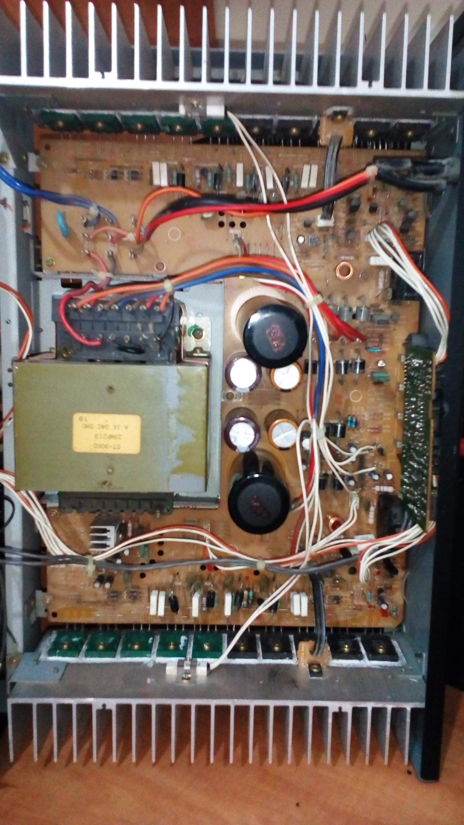

Looking at the pictures from 00940 ,the TFM 35 is different than the 35X, I have attached a photo of mine. So I think voltages don't match either. I need to check.

From your pictures, the voltages match. That's one thing.
The rest of the amplifier looks very similar but with different parts. Too bad you don't have the big blue caps, they would have made things easier.
I think this part is all the same. The schematic snip cuts-off the two 5000-10000uFd caps for the +/-25VDC rails, but they gotta be there. It appears the 0VAC wire changed from yellow to blue. Connector numbers look un-changed? And those large flat heatsinks are begging for big devices.

For sure, repair the Carver. It's a really nice amplifier that can be made to sound better. This is a really nice amplifier and sometimes it is well worth having an expert repair something. Maybe once you have more money to allow for this.
I owned the Canadian warranty service shop for Carver and found them to be very reliable normally. Done right, you will appreciate an expert's work on this amplifier.
So, what happened when the amplifier failed, and what have you done in the past with it? The circuit boards are critical, so no matter what do not damage the PCB. There are some new parts that work fine in these amplifiers. So it is anything but a lost cause!
